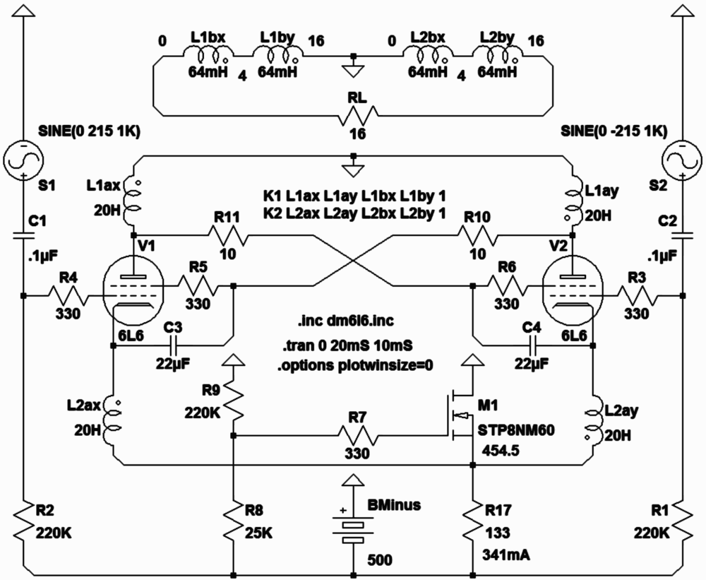

OK, here be da Venus flyaround as requested... No functional difference from the 1st schematic, other than restoring isolation to the secondary.
Hopefully I have made clear which segments are organized as bilfilar pairs.
Total primary windings and H have not changed. This is still the same 5K transformer, sort of...

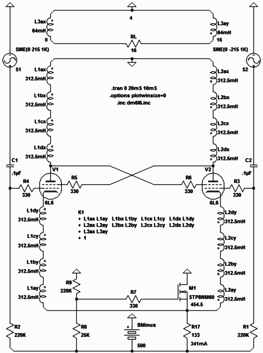

McIntosh default winding would effectively have paired L1ax with L1dy. L1ax is nearly GND. L1dy swings V1's cathode. This is no local balance...
Even so, I'm not complaining it wasn't good enough. Only that one can do better. And in so doing better than prior art, old patent is no barrier. Now somebody wind me one... Edcor???
(L2dx L2dy) (L1cx L1cy) (L2bx L2by) (L1ax L1ay)
Secondary (L2ax L2ay) (L1bx L1by) (L2cx L2cy) (L1dx L1dy)
Butt secondary against the least active segments AC voltagewize... Usual reason to distribute secondary may not apply here (or does it?) All primary segments are equally active AC currentwise...
If we cheat a little, and swap (L1cx L1cy) for (L2bx L2by) in the layer order? Would L1 and L2 DC resistance totals come out closer to equal?

Mac pairs the bifilars as:
L1ax,L2ay
L1bx,L2by
L1cx,L2cy
L1dx,L2dy
L2ax,L1ay
L2bx,L1by
L2cx,L1cy
L2dx,L1dy
So that there is no AC difference between bifilar pairs, only a DC difference.
Actually, not much need to bifilar them anyway, just use the cross coupled caps like the Twin used. Mac put the cross caps in on their later ones too. (cap from V1 cathode to V2 plate, and a cap from V1 plate to V2 cathode)
"stop hallucinating!"
"And why for?"
I was just kidding. But how else could they do the bifilar pairing without causing horrific distributed capacitance problems? The whole problem they were trying to solve was the handover between tubes in Class B. By pairing AC compatible windings between the tubes, they effectively have each tube connected to all the primary windings. So no winding gets isolated in a sudden tube shut-off state. Always one tube in control to avoid inductive kickback spikes (winding leakage L).

You brought up using a pair of 25W OPT do a 50W job? Is this what you meant?
  • WhatIf3.asc.txt
Yes, except be carefull how you connect up the secondaries. Two 4 Ohm windings in series or two 16 Ohm windings in parallel will give 8 Ohm output. Parallel would be the better choice, I would think, to insure equal signals on each xfmr., but maybe not that important (just determines plate versus cathode 50%). Main issue is that both tubes see the same load Rl, winding Rw, and leakage Ls, which is determined by the balance across the xfmrs internally (which should average out even if not perfect internally as long as both xfmrs are identical).
You could probably get rid of those 10 Ohm resistors if you make the inductor coupling something like 0.99 instead of 1.0.
Equal ampere turns guarantees equal magnetic field. What does equal voltage guarantee?
Also remember we must reflect 2.5K to the primaries, if the total across both transformers is to be 5K. So bridged load is still: 16 at the 16 taps, 8 at the 8 taps, 4 at the 4 taps. I should have flipped all the dots on L1 to place the secondary tap locations correctly.
Ideally, not much difference between the series or parallel secondaries that I can see (assuming the Zs are worked out correctly). But practically, if the core material in one xfmr draws a little more magnetizing current than the other (in the series secondary case), then the CFB % would be varying. Not good.
Umm, on the bridged secondaries. The way I see it, for the series bridged case, each secondary sees half the load Z (virtual ground at center of load). For the Parallel bridged case, each secondary sees twice the load Z (half the load current driven by each). Then figure back thru the xfmrs and add their one sided Zpri's (being in series) for equivalent tube loading.
You need two 2.5 K P-P OTs with 16 Ohm secondaries to get 8 Ohm out and a 5 K P-P equivalent primary by my reckoning method. Right?
I've been puzzled by the Edcor CXPP25-8-2.5K model that someone must have custom requested once. Unless they wanted a 4 Ohm output. Maybe wasn't for a Twin, but some low Rp regulator tube. Or an Elliptron would get it up to 5K and 8 Out.
