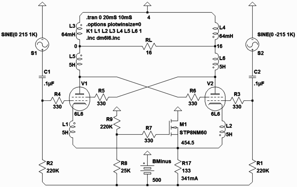

OK, I get it. What's your plan to drive this?
Mac solved the drive voltage problem by adding a third winding (trifilar might work) to bootstrap the driver. It seems to me that some amount of driver bootstrapping would reduce the outstage feedback and increase output impedance.
M1 could be supplied by a small 80V supply stacked on B- and then a single TO247 would do the job. But it's really just a NLD isn't it? i.e. a cathode voltage shunt regulator. It's a lossy fixed bias method. Nice way to do it though. A pot wiper on M1 gate allows idle current adjustment. Some balance adjustment is still needed, so how is it better than fixed bias except not needing another power supply?
So the screen current cancels in the OPT due to the coupling of L1 to L6 and L2 to L5. It still shows up on the secondary, right? Albeit in a relatively small amount...
Also, my experiments with trying to detect zero crossing as a bias control method suggest that tailcurrent minima, grid AC zero crossing, and idle point are not exactly one in the same, even when tracking a simple sine wave.

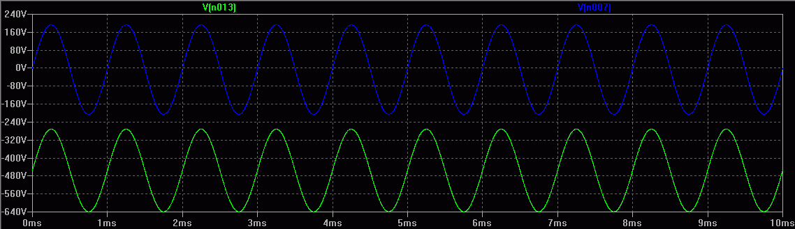

OK, here be da Venus flyaround as requested... No functional difference from the 1st schematic, other than restoring isolation to the secondary.
Hopefully I have made clear which segments are organized as bilfilar pairs.
Total primary windings and H have not changed. This is still the same 5K transformer, sort of...
McIntosh default winding would effectively have paired L1ax with L1dy. L1ax is nearly GND. L1dy swings V1's cathode. This is no local balance...
Even so, I'm not complaining it wasn't good enough. Only that one can do better. And in so doing better than prior art, old patent is no barrier. Now somebody wind me one... Edcor???
(L2dx L2dy) (L1cx L1cy) (L2bx L2by) (L1ax L1ay)
Secondary (L2ax L2ay) (L1bx L1by) (L2cx L2cy) (L1dx L1dy)
Butt secondary against the least active segments AC voltagewize... Usual reason to distribute secondary may not apply here (or does it?) All primary segments are equally active AC currentwise...
If we cheat a little, and swap (L1cx L1cy) for (L2bx L2by) in the layer order? Would L1 and L2 DC resistance totals come out closer to equal?

Mac pairs the bifilars as:
L1ax,L2ay
L1bx,L2by
L1cx,L2cy
L1dx,L2dy
L2ax,L1ay
L2bx,L1by
L2cx,L1cy
L2dx,L1dy
So that there is no AC difference between bifilar pairs, only a DC difference.

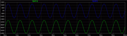

Nice one Smo-king! Crossed 22uF caps do seem to help. Though put 10ohm in series keep LTSpice from freaking.
Capacitance can look like resistance when laddered with L. Characteristic impedance of a transmission line, etc etc... There is no distributed anything when bifilars fully balance. Thats whyfore transmission line transformer, AKA balun. Or so ye olde hallucinatory theorem goes...
Capacitance of my variant should be horrible (at the ends anyway)! But lets not forget how a ladder network works. Its not going to behave that way, or so ye olde...
Yeah yeah, theoretically we terminate both ends at character Z. But the whole thing is far less than 1/4 wave at any audio, so does it matter small difference 5K plate to plate transforms to at the rail end of the line? And the loudspeaker load will steal away most of the wave before it can reflect anyhow? We hope.
