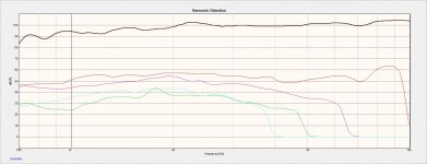

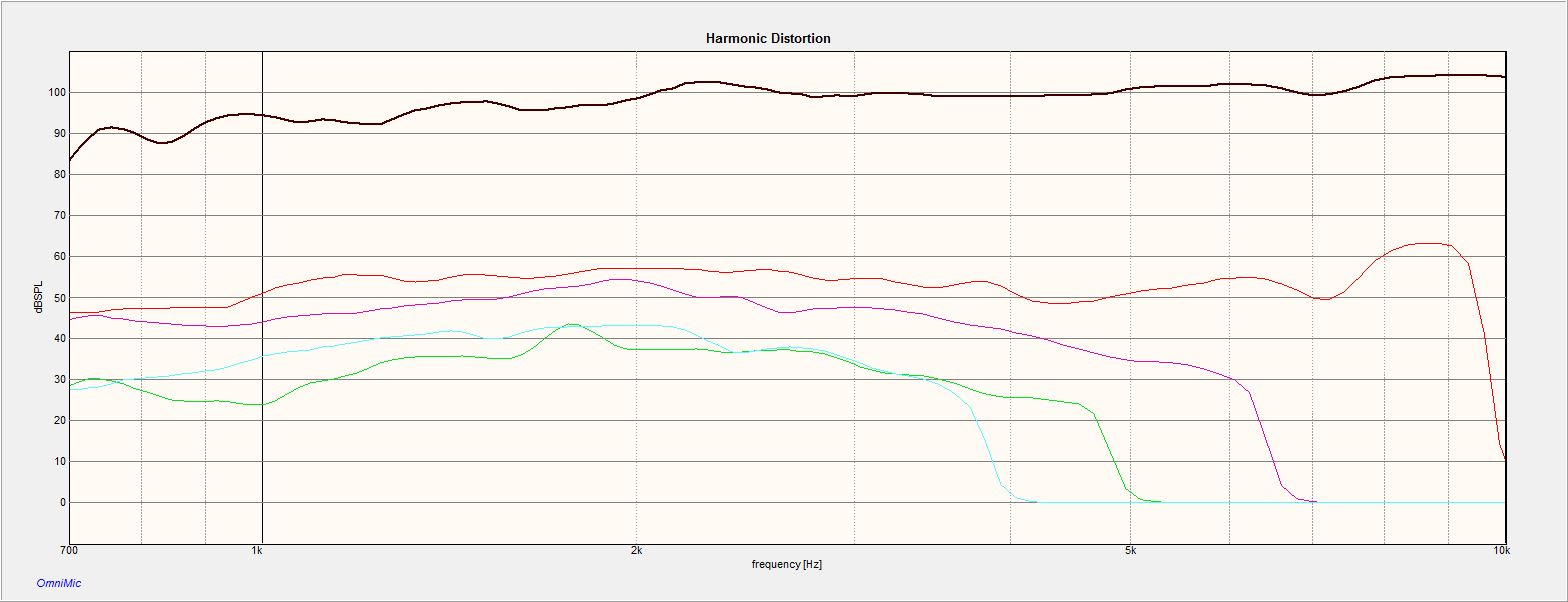

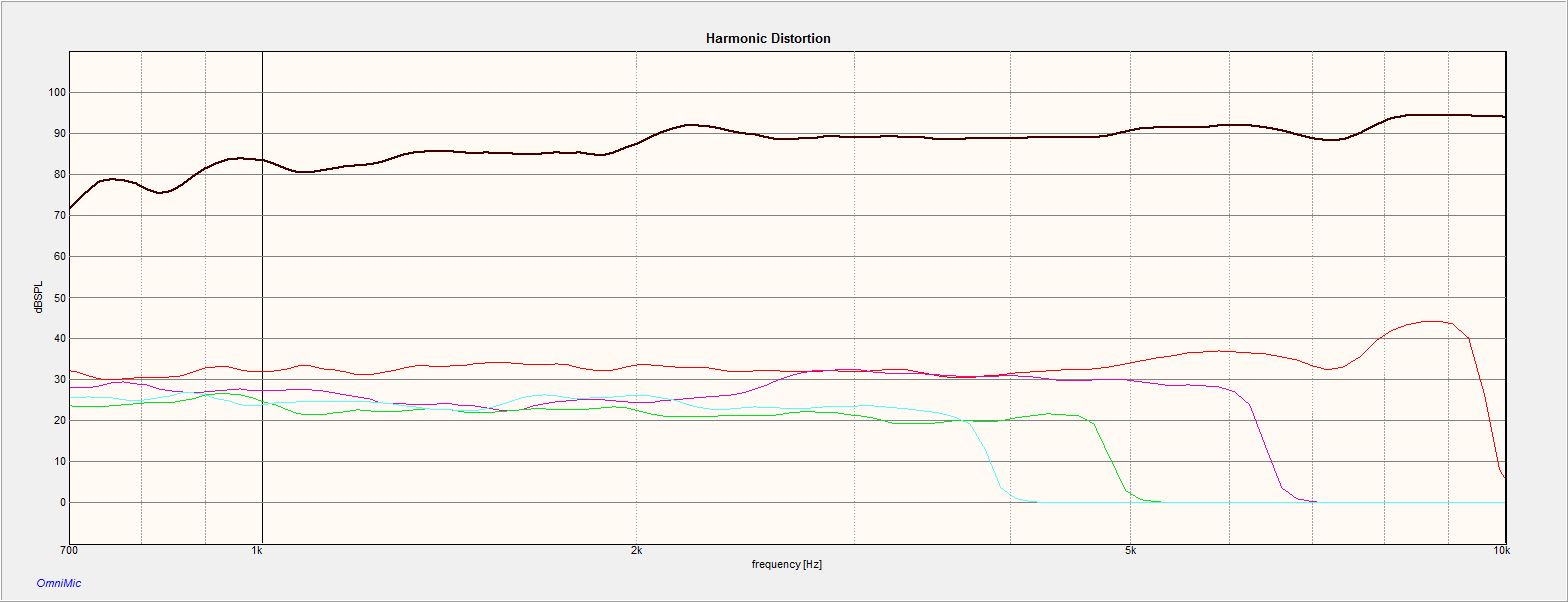

prototype 75mm long by 15mm wide free swinging ribbon with 2nd order filter at 1 Khz. 1 meter at 90 db and 100 db.

Thanks Ernie A lot of sweat went into that one! There is data at 105 but not sure I can get it off my old laptop. Distortion was above 1% but cannot remember exactly
