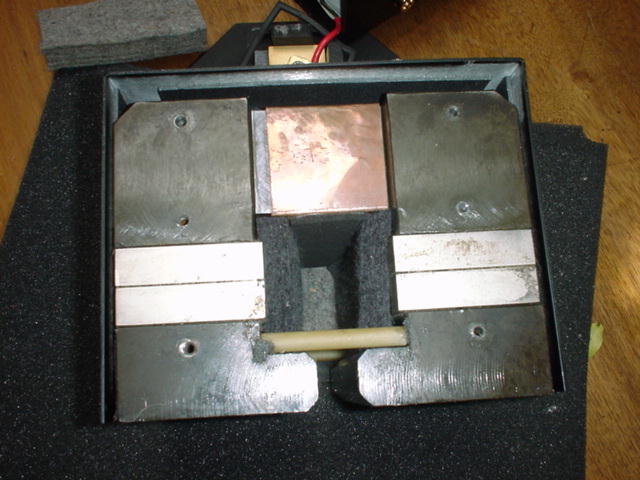

Tenson said:Excellent. Do you happen to know if the transformer can be taken off the back of the RAAL? I want to get it not do deep.
The 5th page of the pdf provides an exploded view of the driver - just looking at this I'd say that its unlikely - and even if you could the steel case would still be there (..and its needed to increase field strength for the magnets). (i.e. the transformer is "tucked" into the magnet assembly - so there would be no dimensional "savings".)
Hmm, a pity. Just so people know, I am pretty sure the transformer can be taken off the back of the Fountek NeoPro5i. You are left with the metal enclosure which is a lot slimmer.

Hi snkby,
Many monopole ribbons use a closed back magnetic circuit to increase the gap flux. Dampening material in these cavities is very important for low distortion.
Dipole ribbons can have a very open back, but it is still worth experimenting with diffraction control on both front and back pole pieces, as well as trying thin cloth tape on large areas of rear exposed magnets or iron.
