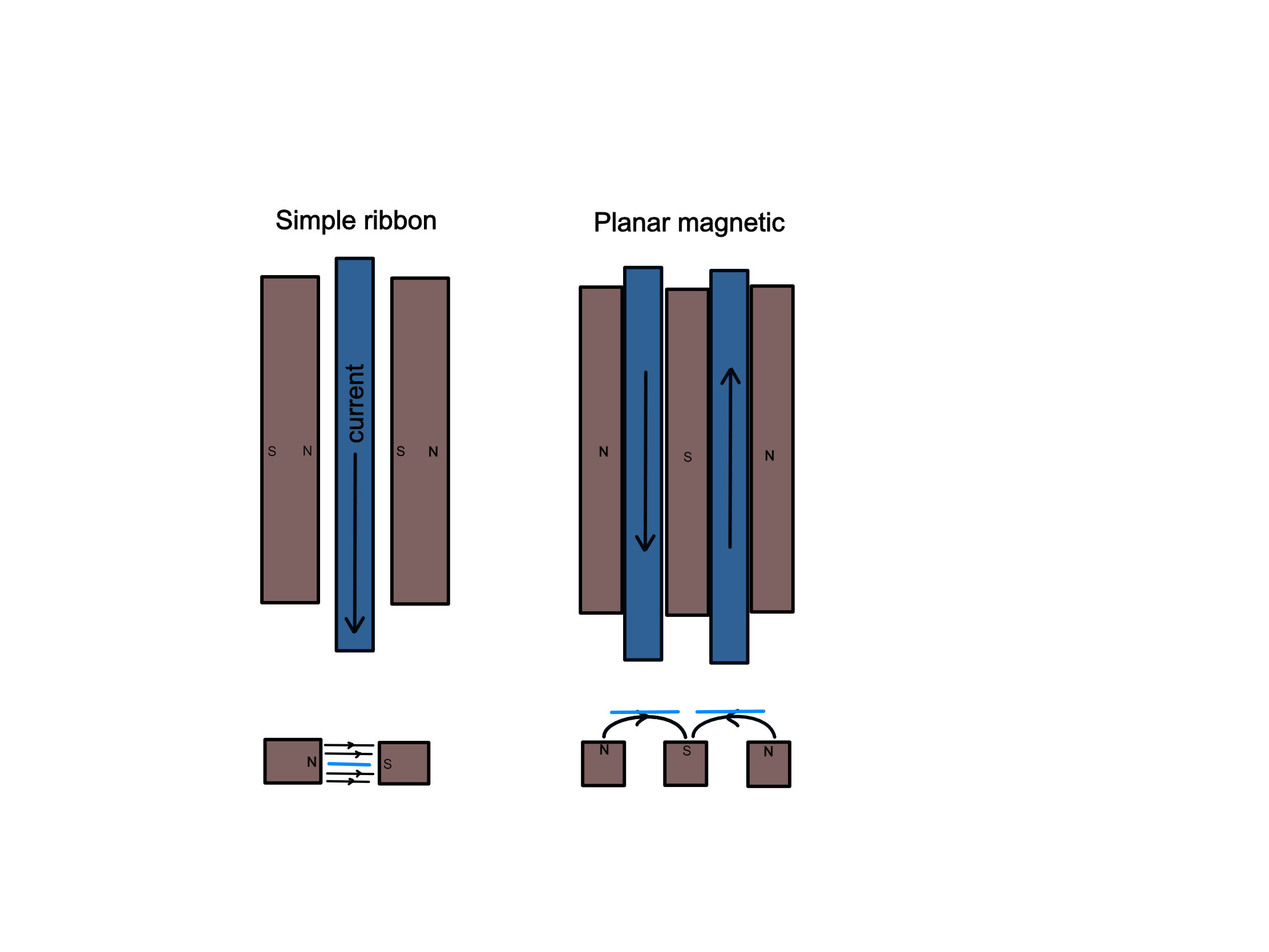

Wait, if the force upon a current carrying conductor is orthogonal to the direction of the current and the magnetic field then a true ribbon in push pull configuration with a solid plane of N on one side and a solid plane of N on the other side would create the drive force required right? Or do I have that totally wrong? If so then there must be a way to configure the magnets to work.
the basic problem with magnets is how fast the force falls off with distance. With a ribbon that has a lot of surface area ( needed to do bass) in a short length, that means a very weak AND uneven magnet force across the ribbons width.

I don't understand, the only difference between a typical planar and my proposed method is that the current through the diaphragm flows in a different direction.
Why does this mean I can't use many rows of magnets at any width I want?
What I mean't is that I could mount the ribbon either at each end or on all 4 sides like a planar and then mount the magnets like you would on a planar in a different magnetic configuration to a normal planar so the ribbon moves as the current flows from one end to the other.

Im unclear as to your proposed configuration but I suspect what you may be thinking will move to planer surface sideways rather than for and aft

The more I think about it the more I don't think I understand what is mean't by the "orthogonal" force applied by the magnets, I need a better visual demonstration, but there should be a magnetic configuration that will make it work.
As far as keeping the direction of magnetic field and current flow equivalent to a typical planar I think making the magnetic field cross through the ribbon from front to back would make it functional....I think?

I think part of the confusion may arise because the orientations of magnets in planar magnetic drivers is a bit counterintuitive. Simple ribbons are easier to visualize. I threw together a really quick sketch to see if it helps: ribbon on the left, planar magnetic on the right. The upper pair of sketches show the front view, the bottom pair show the end view. Blue indicates the conductors. Black lines indicate magnetic field lines.
The trick is that you need to identify three mutually perpendicular directions. If the current in the conductor travels along x, and the magnetic field lines are parallel to y, the conductor feels a force along z.
The planar magnetic sketch shows a single-sided arrangement. You’d need a similar set of magnets, but mirror-imaged, on the other side of the conductors to create a push-pull arrangement. The field lines would still be along roughly the same directions where the conductors sit, but “compressed” a bit by the opposing magnets.

In the nonexistent ideal world, yes. Unfortunately, the straight lines in my sketch are an oversimplification. They bend more and more as you move away from the line connecting the midpoints of the magnets. If the magnets are far apart, this becomes more problematic. If the ribbon is 1/4” wide then you’re probably set. If it’s 1” wide then the field felt by the diaphragm will not be uniform. Some parts will feel more force than others, and pistonic motion is out the window.

So it seems that the only way to do what I want to do while being able to go "wide" is to build an array of ribbons that are very close to each other.
Seems doable though, Neo magnets can be ultra thin, like a couple of mm. Stacking them for height while maintaining thinness might be an issue though.

We wish that one worked but it doesn't work well. I have built a number of protos of that arraignment, even a curved array of large 2 inch wide ribbons. It was 24 inches wide by 40 inches tall. Also similar in 1 inch and 1/2 inch wide ribbons. They were OK for treble ( actually not all that great for that eather) but bass and midrange is soft and weak. Far too many issues with loss of dynamics from standing wave cancelation issues AND the gap between ribbon edges and magnet faces.
The simple planers ive built, even the ones with magnets spread out waayyy too far were superior to the "ribbon array". Way better dynamics.

If the ribbons are thin enough then standing waves cannot exist right?, and a magnet that is a few mm wide will not have destructive interference.
a magnet a few mm wide will have no field strength even a little ways away. and standing waves in a long thin structure are going to happen at lower frequencys no matter how thin
so the thinner magnets will dictate a less wide ribbon so now your into a larger number of air gaps between ribbon edges and magnet creating even more loss of low freq pressure.
the theory is solid but years ago I forged ahead on just such designs and found out the hard way that it doesn't work
