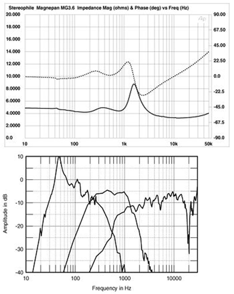

No this doesnt work. A bit complex for me to put in words
BTW I would not try to make it a push pull with magnets on each side. So long as you are listening at very close range as I assume is the idea here? , the diaphragm doesnt have to move much and push pull not necessary( so long as the diaphragm is big)
Besides a push pull will have forces to deal with in building that will be a very serious issue
Likley your biggest problem will be control of diaphragm below about 300 hz. Standing waves down there can kill any bass response in a planer. Magie uses "dots" Apogee uses corrugations , both use diferential tunning and resistance to air flow through magnets etc.
In your case you are close to speaker and likley not as concerned with this issue as you dont need a strong bass rise at resonance to offset the falling response of a dipole. some felt on back side can tame an damp thigs enough to get around the tricky bizz of tuning a planer to do big bass. Just adjust the amount of felt to get a flat response at your ears. And of course if u use a sub then it gets even easyer

Only in that it has more resistance to air flow. You can get same by adding felt to single sided design.Actually best to use a tight weave "screen" and attach firmly to magnet structure. Perfectly solid and unmovable is ideal but no such thing but its close enough.
If look at commercial planer woofer you see only about 12% open area! This controls bass resonance and quiets down standing waves a bit between 100-400 hz
Planers have a whimpy motor, not good like a coil in strong magnet gap like cone, so planers need air flow resistance when diaphragm is tension ed to a high Q resonance
The best sounding bass I heard from a planer was one with NO tension. It sounded like a well damped sealed box woofer without the box color, BUT now you have super low sensativity thats basically unusable. It needs to be a very big diaphragm to work well.
push pull has magnetic flux lines that are more flat across the flat foil traces on diaphragm , SO they have lower distortion
However if you spread your magnets out about 2-3 times as far as typical designs AND put diaphragm really close to magnets, then the flux lines of a single sided magnet design are good enough. This of course will be lower sensitivity and lower peak volume capability BUT if your sitting only a foot or two away as I assume you will be then thats ok

The force on the diaphragm scales with the B*L product, where B is the magnetic flux density, and L is the length of the conductor immersed in the magnetic field and carrying the music signal. The number of windings matters only to the extent that it affects L and the driver’s impedance (which determines how much current it draws and how happy your amplifier will be).
I found that by selecting thin aluminum, adjusting the width of traces, and running the traces through the magnetic field multiple times, I could get the impedance up to an acceptable level (4 - 8 ohms) without resorting to a transformer. I also increased L and therefore the sensitivity.
As Bolserst pointed out, the physics behind a planar magnetic driver is different than that of an ESL. The electric field between large parallel ESL stators is constant, and therefore generates a constant driving force (assuming the charge on the diaphragm isn’t allowed to move). It is widely assumed that devising a push-pull magnet system will have the same effect in a planar magnetic system but that is incorrect. Two “sheets” of spaced magnets, brought close to each other to duplicate the ESL stator arrangement, does not automatically yield a similarly uniform (in this case magnetic) field. The magnetic field lines tend to follow quite complicated paths between opposite poles in both the push-pull and single-sided arrangements. It is therefore up to the designer to decide whether the extra expense of many more NdFeB magnets, and the much more complicated structure required to deal with the forces between opposing sheets of magnets, yield benefits that justify the problems they introduce. I opted for a single-sided magnetic structure and am glad I did.
One nice feature of the nearfield listening arrangement you’re considering is that you can justifiably pay less attention to the effect of the room, and the directivity of the speakers. I find that when I’m listening carefully, my head is in the sweet spot anyway, and my ears are much closer to the speakers than to the walls or other large surfaces (other than the desktop) so the off-axis behavior is less important. I made the speakers tall, with the bottom of their radiating area close to the desktop so that the reflection off that surface would effectively extend the height of the speaker. Unfortunately, I ended up undermining that approach a bit when I tilted the panels back instead of keeping them vertical. While listening I don’t find the tilt to be a big problem.
I don’t think the assumption that ribbons, which are sometimes called “pure” but I think should be called “simple,” are inherently superior to planar magnetic drivers. There are excellent and poor examples of both breeds, and I’m not even sure the best of one type are consistently better than the best of the other.
