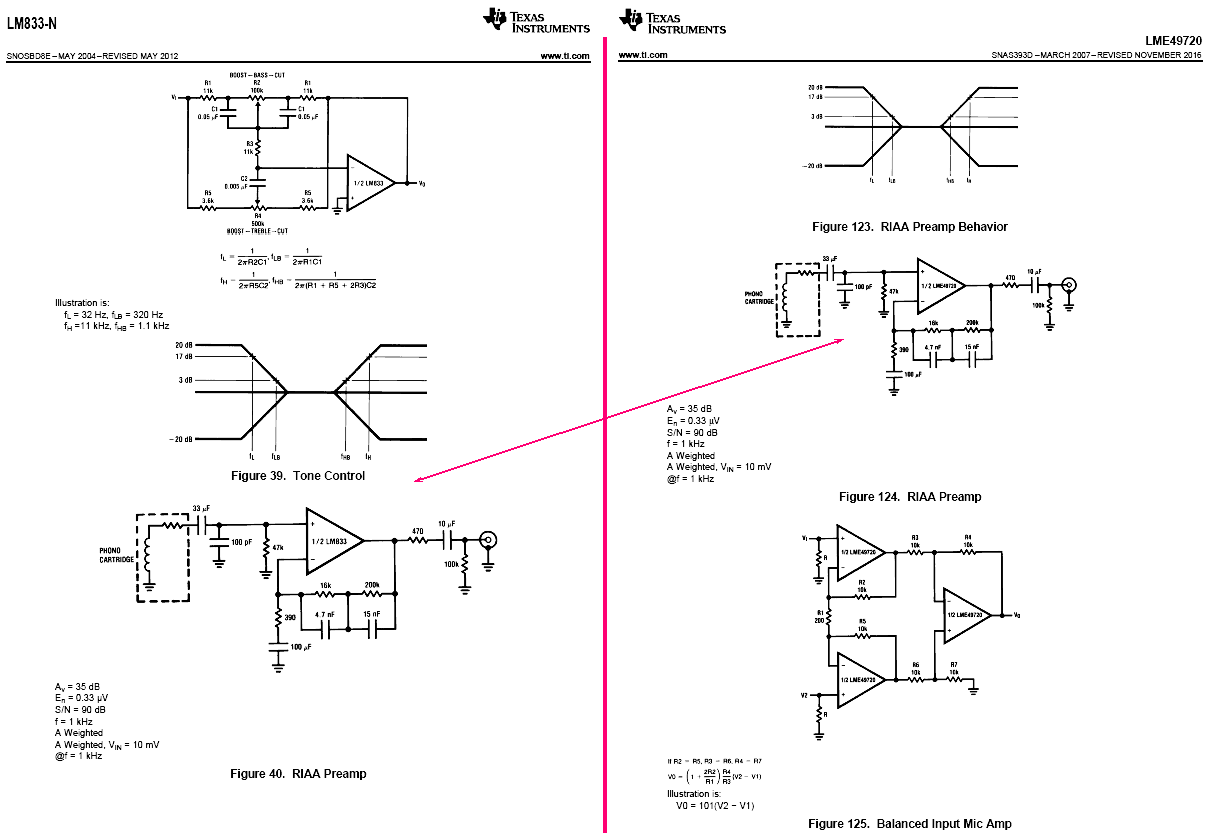

Does anyone have experience of using RIAA circuits given in the LME 49720 Datasheet by TI ?
The datasheet I found has a "noise measurement" circuit with an RIAA stage at the front.
Alas its nonsense as the inductance of the source isn't present, its just a 470 ohm resistor, so is going to give results way better than with a real cartridge. Bit shabby that... After all most MM cartridges have about 0.5H of inductance, meaning the impedance rises to tens of kilohms across the audio band.
If you want lowest noise MM RIAA preamp you need an opamp with low current noise, since this is the dominant source of noise for a bipolar opamp in a MM cartridge amp. The NE5534A or a good JFET or CMOS opamp will outperform the LME49720 for noise with such a high impedance source.
ALL the demo-circuits on the LME49720 sheet are *exact* copies from the much older LM833 sheet.
It should work. Probably won't suck. I'm disappointed they issued the sexy new hi-tech opamp and populated it with old ideas. And especially the RIAA data "can't" be the same one to the other.

There are two RIAA circuits given in Datasheet of 49720. One with Single Opamp and other one with Two Opamps.
Your valuable ideas would be graetly appreciated. If not what would be the best RIAA for MM cartridge ?
Where?? (And please *give link*, we are too lazy to Search it out every time.)
Fig 110 is *three* opamps and is a "measurement circuit". After a 1-opamp RIAA it adds two more stages *for test only*, to bring the small hiss up big enough to measure on ordinary meters.
Fig 124 is the RIAA plan you want.
(Fig 123 is mis-labeled, should be "Tone control behavior". Sloppy copy-over.)
Page 1 and 33.
The claimed noise performance of the one on page 33 is wrong.
They've clearly ignored the cartridge inductance and the 1.6pA/√Hz current noise going into it. It completely dominates, they ignore it. Perhaps they think current noise doesn't affect reactive components? Whoops.
They also sort of cheat by 6dB by using 10mV as a signal level, rather than the widely used 5mV.
90dB SNR quoted is going to be more like 70dB and easily bested by a bog standard NE5534A circuit with 1/4 of the current noise (0.4pA)

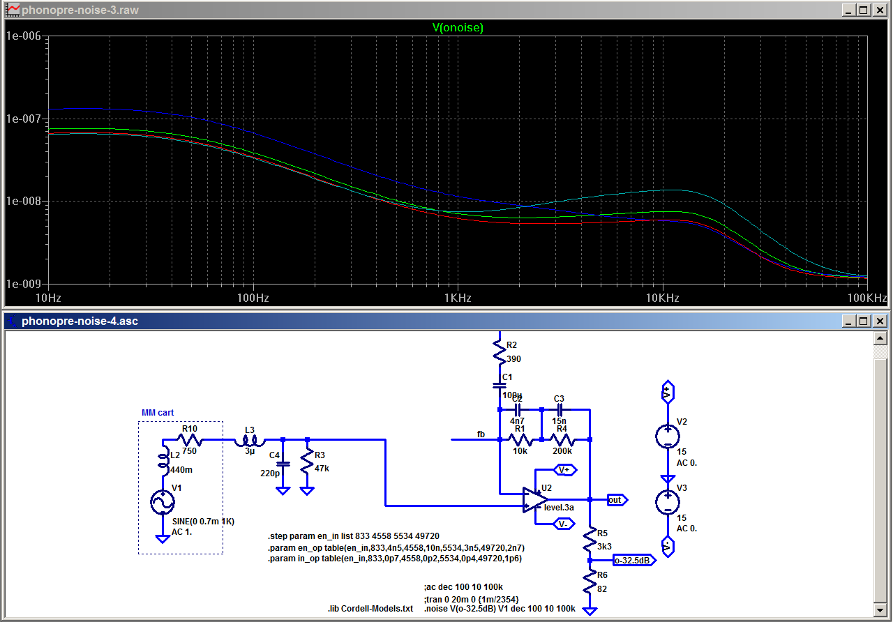

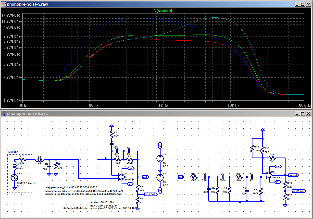

A litle sim.
attachment.php
blue: 4558 (10nV/0.2pA)
green: LM833 (4.5nV/0.7pA)
red: NE5534A (3.5nV/0.4pA)
teal: LME49720 (2.7nV/1.6pA)
Low-frequency performance is approximate as no 1/f knees (enk/ink) were entered, but the table could be extended if so desired.
MM cart values were for an OM10 or something if memory serves (maybe an AT72?).
EDIT: And now same with an A-weighting filter.
