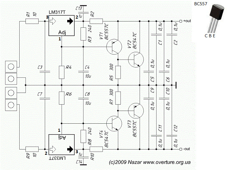

I want to share my experience regarding the project our colleague from Hungary mentioned
I built this phono preamplifier and I was happy with it from the beginning. I tested several components and the final version according to my ears, is the best. I used PRP 0.25W resistors, NO 470uF caps, the 1uF caps are 10 uF Black Gate F series (better than Silmic II), C0G capacitors in the RIAA net, NO 4.7 uF film cap bundled with the 2200 uF one, 2200 uF/16V Silmic II, (better than Black Gate standard).
Before getting to this version I used Takman REY resistors. The sound seemed dull to me. I prefer the PRP's.
I also attached the power supply I am using. The series resistor is 36R
Over all, I think it is a great sound.
