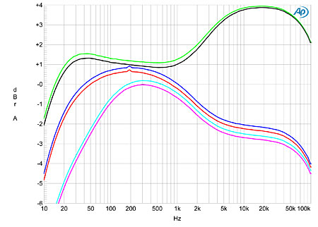

The Graham Slee link showing CCIR and RIAA as identical is wrong, then?

I would say, academically speaking, yes.
However, as this only effects the presence of an infrasonic filter at 20Hz or not and Graham has not accounted for this anywhere in his table I think from his viewpoint RIAA and IEC and CCIR are identical, even if from mine they are not...

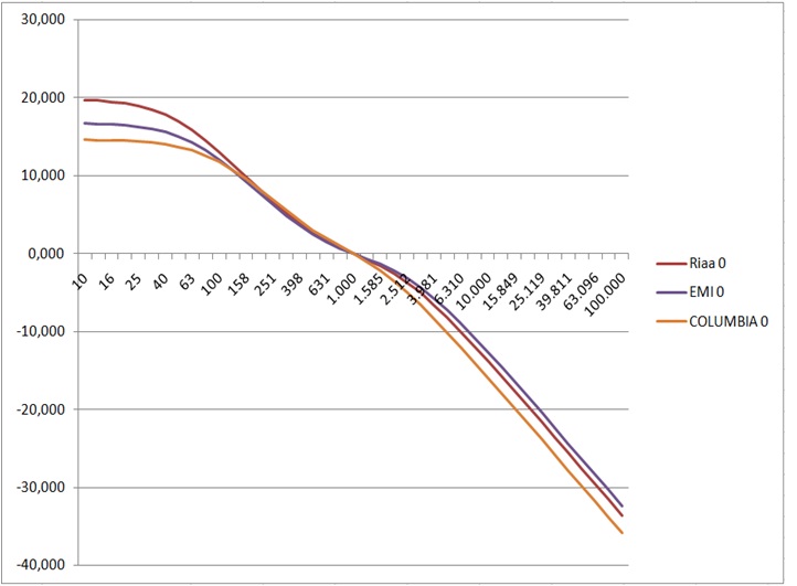

Based on this info:
SYSTEM Treble turnover Bass Turnover Lower bass t/o
RIAA (CCIR) 2.1215 kHz 500.5 Hz 50.05 Hz
EMI LP 2.5 kHz 500 Hz 70 Hz
COLUMBIA 1590 Hz 500 Hz 100 Hz
I used Spice to create some files I ploted in Excel:
As Bass turnover is very similar in all situations, I just need to adjust some caps and resistors to get these other curves.

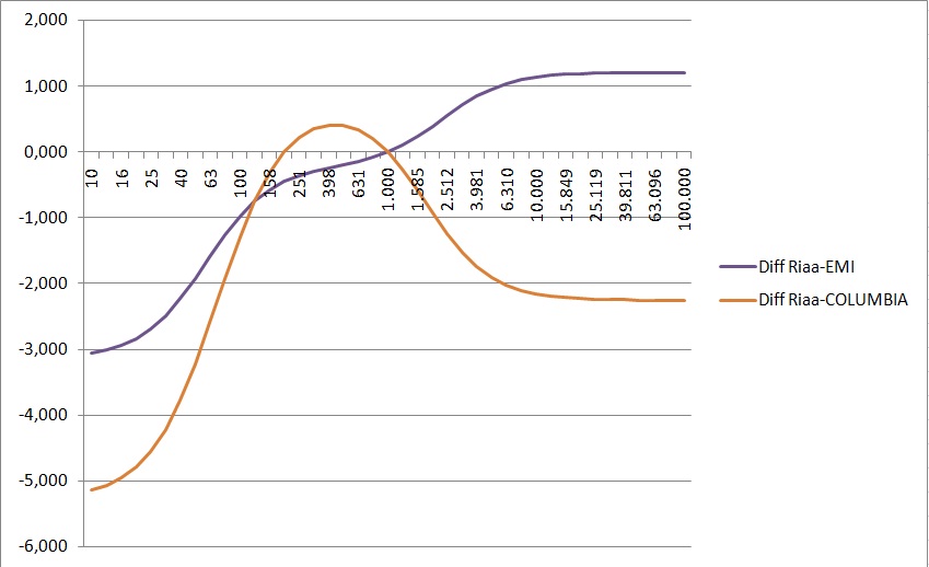

Looking at the first Graph, they look very similar but the second graph tells a different story. It represents the differences in dB from EMI and Columbia to Riaa EQ.
From Riaa to EMI they are within only 3dB from 40 to 20000Hz. There is a difference but it's not extreme at all. I would ignore it.
But from Riaa to Columbia there IS a strong difference.
Looking at the graphs we might understand that playing a Columbia eq record with a Riaa EQ phono should produce enfasis on the highs and lower bass, slightly reducing the presence band.
EMI EQ records should sound slightly dull when played with Riaa EQ.
That should explain why Miles sounds so screetchy sometimes.

Just consider what the microphone’s diaphragm suffered in front of Mile’s trumpet 😀

You realise that G. Slee shows the equalisation curve, while the stereophile measurements show the result of using the AP2's RIAA Pre-EQ followed by the stated equalisations (BTW, I have prettier curves of this from my AP2...).
As for why G. Slee shows CCIR = RIAA without any timeline qualification, ask him.

Sorry, but I do not. You show two sets of graphs that show very different things.
Secondly, what is documented are the official standards, they are in the public domain, please peruse them.
In addition, any number of articles and websites document a wide range of views as what curve actually which turnovers and not all agree. Equally, there is no official formal record readily accessible nowadays who use what EQ and when, however many views can be found in print and on the net.
In no small part this is due repeated ownership changes, takeovers and "cleanouts" at record companies, closures of recording centres etc. For all we know the documents may exist and moulder away in some corner of some basement (together with some priceless master tapes that have also been forgotten) or they may have been shredded. The record companies are not keen to allow access to their archives anyway, you can try if you like.
So as I said before, the information used by AMR was assembled from a range of sources, the really good ones are in institutional radio archives etc., however even their information is by inference or 2nd hand.
Much of what happened around the whole EQ story happened basically in two decades between 1950 and 1970 (roughly). Anyone working at the time then would be by now at least retirement age or older, if still alive. We have not easily found anyone to talk through who was "around" at the time.
If you know former cutting engineers who worked for DGG, Decca, Columbia etc. please introduce me.
I am as much interested in harder facts as anyone, they simple appear to be hard to come by. This may be an interesting subject for some academic research and probably very high time too, however I have no need of doing an PHD Thesis on the history of LP Equalisation, even if I had spare time...
On the other hand, the effect of the different equalisation curves is very simple to illustrate. You merely need to play an LP and switch through the different EQ's. Invariably there is good agreement among even quite large audiences which EQ is correct and I have so far not encountered any situation where the chosen EQ was one that was "impossible" for the given LP.
So, in then please try yourself. It is not that hard to modify any existing Phono Stage, or to build from ground up one that has the necessary adjustments.
Then decide for yourself. This in fact has always been recommendation.

When I came to London as a student in the 1980's the very first record that I bought( in HMV in Oxford Street, not some dusty import shop in Soho) was Melodiya D08779-80, Sofronitsky playing Scriabin-you couldn't find such exotic fare in Belfast where I grew up. In other words, I bought a newly pressed mono record which had been produced from a stamper made in 1961, more than 20 years previously.
The PH-77 above is hardly the most expensive valve phono in the world but it does give you the option to try different EQ which you may not suspect you require and after all, most serious record collectors do buy 2nd hand records.Without actually trying, most discussion is mainly hot air and even in such places as the archives of HMV such documentary evidence as exists may be ambiguous if not actually self-contradictory. It is my (minority!!) view that all phono stages which aim to be remotely "high-end" should provide this facility.
The issue is not whether one needs variable EQ-curves for mono-pressings from before 1960, or for pressings from the former Eastern block -- that's actually quite handy.
But AMR have been making claims about the need for similar EQ on stereo records pressed after 1960 - and most of these claims do not stand up to closer scrutiny, with many of the sources shown to being quite clear that there's no need for anything but RIAA after 1960.
It would be good to receive some other documentation beyond "it sounds better." Sure, I can EQ the frequency curve to my liking on every record I listen to, but I'm coming down on the side of Michael Fremer (not Miguel, as Thorsten seems to enjoy calling him.)
Yes, I agree that the claim made about stereo LP's is extremely contentious and my first instinct would be to dismiss it. Nevertheless it cannot be denied that the earliest Decca FFSS LP's sound really quite different from their reissues in quite a consistent way and one might say the same about DGG. The question as to why this is the case leads one to at least ask questions about the EQ, don't you think? American recorded RCA "Living Stereos" on the other hand do not sound so enormously different from their Victrola reissues.
