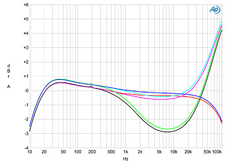

Ok, from the Stereophile review: PH-77. The secret curves.
Red-blue: RIAA
Cyan-Magenta: "Enhanced RIAA" (freq response is relative to RIAA)
Green-Black: "RIAA DMM" (freq response is relative to RIAA)
The "Enhanced RIAA" is within 0.5dB of the RIAA curve at the audible range. Thus it's basically the same thing. Nice.
The "RIAA DMM" is within 3dB of RIAA so basically is a subtle change, a matter of taste.
Red-blue: "Decca FFSS (stereo)" (curve relative to RIAA)
Cyan-Magenta: "Columbia"
Green-Black: "CCIR 56"
"Decca FFSS" is within 2dB of RIAA. A slight tonal change. But certainly no difference that could be caused by using significanty different time constants (relative to RIAA)
"Columbia": Same comments as above.
"CCIR 56": This one is different indeed.
This is my point of contention: The "Enhanced RIAA", "RIAA DMM", and "DECCA FFSS stereo" are basically very subtle variations of the standard RIAA curve. Thus we can't say thus records were cut using "a different standard". A mastering EQ, used at will by the mastering engineer, will vary the final EQ much more than the difference between AMR's "Decca FFSS stereo" and plain vanilla RIAA curves.
I understand that CCIR 56 is different and ThorstenL may as well have a good point in saying that some records on the eastern countries might have used CCIR 56 instead of RIAA. But the other "curves" should not be claimed as EQ curves that significantly deviate from the RIAA standard, and this is what i don't like about the publicity on the AMR website.
On the other hand, Telemann and others raise a point i fully agree with: It's very hard to believe that Deutsche Grammophon wasn't using the RIAA standard from the beginning. Unless we get specific examples. But i have early 60's stereo records from them and they play just fine with the standard RIAA eq.

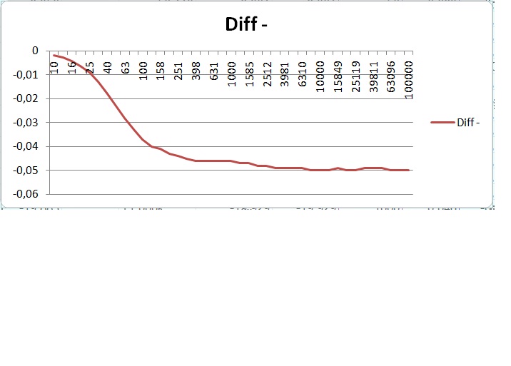

I can distinctly hear differences of 0.05dB produced by the variation of a single resistor in my riaa preamp.
AMR curves show much larger differences.
In attach you can see the difference by adjusting main resistor from 46020 to 46284r in my passive riaa build.
I wanted more attack and byte and that is what I got in this case. The difference is very small in dB but clearly audible.

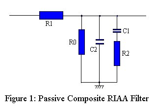

I am using a passive riaa like the one in attach.
Where the initial values where:
R0 = 1M
R1 = 44910r
R2 = 6730r
C1 = 47.25nF
C2 = 15.33nF
Main R is a combination of R0, R1 and the 1st stage ouput impedance.
C2 depends on the miller of second stage and some other aspects.
By increasing R1 from 44910 to 45170 (a small 260r difference) I can distinctly hear the difference.... More snap and attack. We can not increase this resistance too much otherwise the sound will become edgy.
The graph I posted was obtained using spice simulations, just altering the Main R.... maybe these simulations do not reflect reality and the value 0.05dB is in fact larger....
I can also hear distinctly a 10pF variation on the trebble cap C2 = 15.33nF.
For instance, to get the correct 318uS mid pole I needed to find the exact values for R2 and C1 (6730 x 0.04725) .. any deviation from that alter the timbre of the instruments.
I understand most people have hard ears and maybe that is why most equipment are sold on the ownership pride basis and not based on the subjective listening impressions. In this way a Vitus should sound better than a ASR Basis just because it "is better".
I just posted my graph because someone wrote that the differences between the several curves in Thorsten´s machine were negligible and I believe these differences are VERY audible indeed.
