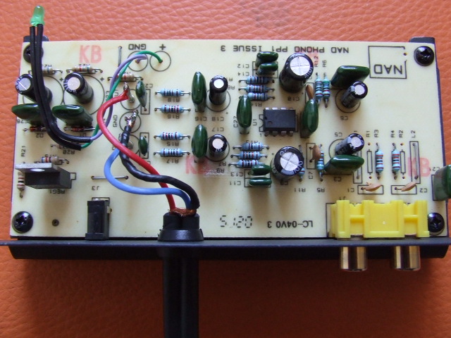

Philips actually have a worked example in their AN142 '5532/5534' applications data sheet that sees the feedback return reduced to 49.9 ohms. This looks to be designed for absolute minimum low noise.
The 47 uF decoupling the 49.9 to ground definitely is too low. I’d use a 1000uF there fo4 reasons touched on by an earlier poster.
50 ohm is so far below the equivalent noise resistance for an NE5534A its silly. 3.5nV/√Hz is about that of a 750 ohm resistor. A 150 ohm resistor has 1.6nV or so, upping 3.5nV to 3.85nV, which is a pretty negligible increase, no need for any smaller resistor value than that, and every reason (avoiding excessive capacitor sizes) to not go lower. In practice other sources of noise will be dominating anyway, so 220 ohms for the lower feedback network leg is a common choice.

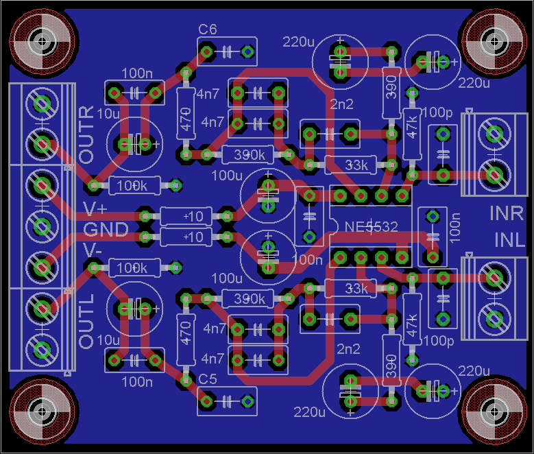

Here is the photo of my original PCB which is good for every active RIAA EQ that uses topology from LM833 app note which is the same as Bonsai's Hifisonix RIAA EQ amplifier. I did not use footprint for parallel cap in EQ section of the circuit so I had to solder it on the bottom side. I shall try Bonsai's circuit values in the next few days and report my impressions. The only thing that my PCB does not have is secondary post filter (like in the Bonsai's circuit and like one used in very good budget phono amp NAD PP1) I use two series electrolitics to ground with negative sides connected with the gain setting resistor. It's much cheaper than bipolar elco. I use great NJM2114 opamp for all my builds. It's a kind of improved NE5532.
I intend to make new PCB that will include secondary post filter. There is enough space on the PCB for it. I shall keep input cap to ground so that I can fine tune input loading for any cartridge on the market. (100pF is good allround compromise).Take a look at the NAD PP1 schematic. It has all the goodies for a simple RIAA circuit.
Lose C3 and C15 they are doing nothing (and if ceramic will not be C0G and thus bad news for distortion).

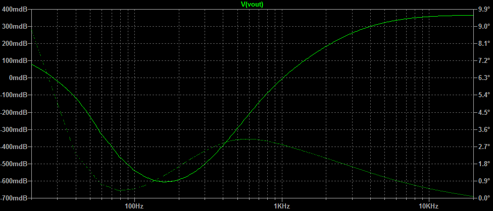

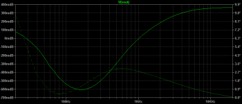

Here is the deviation from the ideal RIAA curve for a preamp with the values from post #3:
RIAA circuit help needed
I calculated it by connecting an accurate inverse RIAA filter at the output of an RIAA preamp with the above mentioned values.
The deviations are rather large, IMHO.

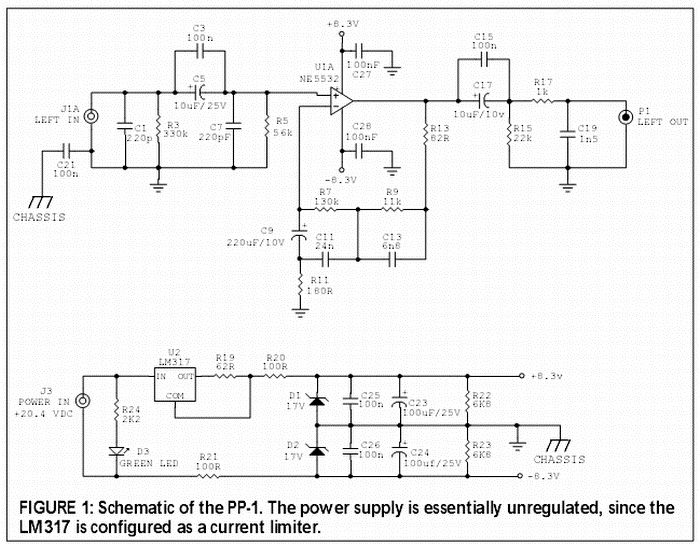

Circuit from post #3 is in fact circuit from post #1, with only gain setting resistor reduced from 390R to 180R. Is that what you used in simulation? Does it mean that reducing gain setting resistor is enough to change RIAA EQ considerably?
Sorry, my typo, it should've read post #7, since you wrote to have built a preamp with the values suggested by @davidsrsb.
Thus, the simulation is valid for the values from post #7.
Main reason for the deviation is the capacitor C2. Using the spreadsheet from Bonsai:
RIAA Equalizer Amplifier Design
its value should be 8.16nF for a perfect RIAA curve with other component values unchanged.

My PCB would not need any rework if 8n2 cap would be available. In that case only one footprint will be enough. But I can't find 8n2 poly caps with 5mm lead spacing in local shops. Only 6n8 and 10n, nothing in between.
I shall change footprints for series back-to-back elcos to earth, so that two 1000uF/16V caps can be used to get 500uF.
You don't have to search for capacitors with exact values - just provide two footprints per capacitor position on the PCB and then combine by paralleling.
For example, 8n2 is a combination of 4n7 and 3n3 capacitors, and a 220 pF C0G capacitor can always be strapped across one of them at the back side of the PCB to make up for the missing 200 pF.
This method is cheaper and more flexible than searching for a single capacitor with the exact value.
Braca
