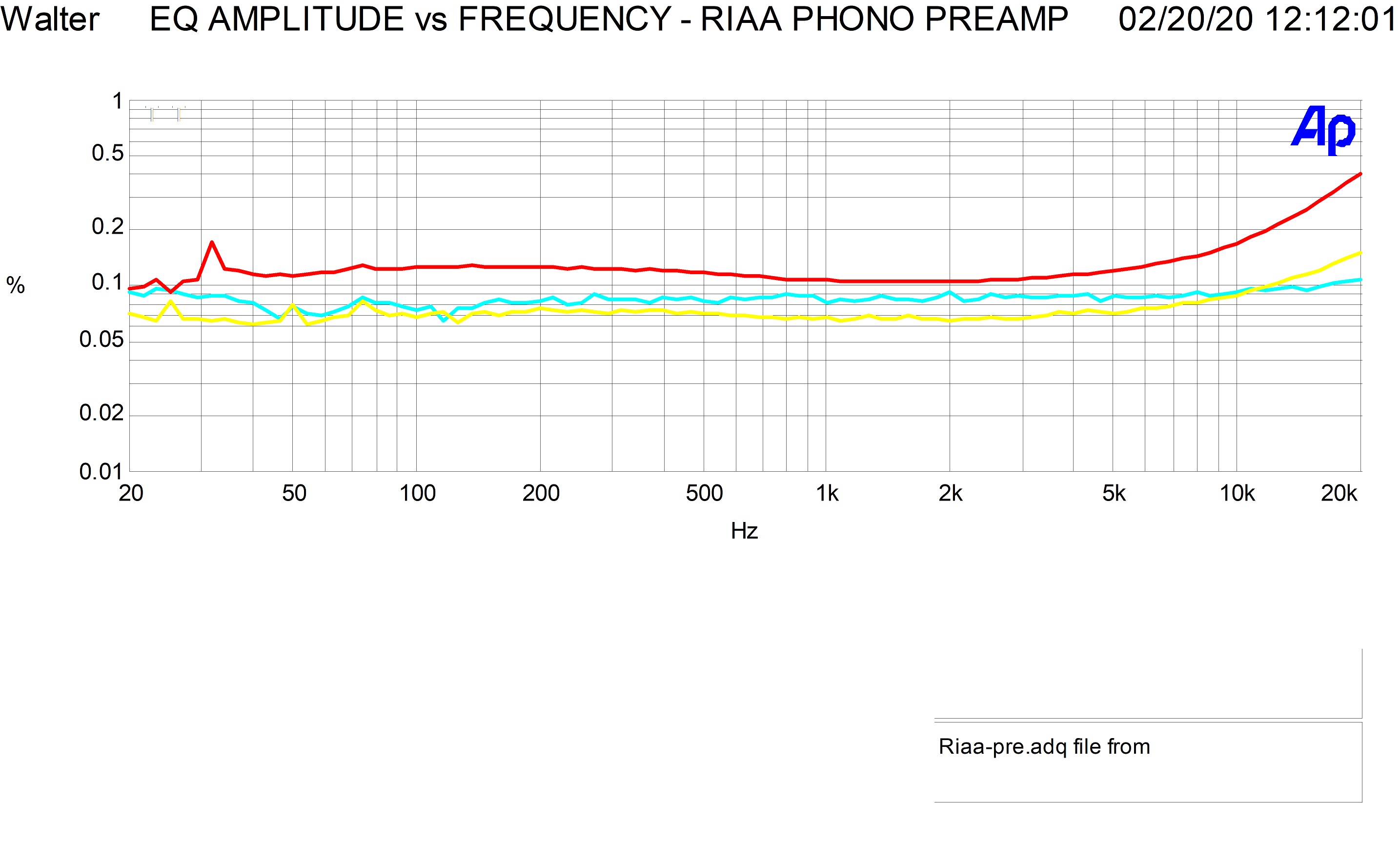

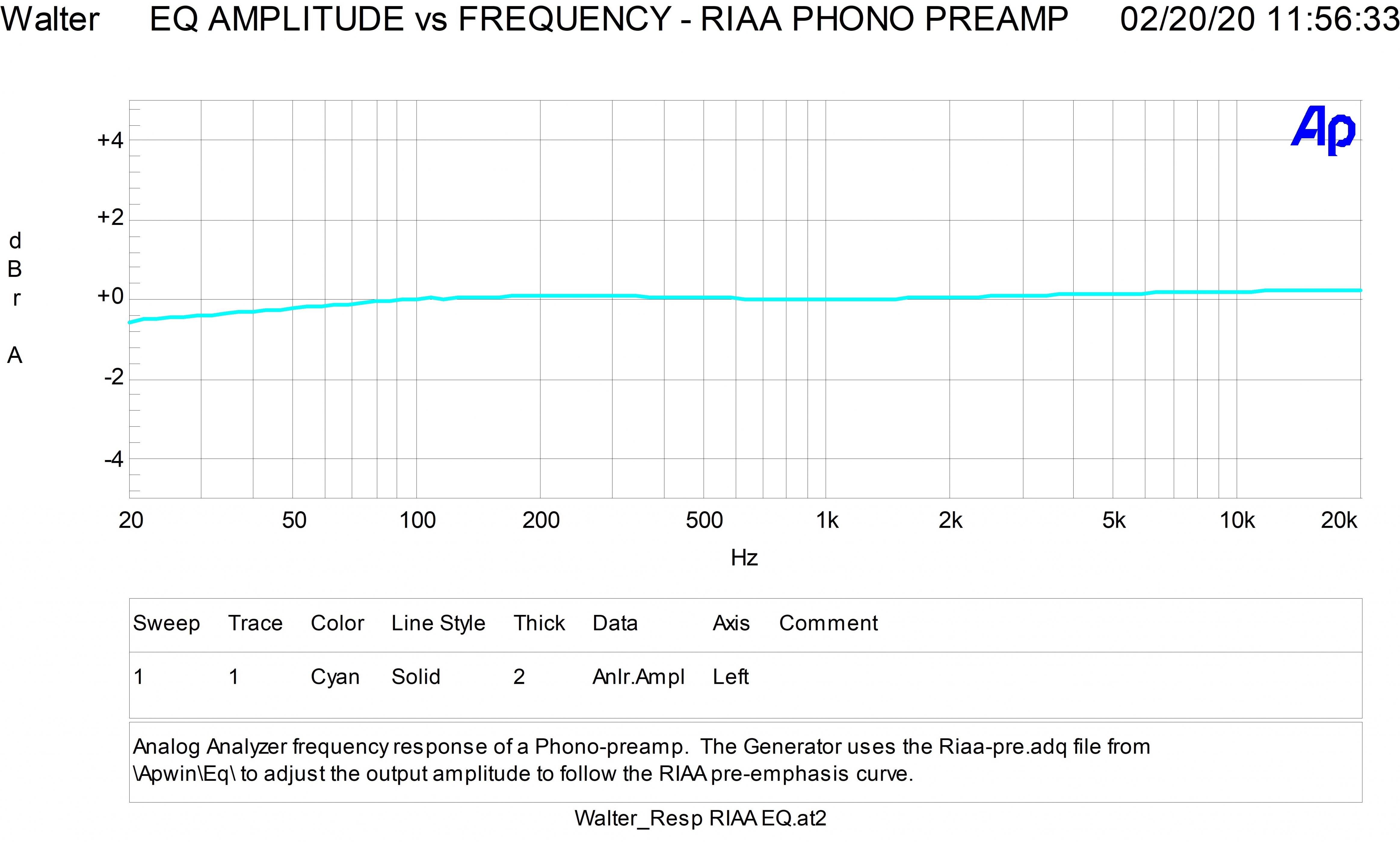

This is the response I intend as linear.
There is a loss 0f 0,6 dB at 20 Hz; ECC83 used.
Thr other graph is related to THD vs Freq at three different level of input:
4,1 mV, 8,2 mV and 16 mV; the gain is around 42dB
so 4,1 mV =500mV out
8,2 mV= 1 volt out
16,4 mV = 2 volt out
with Zout of 250 ohm
The shape is good for the three curves also a 20 kHz
In this project it is possible to change the gain tubes modifing the amplification
A new project of tube phono for Audioreview magazine in Italy
Walter

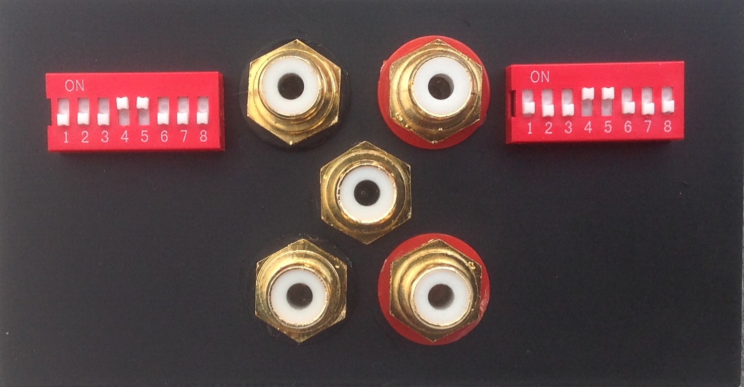

But if you pay €400 for a cartridge and you like it but need some more hightones. The impedance change (5 cent) can make you happy. It is fine tuning. It is cheaper then buying new cartridge or new speakers.
My switchinputboard i also can adjust inputcapacitance.

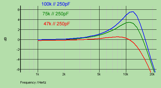

No, you are in error!
You must find the way to get the flat response with a right de-emphasis network not from a wrong trick
Your solution give a bad quality of high frequencies with +3dB at 10kHz ( simulated, maybe can be higher in a real world).
Walter

Fine!
Remeber that you have also the capacitance of the cable in addition with the value you set
Leave ceramic and listen the music.
The value is so little.

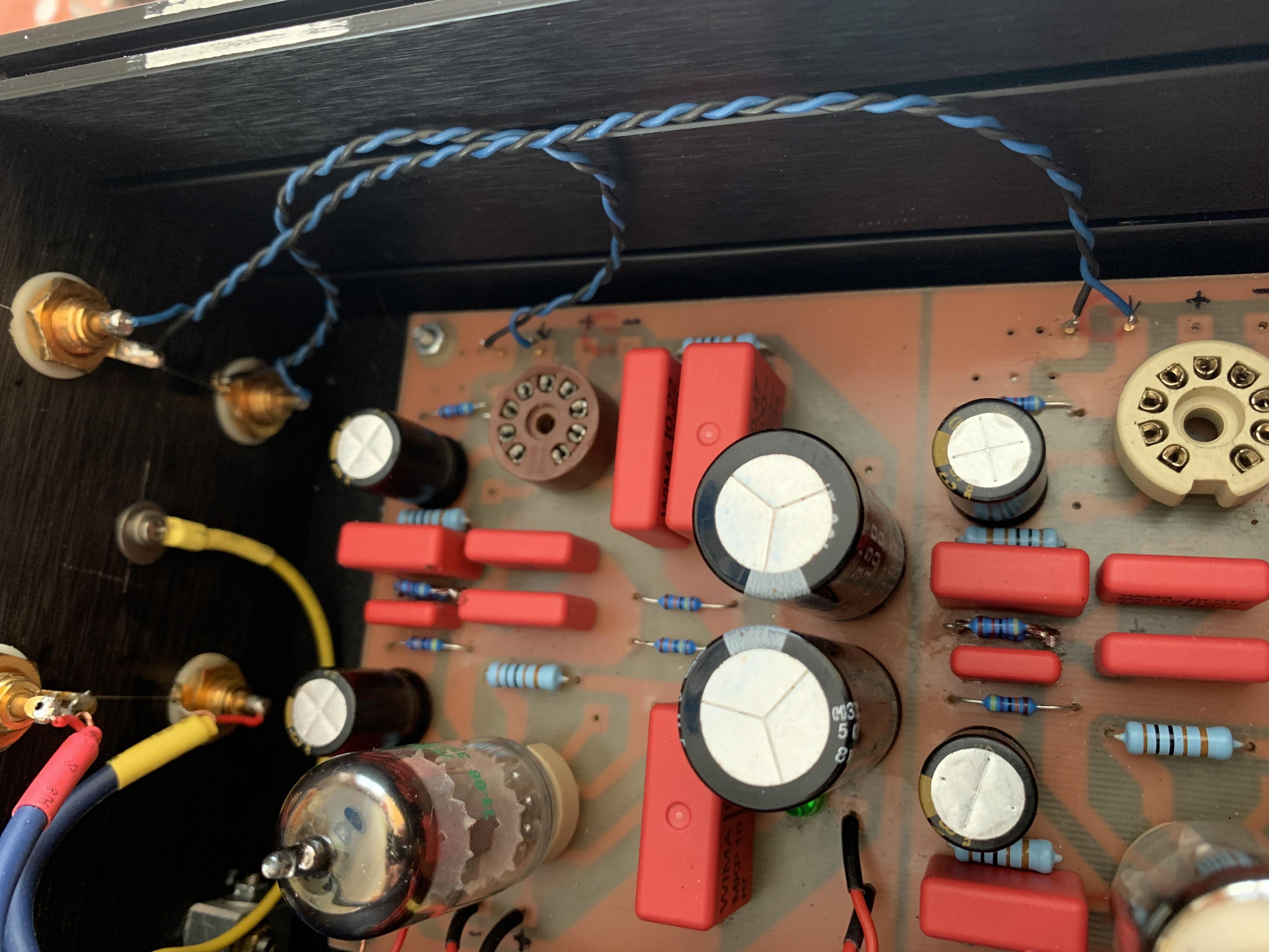

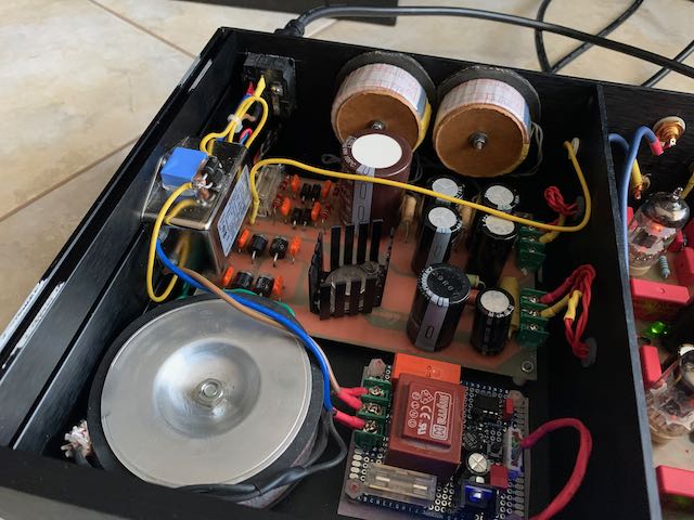

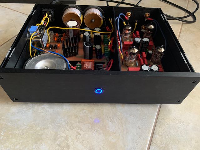

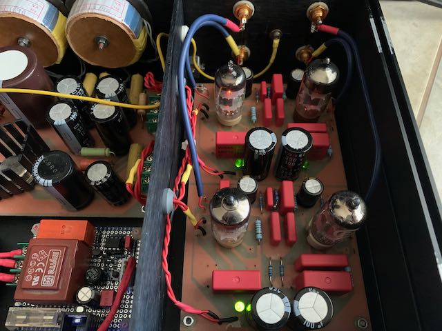

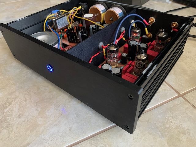

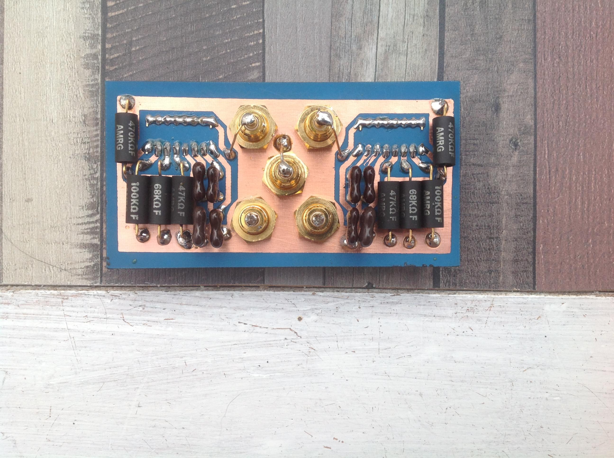

hi,
now, when everything works as it should, i am posting a few photos of the preamp. Next, i am going to try a few different tubes that i have.

I measured the input capacitance of the preamplifier at the input rca and measured 220pf at one input and about 190pf at the other one! The capacitors I have are 150pf. These cables that I have used together with the rca on the chassis adds another 70pf and 40pf due to the length difference. So I changed the shielded coax cables with twisted pair I of the same length and the result is that now I have a total 170pf at both inputs. Now I have learned that twisted pair cables have much lower capacitance.
If you are in the range of 250-330 pF total, included the cable from turntable, it is fine.
Look on the MM cartridge specification maybe there is listed the optima capcitance
