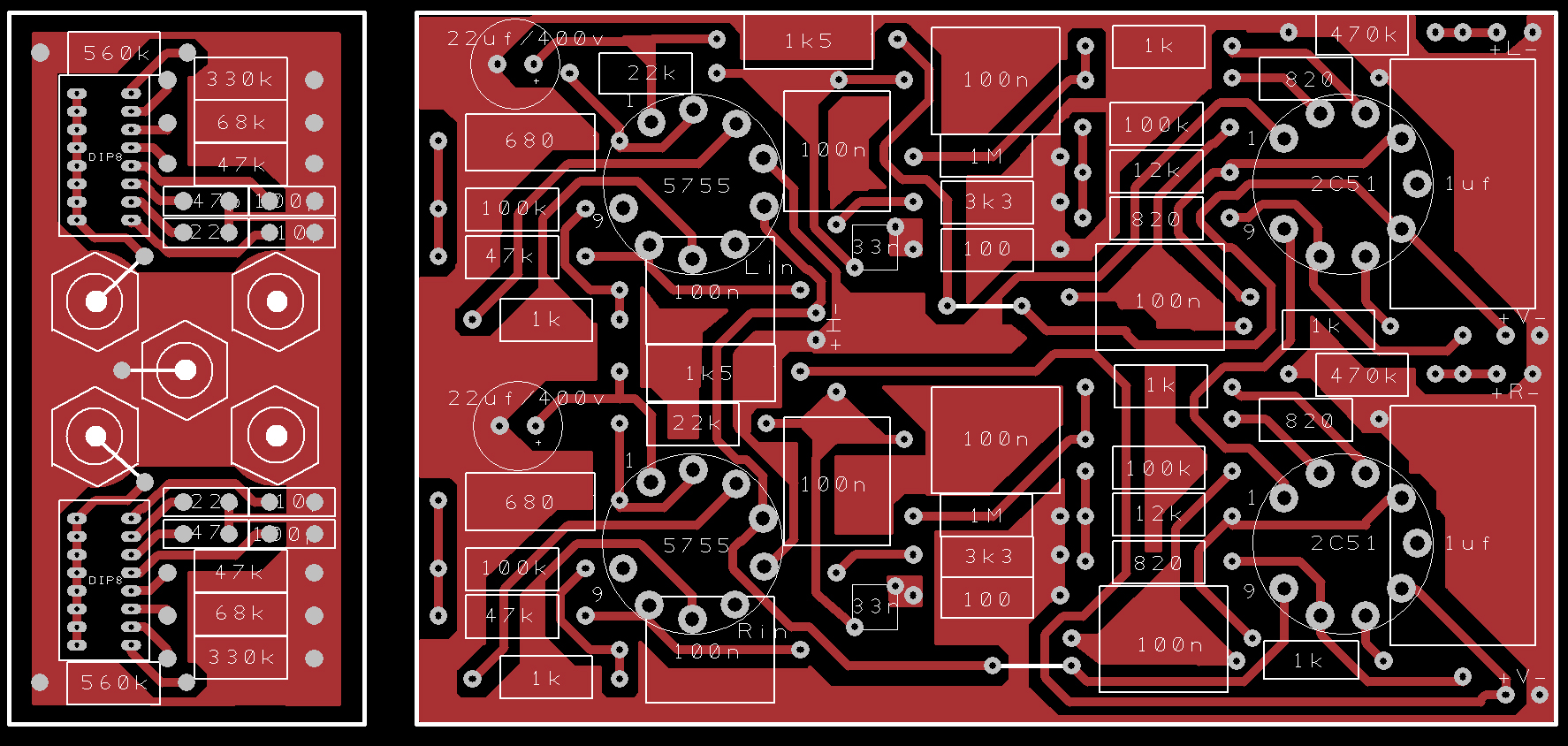

Be sure i will this designed a pcb for this, i like mu follower stages; high gain, low output impedance, low non-linear distortion

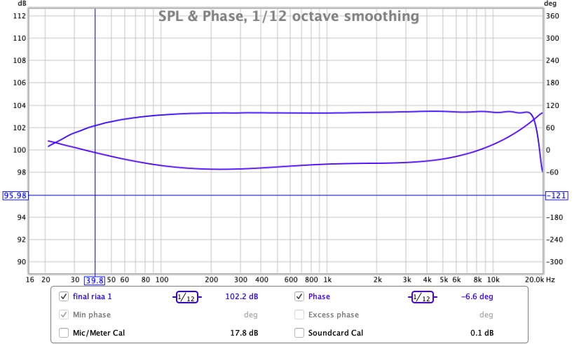

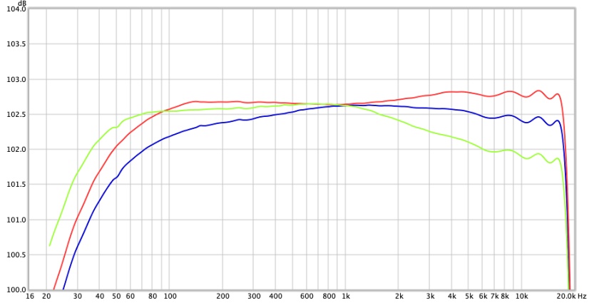

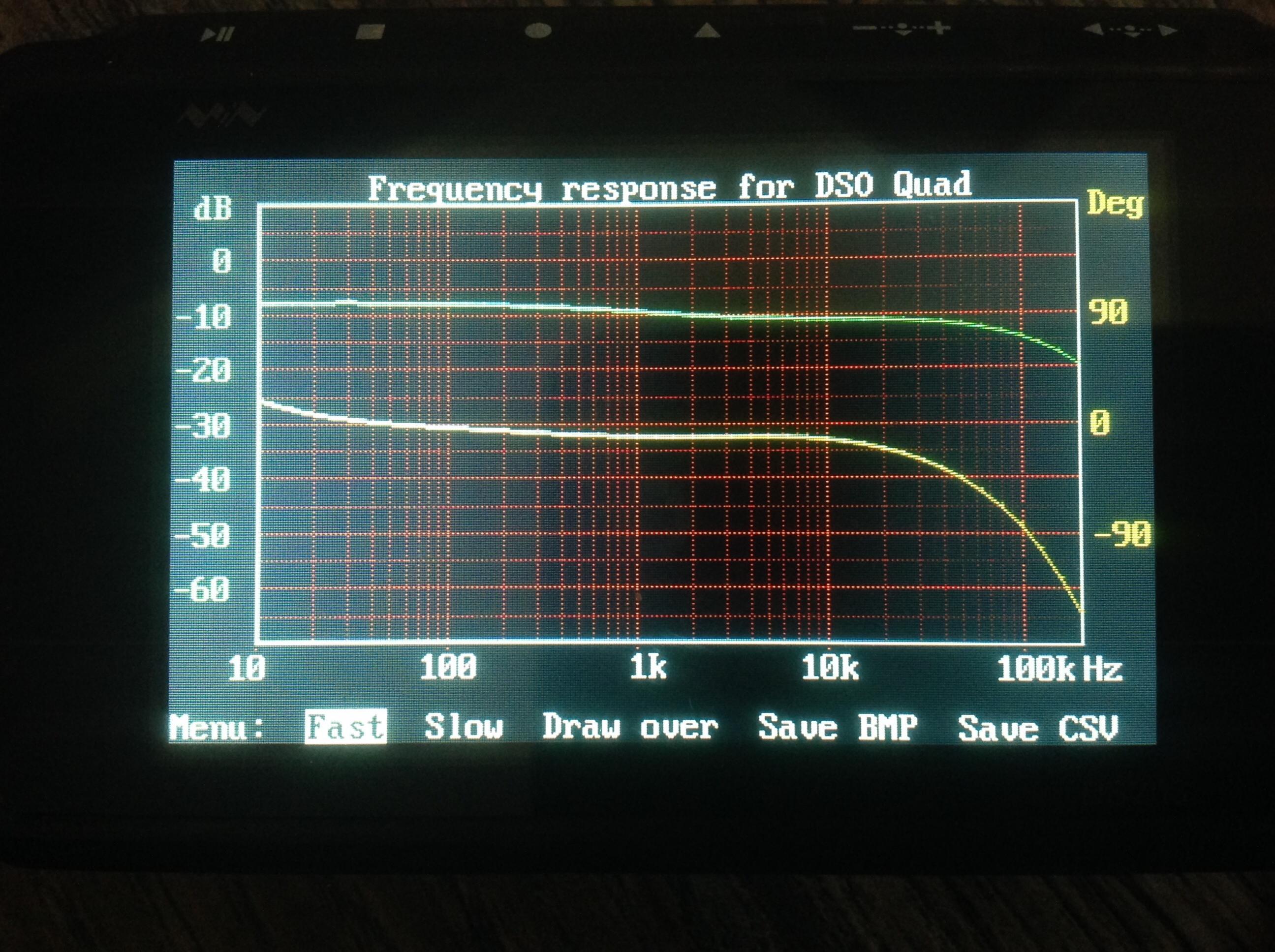

hello again,
today i finally finished the preamplifier. In the picture you can see 3 frequency responses using different riaa filters. Which of them do you believe will sound better?
The green response is the riaa filter from the elektor magazine , the blue one is the groovewatt tube preamp, and the red one is the groovewatt preamplifier but with the resistor in series with capacitor changed to a smaller one (from 10,8K to 10,14K).(I know that the differences are small)
can you suggest a change so it can be <flatter> ?

I think nobody can tell you which will sound better. There are much more parameters that have influence on the soundsignature. Things like phase shift, distorsion, slewrate etc. You must listen for yourself what you like.

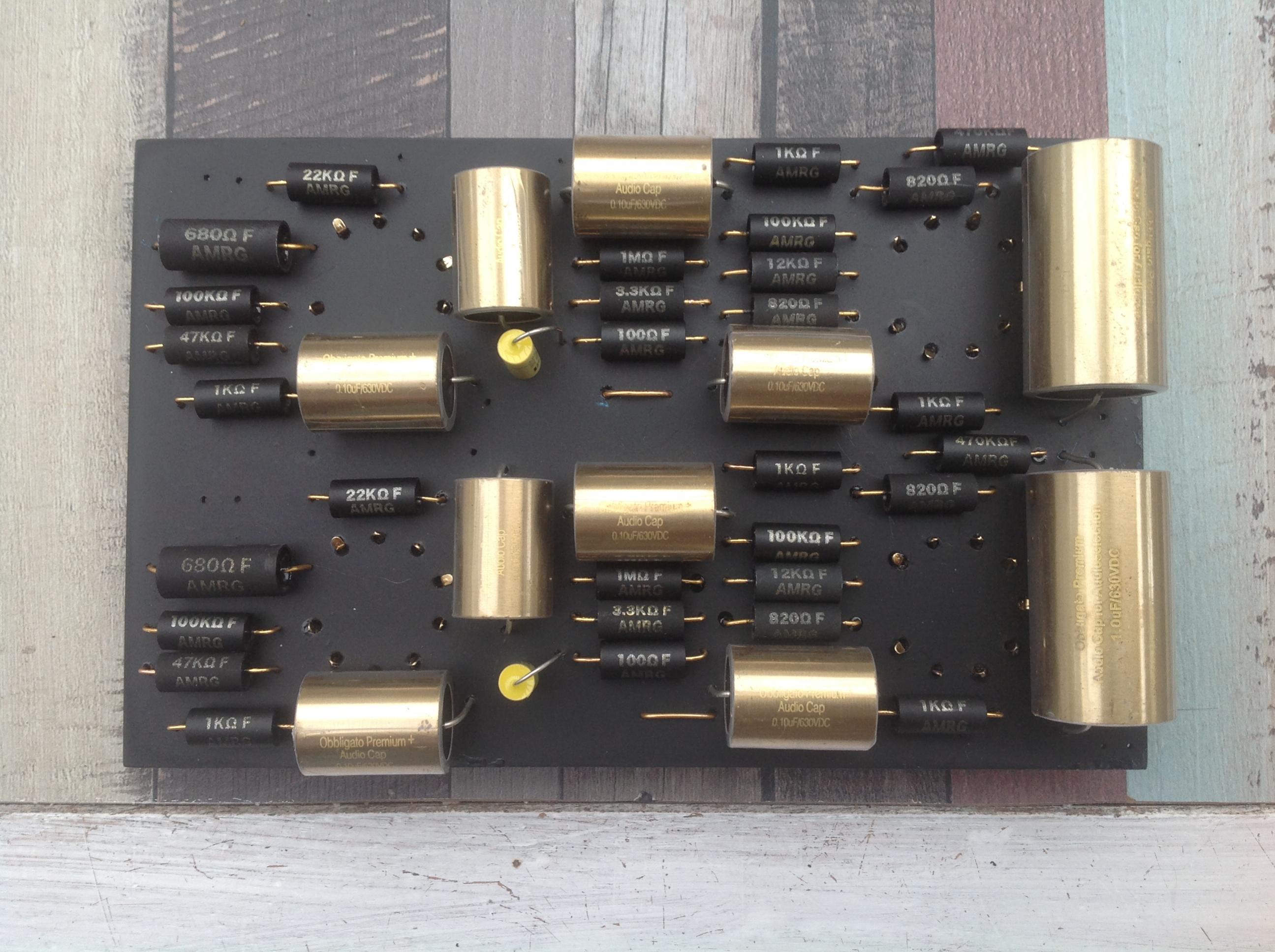

yes, i used 3 different passive riaa filters between the tubes. And the results are in the picture. Theese are real measurements - not simulations. I cannot decide which filter i should finally use.
The more linear, of course.
Every riaa de-enphasis must be compliant with the standard curve.
No other chance.
Walter
No other chance.
Walter

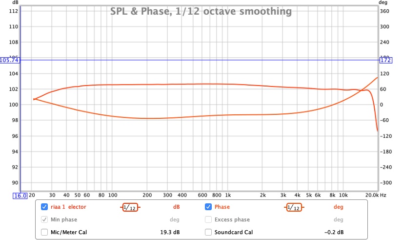

as somebody in this thread said that i should try the flattest one, i finally use the riaa filter which has the response/phase as seen in the picture. I have not listened it yed but i think that it should be ok.
As a second option i always have the elektro magazine filter as seen in the second picture (red curve). It is not as flat as the previous one but i dont know which of theese two filters will sound better. I have a ortofon silver stylus and i dont know its response (for example if it sounds too bright i will choose the red curve response). If someone knows this stylus and how it performs please let me know.
