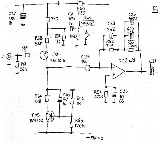

and in the attached file you will find an approach from Tim de Paravicini (developer also for EAR).
The input resistor was replaced by a a transconductance amplifier stage (T16, voltage in, current out).
What about this ?
