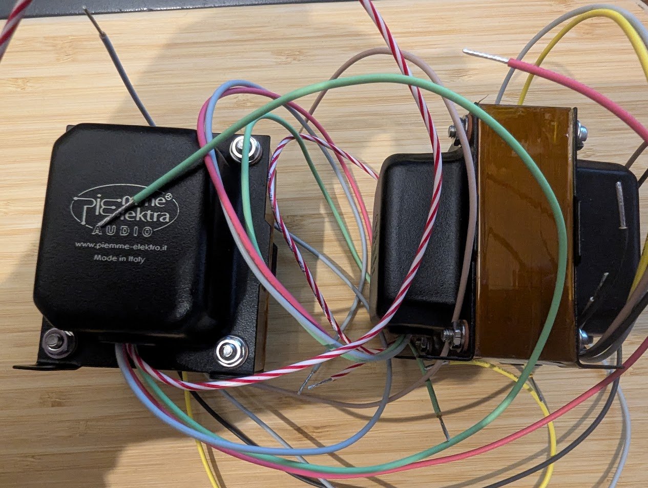

Cool! How are they? I didnt had the currage to order the transformers right away. Im building high sensitive speakers, before building a 4w SET amp 🙂Received the transformers.
Are planning a build with Them?
They are nice and petite. Just a simple RH-84 is what I'll use them for.
One can see that the builders have paid attention to the details. They are squeaky clean. Stainless steel nuts and bolts. Wires are very well terminated. But it will be a while before I use them.
