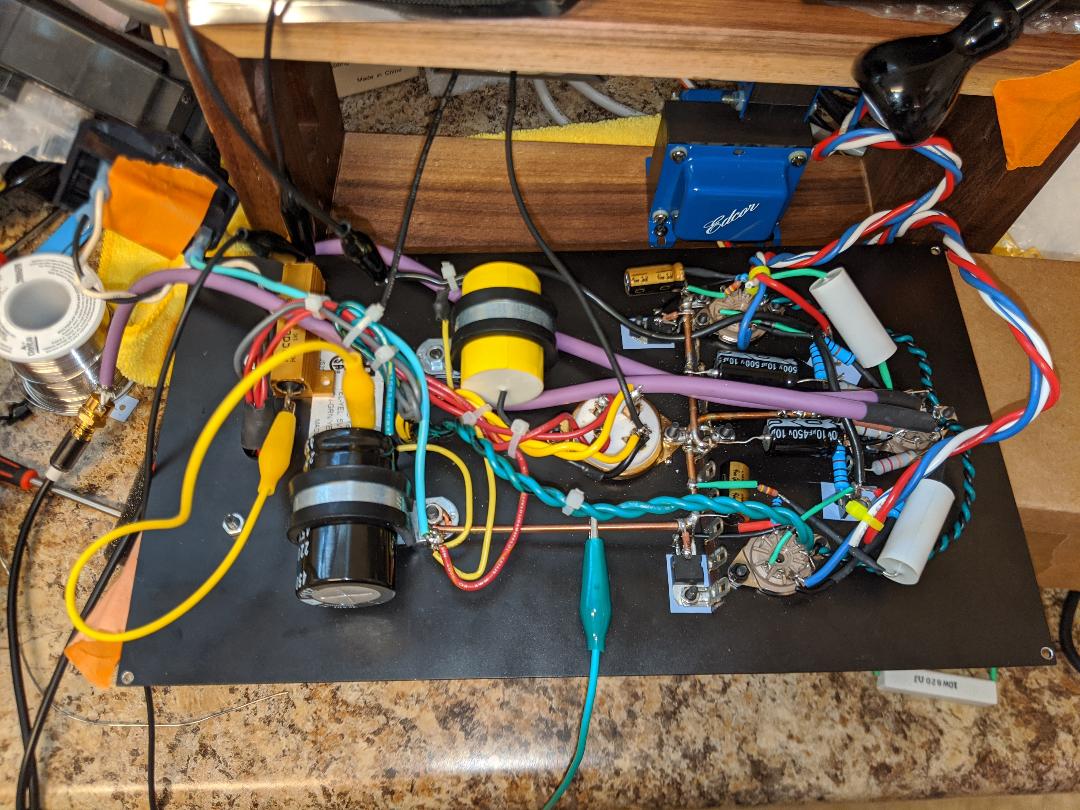

Yes, D1: I installed a resistor from g2 to ground with a value of
(315-21) V / 1 mA = 294 V / 1 mA = 294 kOhm -> anything from 270k to 330k is fine.
This way, even if the tube is not conducting, the zener works properly and screens see the right voltage, not full B+.
Another thing that I would try is to connect C2 not to ground but to the secondary of the output transformer.
This wat the DC path is to ground through the LM317, but the AC feedback is taken from secondary of the output transformer to the cathode of the output tube, like a cathode feedback.
I've built some amps with cathode-feedback taken from secondary (0-8 Ohm on SE, 0-4-16 Ohm on PP) and it works fine.

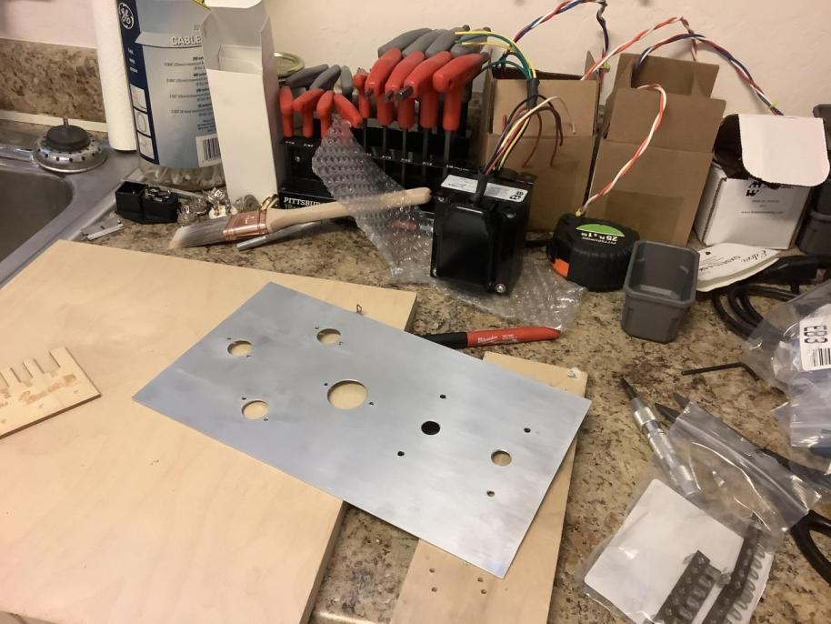

Received the transformers.
