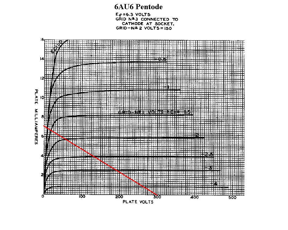

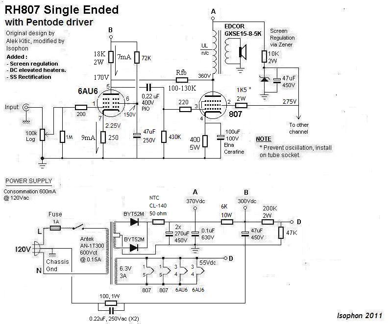

RH84 SE, pentode driver... advice please
Thank you both for answering, I must admit that this is way over my head...I have modified the schematic and came up with this for the driver;
Tube audio is new to me and I'm hooked big time 🙂
B+ 300V
Rp = 18K
Ia = 7mA
Va = 170V
Rg2 = 150V
Ig2 = 2mA
Rk = 250 ohm
Vk = 2.25V
Ik = 9mA (Ia + Ig2)
I have lower Rp to 18K and therefore left my Rfb similar to before.
Thanks a lot for your help
Eric

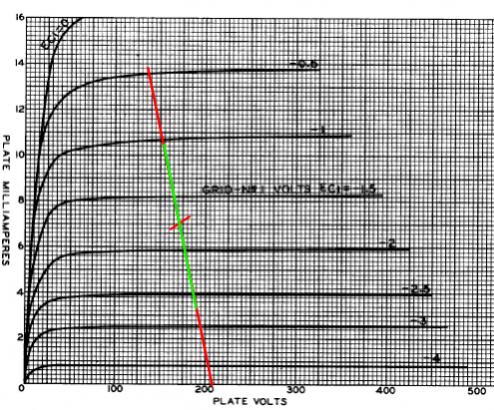

Here's an example based on your circuit values.
First look at the 807 loadline to get an estimate of the in-circuit gain. Here we have about 4mA/V into 5K load for a voltage gain of approximately 20. Assuming 150K Rfb, the effective load due to Rfb will be 150K/(20+1) about 7143 ohms.
This is in parallel with the 18K plate resistor for an effective plate load of about 5114 ohms. Plotting this slope through your op point of 170V/7mA gives the 6AU6 loadline. I've highlighted the full signal plate swing in green.
The feedback ratio here is the ratio of 6AU6 signal current through Rfb to the total signal current, or about (1/7143)/(1/5114) which works out to .72 or 72% local feedback.
The sensitivity will be about 2.75V P-P plus 7mA * 300 ohms = 2.1V or 4.85V P-P input for full output. This is a little less than 2V RMS if I did everything right 🙂 Increasing Rfb will increase the sensitivity correspondingly.

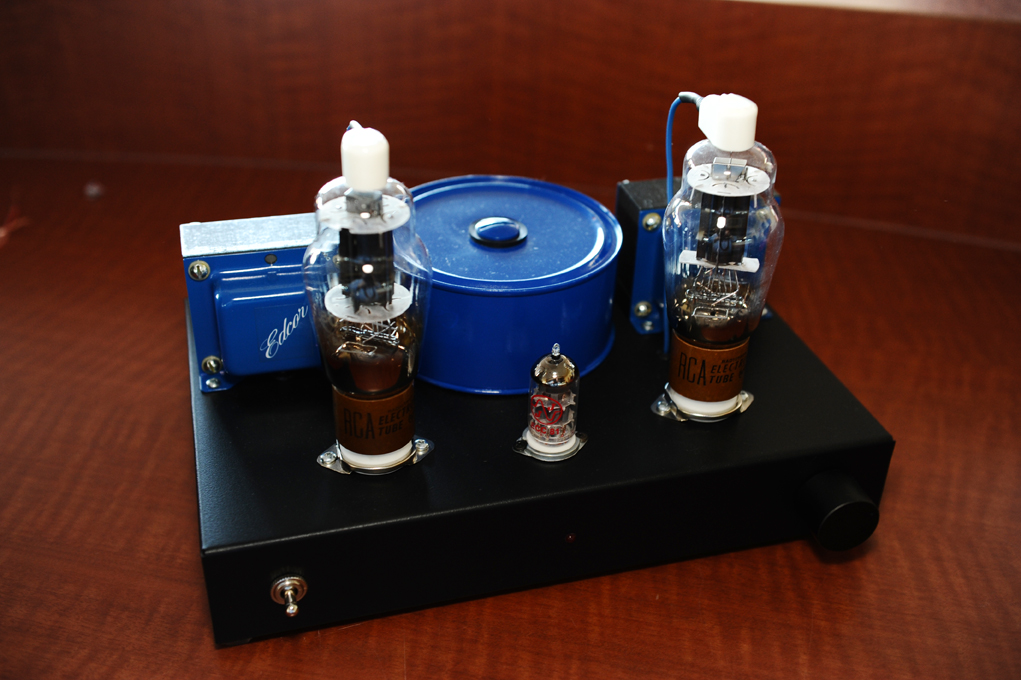

For fun, I have attached a picture of my RH807.
TIA,
Eric

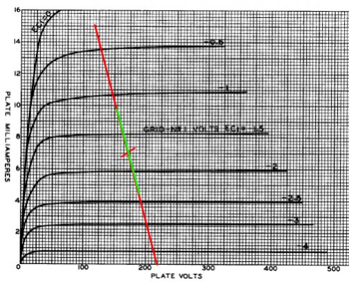

It just means that 72% of the plate signal gets back to the grid as feedback. It puts the effective plate resistance at about 350 ohms. You should have good speaker damping. Changing Rfb to 270K changes the feedback to 58%, resulting in about 430 ohms effective plate resistance. The load line of the driver goes to about 7500 ohms.
Changing Rk and Rfb should increase the sensitivity quite a bit. The Rk change should get you a little more plate current on the 6AU6, maybe getting into a more linear regime. The input sensitivity should be about 1V P-P grid swing plus about (5.5mA * 180) 1V degeneration for 2V total P-P input sensitivity at full output.
Maybe measure Vk, Vg2, Va on both tubes, just to verify all your op points.

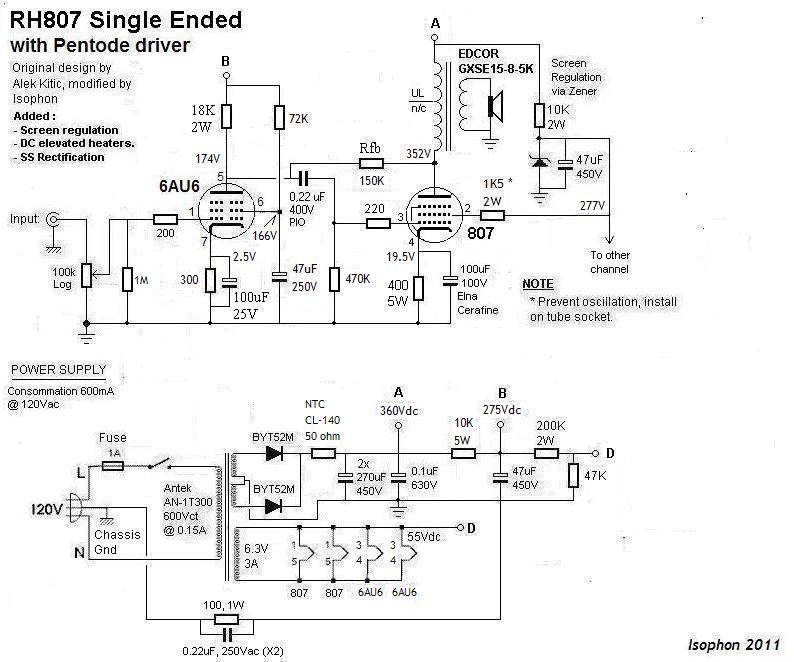

Schem with measured voltage
Here is my schematic (exactly as built...for now...) with some measured voltage, hope this helps to figure out why as soon as I turn up the volume the amp start to distort quite rapidly.
Please help 🙄
I have a list of planned action but if possible I'd like tube wizard's opinion first.
Eric
There is nothing terribly wrong with the voltages.
I do however get somewhat different values with LtSpice simulation. That could be due to the tube simulation model, but it could also be some wiring error or other difference between schematic and the real thing.
Could you please double check that the Rfb is connected as shown, and not to the other side of coupling cap.
Edit: Your voltages and currents do seem to add up. The difference in readings must therefore be my Spice model, or your tube being a bit outside the typical rating.
SB

With the 6au6 screen supplied from a 166V source, the other voltages match close to my simulation.
The simulation gives about 9W power before the distortion approaches 5%.
Performance will be slightly better with Rk=180 and B+ about 300V, but this is a minor tweak, once you are satisfied with the basic design.
The bypassed Rk gives a bit more distortion from the driver stage than unbypassed, but lower overall distortion due to some distortion cancellation.

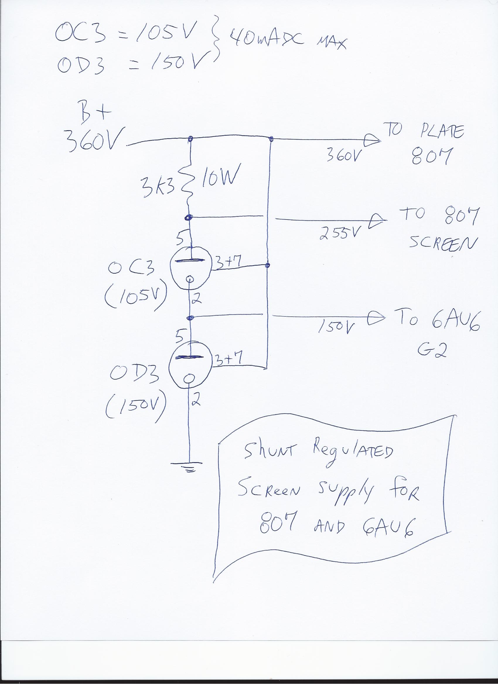

I believe my screen are running out of steam so as a last resort I could buy some voltage reg tube and built some glow tub reg, see schematic I actually took from this forum.
With the 6AU6 in place it looks like one side of the amp is rated 2W and the one with the 12AT7 is about 5W, this would explain the annoying early distortion from the pentode driver...
Thanks,
Eric

You will be getting lower output impedance with the pentode driver - which means better damping and hence better bass control. Often this is perceived as worse/less bass when infact it is an amp-speaker artefact.
Very interesting.
For your screen drive you could try a simple transistor current boost off of the zener string. take the zener node to the base and use a 1K resistor to the collector and the emittor to the g2. Simple.
Shoog

One must leave the driver cathode unbypassed.So far so good.
What you define as richer sound from the 12AT7 could as well be the higher distortion from this one.
As Shoog says "thin sound" could be the better control of the speaker due to lower Zout.
Also the remember 6AU6 is far from the ideal driver. E280F or D3a are great.
The interaction between OPT inductance, output tube cathode cap, the driver screencap and coupling cap can lead to lowfrequency boost. Have you measured both versions?
I simply bought a few 6AU6 because Shoog mentioned he had great success with this tube in Schade amp, maybe I should use a different one (maybe the EL84, I love this tube and have quite a few). Looks like the 6AU6 is running out of steam to drive the 807...but the 12AT7 is doing a fine job despite the bass boost. A agree that there is probably a boost with the 12AT7 this is why the 6AU6 sound thin sounding..my problem remains..time to get my generator and scope to see the reason for such a reduced output power using the pentode driver vs the triode driver. I must have the wrong value around the driver, feel free to suggest adequate values 🙂
Thanks all for your help, I will work on the amp next week.
Eric
FWIW I have built several RH84 with 12AT7 and two with 6AU6. I played endlessly with the op points for the 6AU6 and with regulation ect. In the end I always liked the 12AT7 better. Maybe it was the distortion that sounded better to me but at the end of the day distortion or not what pleases you is what's better no? I would really love to see some plate curves of the 12AT7 with an un-bypassed Rk at this op point, just wondering how pentode-like they might look as hinted to by a previous poster in this thread. As always YMMV, IMHO and so on...
