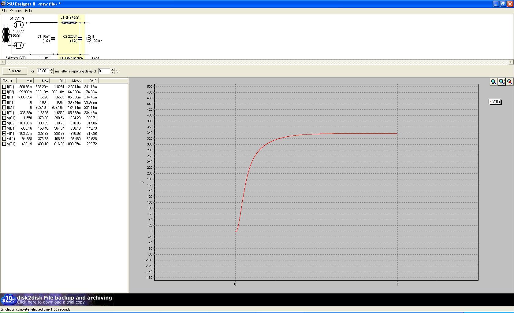

PSUD2 help
So I'm trying to get my arms around the PSUD2 thing for figuring out the power supply for my RH84. I'm pretty sure I'm doing it wrong, or maybe just reading it wrong, but it doesn't look right.
I'm planning on using the 5v4g rectifier, probably the Russian EL84 tubes, and the 6AU6 drivers.
Attached is the simulation and I'd really appreciate any help/explanation you can offer.
Thanks for the quick response; that's just what I needed. Now I just need to know what numbers I want to look for; max voltage? RMS? Mean?
Look at the voltage which the curve reaches, thats your boy.
Is there overshoot or ringing (both bad). If it slowly and steadily rises to a stable voltage then you are good.
You can zoom in on the curve by selecting an area of it, good for looking for ringing and finding residual ripple.

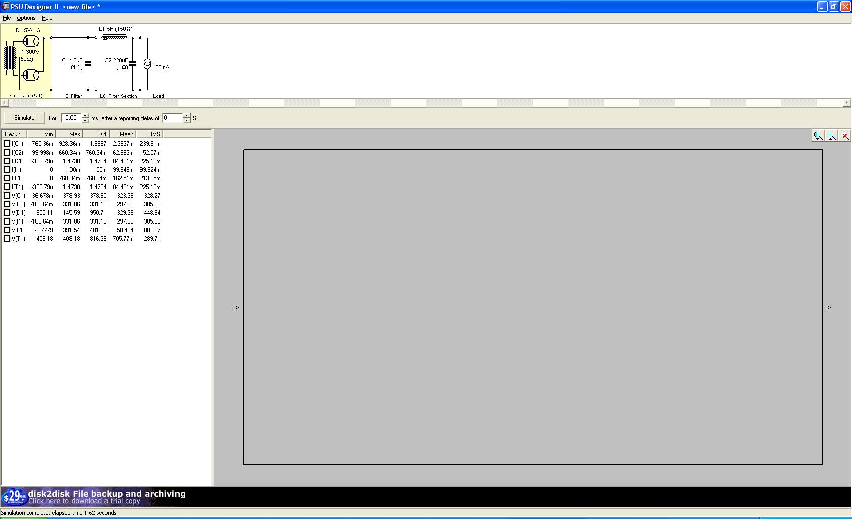

All right, I think I'm getting closer. Next question, I believe I was supposed to be hitting around 300V but for the RH84 but it looks like I'm closer to 330V.
I tried switching the rectifier to a 5u4g, upped the choke, played with the caps, and it still stays way above 300.
