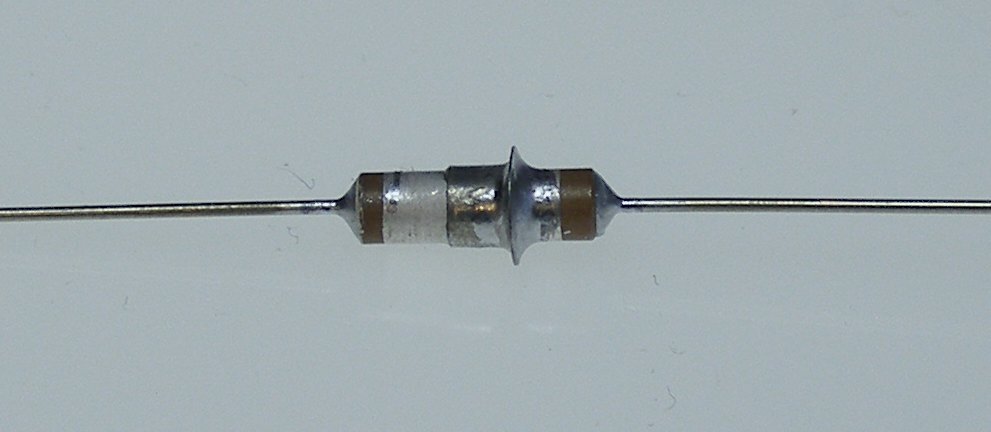

Everything looks different at 2.5Ghz, of course. Capacitors become inductors and PCB traces turn into transmission lines. I had to think back a bit about how tuners were done way back when on 1gHz ham radio gear and TV UHF tuners. The power lines would always be run through feed-through mica caps like this soldered onto the metal tuner case
http://www.ferroperm.com/gfx/news_images/33812006D%283%29.jpg
to keep the RF from getting back on the power supply leads. I went Googling for what the modern equivalent might be (I'm wayyyy out of date) and came up with what chris719 posted about, these X2Y feed-through chip capacitors:
