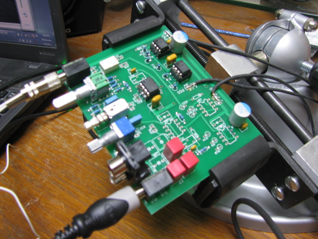

It is true. I had the board below made at iTeadstudio a couple of months ago. The pricing is similar to Seeedstudio and I think the two may use the same board house. Great quality. I paid $19 for 10 pieces of 80mm X 100mm boards (1.6mm, HASL, 2 layer, green), regular $24, a special they had going during the Chinese holiday. Then $20 DHL from China. The 4 day shipping cost more than the 10 boards. PCB prototyping
It is true. I had the board below made at iTeadstudio a couple of months ago. PCB prototyping
that's a handy looking vise you have there. did you modify another product or It came like that?
i'm not sure I would say its great quality, but its certainly very good for the money. if I was doing something for production I wouldnt use them, the screen printing and soldermask can be a little less than perfect sometimes and i'm not 100% sure they do 100% E-test/flying probe testing; but hey its $10!!. or even try seeed, which have the same $10 deal, plus $39 for 4 layer!! which may use the same boardhouse, but they seem to have even better deals. is it iTEAD that includes shape routing in the cost?
some of these services arent quick though, usually up to a few weeks, so doing stuff at home is better if you need to do a one off quickly, or perhaps a larger board, but really there is little reason to do a second generation board at home anymore
