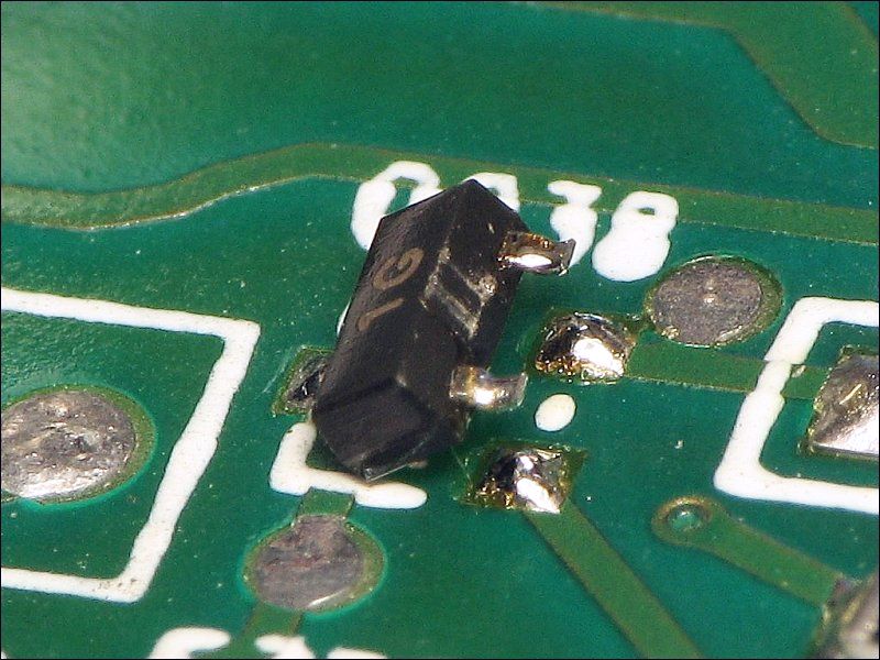

There is a D109 on the back of the board. Do you think you could get to it without removing the driver board?
You just need to lift it as shown in the attached image.
