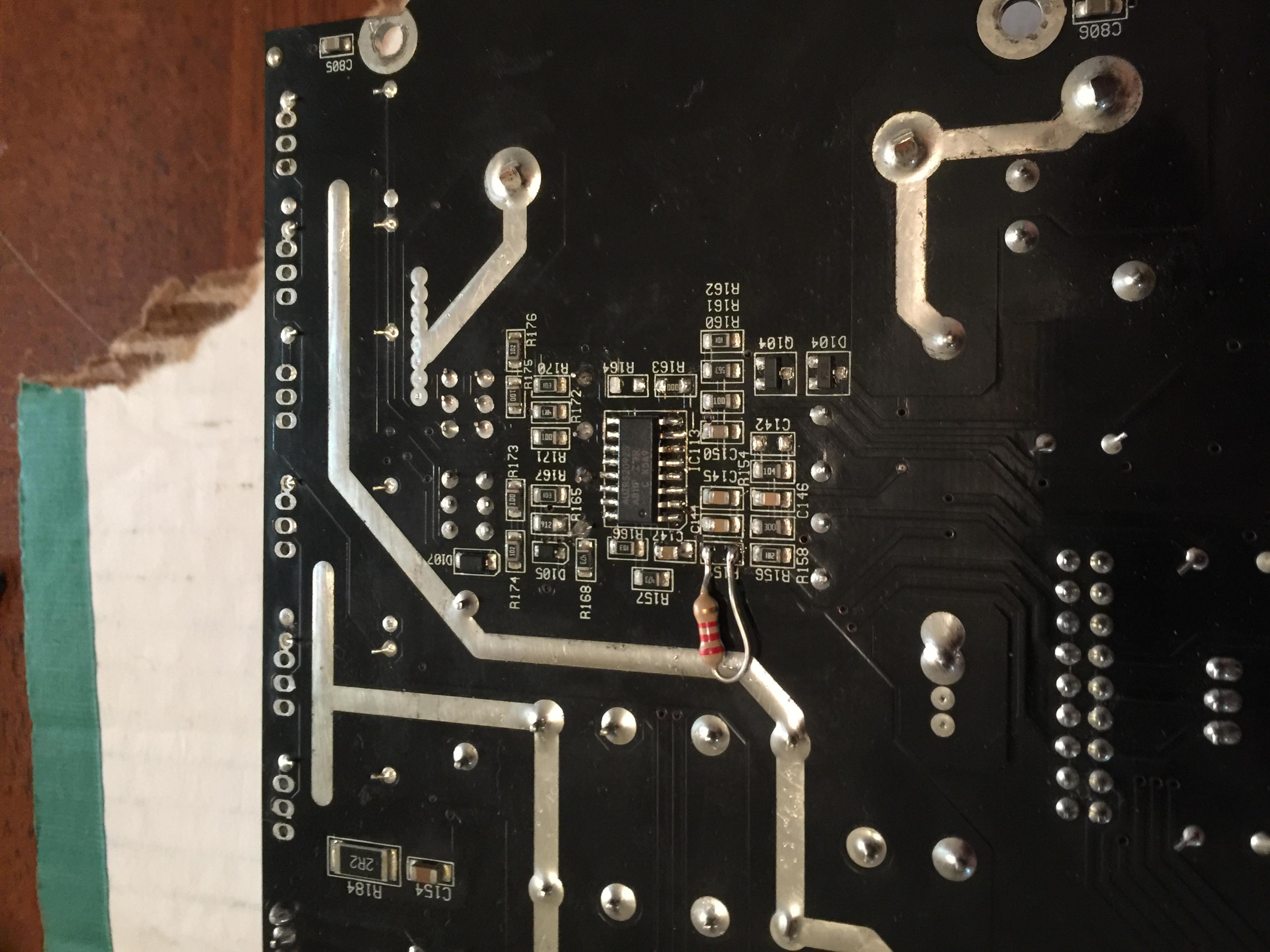

This amp uses +/-5v regulators, they appear to be working fine. But for some reason Vaa is being dragged down at pin 1 of the chip, I’m gonna be really annoyed if they were both bad from the supply house. I’m using the AUIRS2092STR from Mouser to replace the factory unit which was an IRS2092S.

Soldered in a new chip, same result. VSS reads -5v as it should, but VAA is still dropping down to around .8v for seemingly no reason. Attaching a pic for reference, the leaded resistor is in series between the positive regulator and the VAA pin. The regulator side of it is at 5v, chip side is .8v.
Only thing I can think is maybe the AUIRS2092STR I’m using doesn’t like this circuit, which originally had a standard IRS2092S in it. But I can’t think of a reason why it would matter, the spec sheets look identical to me.

Referred back to the IRAUD5 supplement which had a 10R resistor in that spot, and decided to give that a shot instead of the one that was in there. It worked! I now have output oscillation and there’s no DC at the speaker terminals, so I think I’m good to do final assembly. No idea why the resistor I removed from that spot read so high, maybe the old chip shorted and burned it out.

If its a resistor between regulator and Vaa its very high value at 2k2.
No wonder it didnt work.
Not even sure why it needs a resistor.
Not sure why it needs to be there either. It’s possible it had drifted high when the original chip failed and I just wasn’t paying attention to the value when I replaced it, I sometimes overlook stuff like that. I helped in this case to have the additional references though, I measured the resistance between VSS and the neg regulator and there’s 10R there as well. Must be the way it’s supposed to be I guess.

That’s for when VAA receives power from the positive rail, which is quite a bit higher than the 5v the chip is seeing here. I suppose it’s possible the wrong part got put there by mistake as well since the amp looks physically new, I’ve seen stranger things. Haven’t checked the cap, I’ll make it a point to check.
