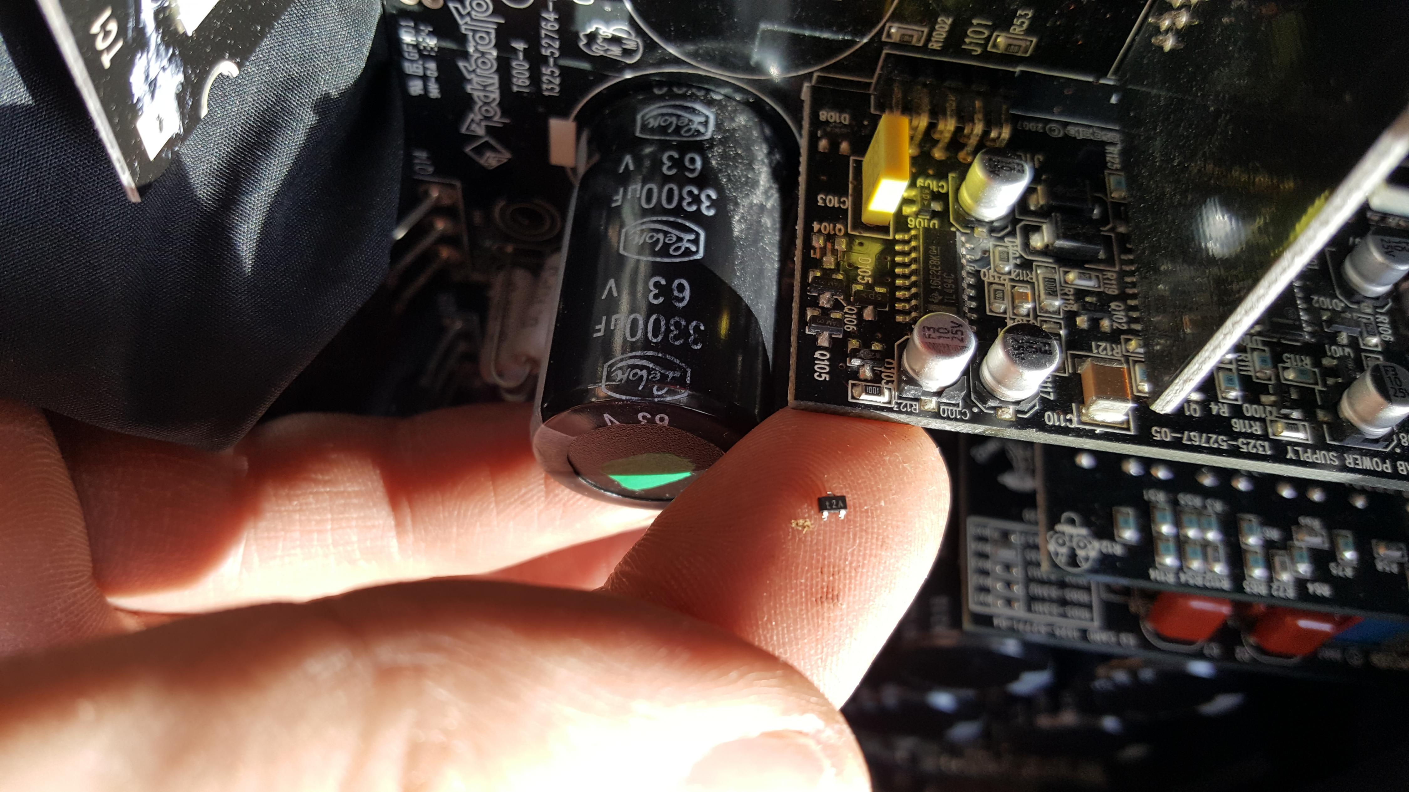

This is the best I can do for a size comparison.
Probably. It's the other PNP driver. It's connected to Q105.
Btw, I was talking about the one above and over, I believe it is marked 103 but you can't really see the number that good. It is the same part number as the one that is removed.
The specs are the same but the case is sot-323 instead of sot-23. The correct one for that manufacturer would have had a PMBT prefix.
The original drivers are the MMBT3904 and MMBT3906. Order both.
Correct, Q103 is the other 2A driver.

If you can make the leads reach the pads, I think they would work but it would be better to have the right ones. If nothing else, you can use them for testing to see if there are any other problems.

Btw, I ordered the correct npn and pnp transistors from digikey. Just waiting now. . .
