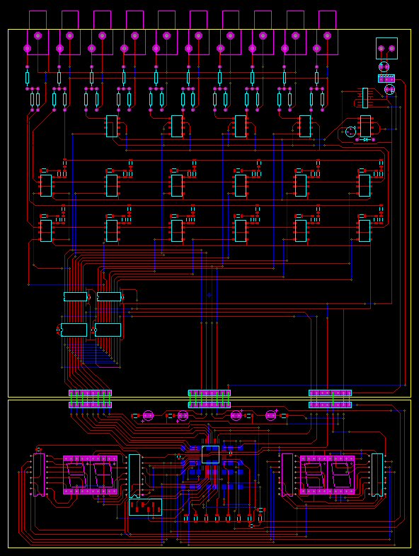

I'm not really a hi-fi guy, I'm a musician, programmer and RF designer, now in enforced retirement following some serious illnesses.
This is what I'm working on at the moment:
...it's a 0-63dB independent-channel microprocessor-controlled relay-switched constant-impedance attenuator and source selector with provision for source and load matching. I'm thinking about giving it remote control and local capacitive touch-sensitive switches and an illuminated front panel to go with the 7-segment displays. It's not that I've got anything against pots, I just can't keep from working on something.
