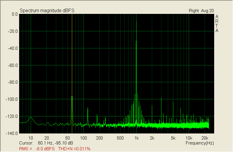

So you have used a FFT which you are happy would show anything audible, agreed? So this above statement can now be changed to "No difference in my FFT, no sonic difference", agreed?
No and no.
No and no.
Oh, you're not happy that your FFT shows anything that's audible? Please tell why.
I can make neither heads nor tails of that mangled syntax.
Let me re-phrase - you have shown two FFT plots from different devices & as a result declared them to be sonically the same, no? If you could stop playing cat & mouse this could be less tedious!
No.

The problem is, TL, you're prepared to contribute plenty in terms of talk or graphics ripped from the stereophile site, but absolutely nothing in terms of practical help.
And not only that, you have really missed the point. Are my posts that opaque? (it's possible) I did not ask for a simply a lower noise floor. I'm asking for a test that SHOWS jitter between -140 and -120dB, but not above -120. That is the type of test that could invalidate SY's. Where is that test? If you've shown it to me and I haven't seen it, I apologize. Please point it out to me again. If it's marked up with arrows and notes, it would really help. Of course it would have to be audible to make a difference.
I take your point about the noise floor and it would be nice to do better, but that's probably beyond the capability of most of us without real lab equipment. (I have seen it done, tho). Below is a 16bit measurement I did last January of the stock DCX. Noise floor looks like it's down around -137dB. But the spurs still rise above -120.

Don't get carried away with the FFT thing. It's just a tool. But it is a very powerful tool and so much more useful than the old standard %THD@1Khz.
There seems to be the idea here that folks how trust measurements think that "If it measure the same, it is the same." That unfair. I sure don't think that. That's like saying "this red brick weighs the same as this grey stone, therefore they are the same." I don't think anyone here would go that far! They may be the same weight, true, but they aren't identical in other aspects.
Taking that into the realm of FFT and jitter. If there is jitter, you will see it as side bands on the FFT. It's that inharmonic distortion that we don't want. If it changes, so will the sidebands. That's not likely to tell you how it sounds, but will tell you if the jitter is different, absent, present, etc. That's all the test is looking for. Is the jitter different.
