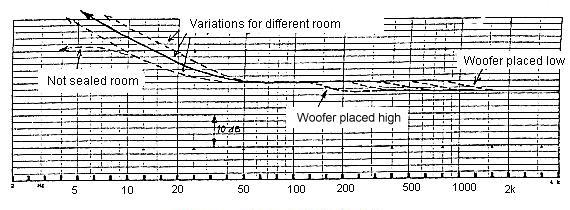

celef Member Joined 2012 2020-04-19 12:15 pm #21 2020-04-19 12:15 pm #21 maybe room gain is the wrong term, but it shows the bass lift caused by the boundary gain and the cavity gain of the room, maybe it should be called "room bass gain" here is another graph i found Attachments room-gain-sd.jpg 43.9 KB · Views: 145
