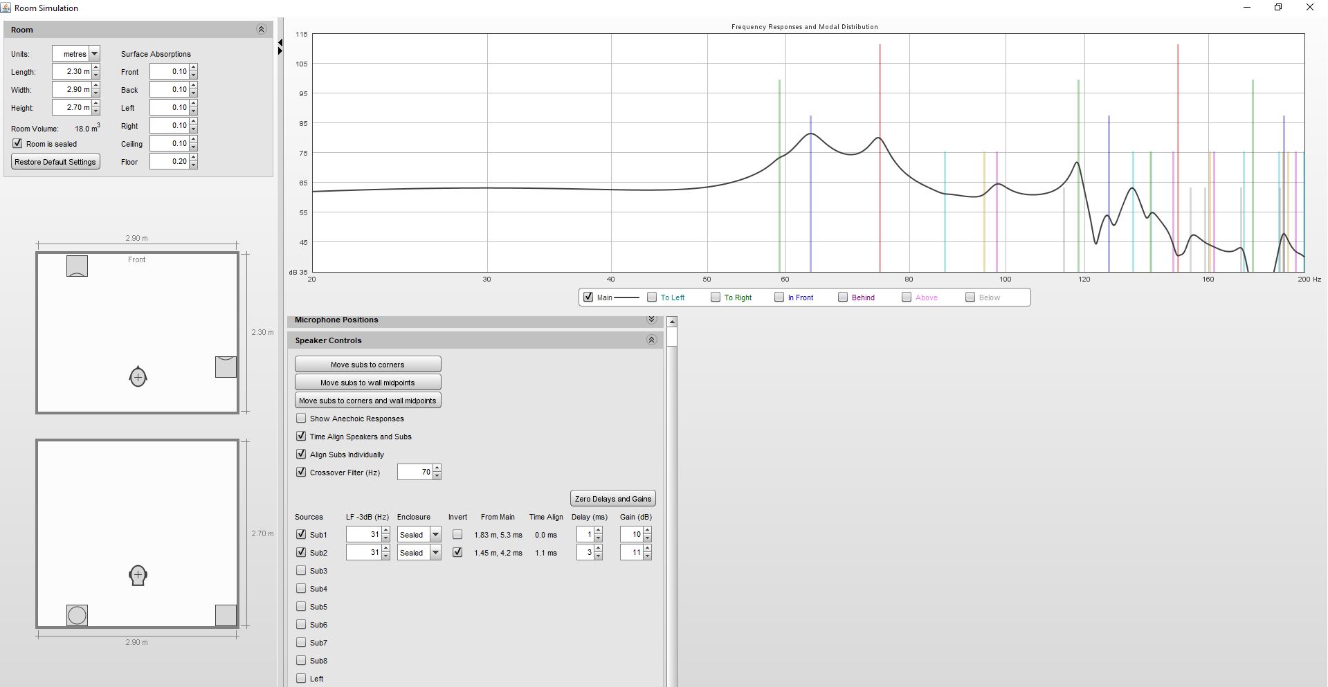

I have a little room (W)2.38m x (L)2.50x (H)2.70m with some acoustic treatment (2" Owens Corning SelectSound® Black Acoustic Board) in the front and back wall, and I am trying to learn to use REW's Room Simulation to get the proper location for my subwoofers (2x).
My questions are:
-. What I am trying to achieve here? The flattest frequency? Or just to lower the modal resonance lines? A peak its better than a null, as it can be equalized?
-. What is a "good" graph? At some models I have peaks of around 20db, and at others it's much flatter but at lower db. Although a total flat graph it's not achievable.
Thanks in advance!

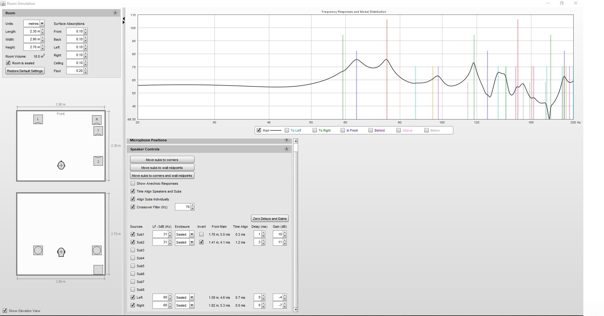

UPDATE. I attached another simulation with another alternative, that looks "flatter", although I have some 20db peaks at 63hz and 74hz that I can't get rid of without messing other ranges with huge dips.
The individual subs will have more issues than the total you want to achieve.
Overall, but for one sub it is ok.
This method is quite idealistic. Change the absorption coefficients and see that the result is easily turned on its head.
No, I'm not saying that. Just be prepared to confirm your results with in room measurements when you set it up.
Yes, of course... I am quite sure this is is sim and not a replacement for true measurements...
But, is it a rough guide to know where to locate your subwoofers? Should I trust it for starters? Also, one thing that I don't understand is that with this sim, co-located SW (or very close with each other) gives a smoother frequency than locate them further away, which is not consistent with Dr. Earl Geddes multi sub recommendations.
I was planning to locate them, both in the front stage, but it seems it is not the best location according to this sim. What gives me the "smoother" freq is locate them in opposing walls one in front of each other on the corner, or in opposing walls and opposing corners.

One thing Earl would say is to start with your mains running as low as they go, and then use the subs to improve the result.
One way to set up these subs is to start with the loudest. Find a spot that makes the response look good. Bring in the next sub quietly. Try to make a small improvement to the existing setup rather than overpowering it.

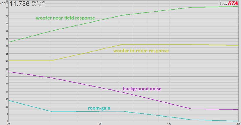

i expect a room gain response similar to this
my own measurements shows a very flat response in the near field, but when moving the mic further from the speakers and closer to where i normally sit the mid (and the tweet) output reduces and the low end remains, the measured response has a tilt and this is also what i hear, but this is not what simulation shows
What puzzles me is using the term room gain. As an effect connected with non-modal pressurisation, I would expect its plot to be smooth, a single phenomenon.
What I notice about the plot you show, is that the curve labelled 'room gain' actually appears to be the difference between the in-room and the nearfield response. Ie an amalgum of modal effects. This also could explain the reason Colloms labelled his plot 'Average' room response.
