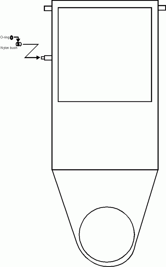

Thanks buddy, but... My B-226S has that O ring and bushing in your drawing right at its location all right. Probably, I need to flip the draw over and check the other side...
Also, the CD transport in this 226S is CDM1 Mk-II (flat aluminum platform with rectangular grids on the up side of the transport), but should it be CDM1?! The previous owner(s) obviously had a great idea: a small spring to lift the arm a bit and duct taped the other end of the spring on the aluminum chassis...

The b-226S had the cdm-1 mkII and sometimes the later cdm-4 version so it is probably original.
Be careful of the alloy casting when dismantling. They are VERY fragile . I am looking for one for my B-126

I have just disassembled my B-226 for the general overhaul. I am afraid that the O-ring which goes together with nylon bush on the clamp mechanism is missing. The transport still opens and closes smoothly but I would like to find a replacement and fit it back in.
Does anybody have dimensions (i.e. outer diameter, inner diameter, thickness) and maybe a of the part in question? Is it just a washer of proper dimensions? Thanks in advance.
