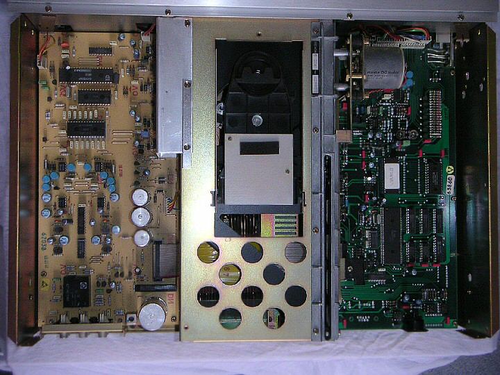

OK, I finally have some time to take my 226-S apart and checked the burned transistors on the 126 DAC board. The following things are what I have found so far...
1. in my B226S (got it recently from a Canadian folk: http://www.canuckaudiomart.com/details/109659-revox_b226s__b226s_cd_player_with_remote/), the transport used is CDM 4/26, and the height of this transport is too high, so the puck arm will sit right on the CD and create some scratching noise! I am not sure whether it is the original transport or has been replaced...
2. in my B126 (got it from audiogon.com): the failed transistors and diode are Q1 (BD136), D5 (1N4448) and Q5 (ZTX651). And they had been replaced by BD140 (I agree with no problem about this substitution, however, the de/soldering work was done very poorly: missing PCB copper trace and been replaced by legs of this transistor. D5 was replaced by 1N4148 (not the higher current equivalence 1N4448), Q5 was replaced by some TO-92 packaged transistor. Since Q5 burned out, I could not tell the number, but I am 1000% sure it is not ZTX651/653!
These 2 players in total costs me more than $1K, now, I need to change almost all parts (caps, transistors, diodes...) on 126's power supply circuit, and hope that the transport is still alive. However, regarding my 226S, if I can manage to make my 126 back alive, I will try to swap the transports. If the transport from 126 can be used in 226S, then I will try to find a "organ donor" to get the transport. Otherwise... My 1K is down the drain.

SteveSun said:................ in my B226S....., the transport used is CDM 4/26, and the height of this transport is too high, so the puck arm will sit right on the CD and create some scratching noise! I am not sure whether it is the original transport or has been replaced...
My B126 also has the CDM4/26 but my B226S has the cdm1 mk2.
It will be original.
CDM4s are fairly plentiful and cheap on Ebay and are fitted to many Philips/Marantz models (see
http://www.marantzphilips.nl/the_complete_d_a_dac_converter_list/ )
Andy

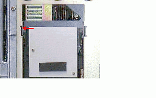

OK, the "puck" problem is solved: I took out the "arm" carefully by squeeze the hinges and push toward the back... Guess what?! There is another plastic "rail holder" on the arm with his shoe missing! Put the shoe back into the correct location, slide the puck arm carefully from the back into the position (align the rail holder first, then push it carefully toward the front), the arm is back to its normal position.

I have just disassembled my B-226 for the general overhaul. I am afraid that the O-ring which goes together with nylon bush on the clamp mechanism is missing. The transport still opens and closes smoothly but I would like to find a replacement and fit it back in.
Does anybody have dimensions (i.e. outer diameter, inner diameter, thickness) and maybe a of the part in question? Is it just a washer of proper dimensions? Thanks in advance.
