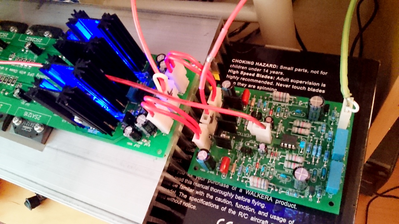

Soldered the 2-nd channel of the VERTICAL front-end. Just exchanged with the 1-st one - works perfectly right away. Singing on a test bench with the main speakers now.
Jeff, I did some testing with the input disconnected - there is a little bit of noise, but very minor one. I recognize the difference only when my ear is close enough to the speaker. Then, when I connect the pre-amp (being off), it becomes silent, with barely recognizable hiss, and then after powering the pre-amp on, it's not even silence - it's nothing 😛

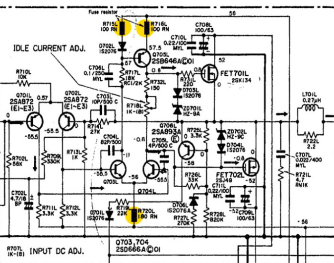

Probably yes. "The Hitachi HMA-7500 Mk2 (MOSFET outputs) had the ‘super linear’ feature, and also a ‘distortion servo’ which appears to be some kind of error-correction. It is claimed that the latter reduces output-stage distortion by a factor of three. The HMA-9500 Mk2 (1980) used a ‘super linear’ nonswitching circuit in a different form." - Douglas Self Audio Power Amplifier Design - p.94.

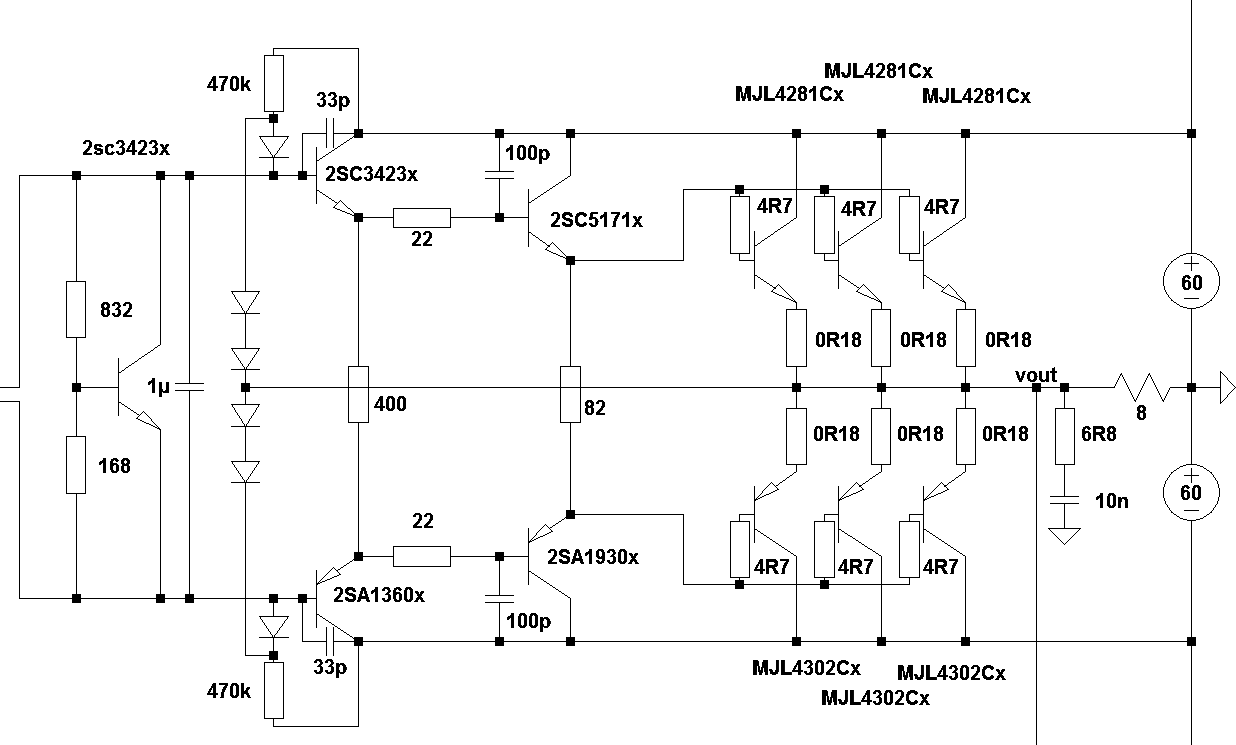

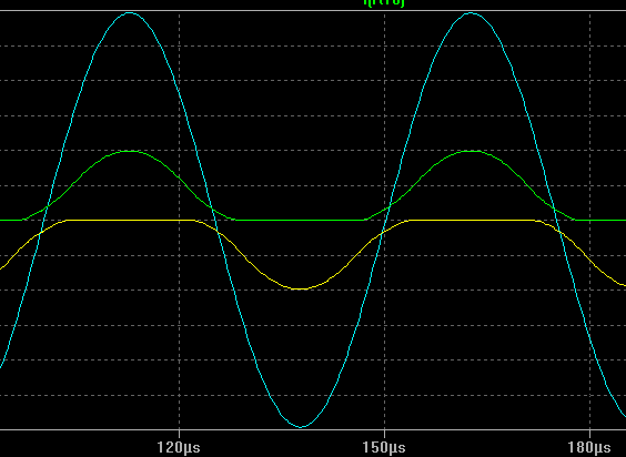

I tried this simple one in LTSpice with my current EF3 OPS:
http://www.diyaudio.com/forums/soli...imate-fidelity-amplifier-124.html#post4607602
But it's not working for me... How it should be adjusted to use it with an EF3 OPS?
I tried with 3-3 diodes and with different R values but there is still 0mA at the closed BJTs...

Oh, I see now, it's still a switching OPS just there is a smoother transition at crossover, right..?
I managed it only with 5 1n4148 with EF3 at the pre-drivers and with 47k resistor.

That's why in my NS-OPS I use more precise thermo-compensated voltage reference (the right Vbe spreader), that is fine-tuned in particular environment for the minimum distortion.
And how a NS-OPS should be tuned? Directly measuring it with THD/IMD?
The rough tuning method is described in my "Buildind instructions" paper here:
NS-OPS project page
It gives good enough reslt. For those, who'd like to tune with really high precision - yes, connect THD meter and tune for minimum distortion.

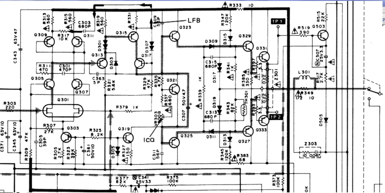

Try Technics NS OS from SU-V5 amp.
Yes, this one will work pretty well, Clamp diodes must be fast for the best result - I used 1N5711 Schottky ones.
Standard crappy schematic for japanese amplifiers (pioneer, jvc, technics, yamaha, sony and etc.) from 80s-90s.
Well, it works, it's just not flexible enough for fine-tuning.
Clamp voltage is set by MA27A2 double-diodes, which are impossible to get these days. I use the spreader - same as the one in SU-V8 - in this case I can set the clamp limits the way I want.

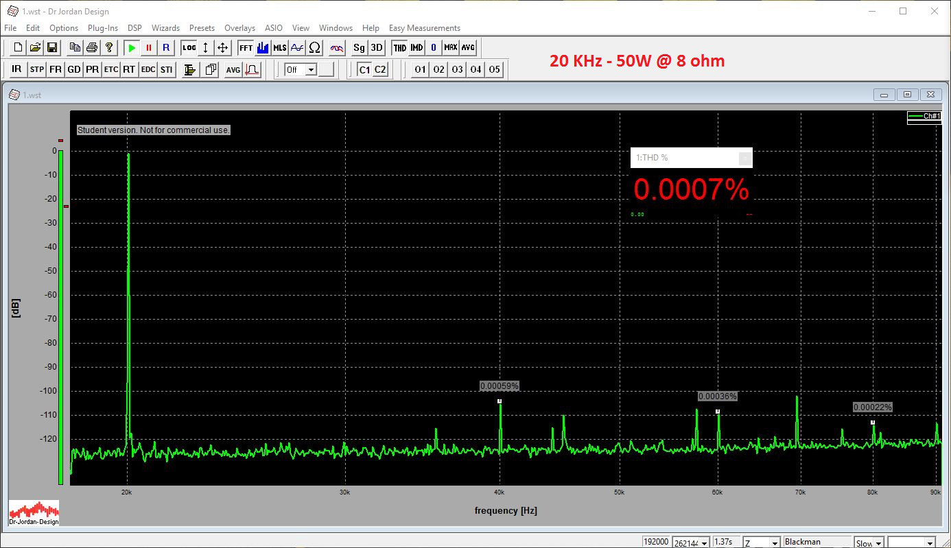

Hi Paul,

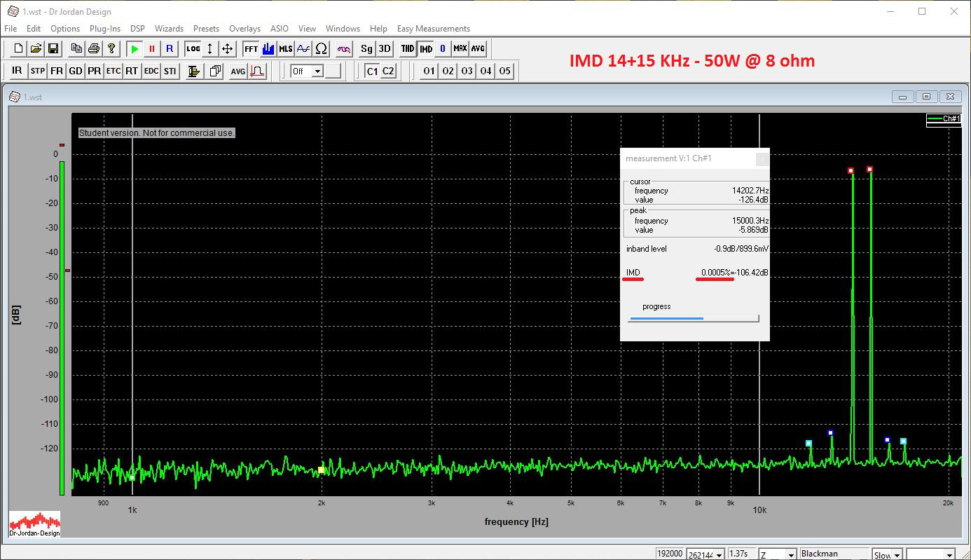

The bias clamp mechanism, I use in my NS-OPS, is arranged between the pre-driver and driver stages of 3EF follower. It reduces the overall distortion level significantly - magnitude of an order. See a rather detailed description and live measurements on my web site (the link below in my signature - both NS-OPS and VERTICAL projects). Here are just the key spectrums in combination with my Vertical front-end (attached).
Let me know if you will have questions 😉
Valery
