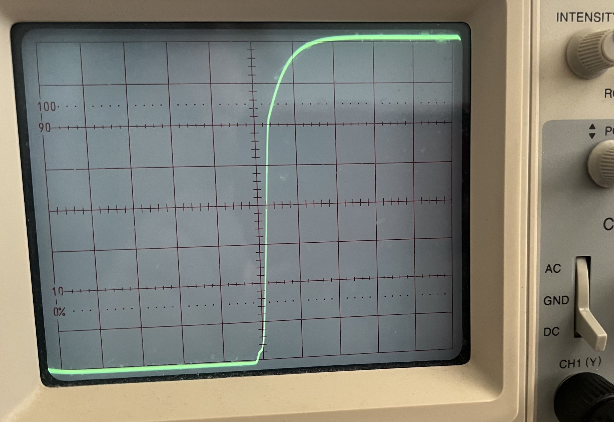

Here is a test waveform with an Exicon lateral MOSFET. The rise time test is an ECX10N20 driven by 0 to 2 volt (no negative zero crossing) square wave at 100khz , with a 470 ohm drain load from a 42 v power source. Scope is at 5v / div for detail. The tiny step at the start of rise is because there is no bias when signal source is at 0. I wanted to see the characteristics from a zero start. It is one fast device.
Those were good parts. Unfortunately they fell a little short on current. The half amp rating was ok for hifi receivers and integrated amps, and of course hobby builds, but at least 1.5 amp rating would have been needed for professional amplifiers. They had the 8 amp devices, I never understood why they didn't make a driver with an amp or two rating.In the old days I did similar driver tests and found the hitachi LatFETs 2SK213/2SJ79 being superior to bjt drivers. I used one pair of these to drive 36 pairs of Hitache TO-3 laterals in a 5kW Monoblock. Sadly these latFETs disappeared from the market for a long time.

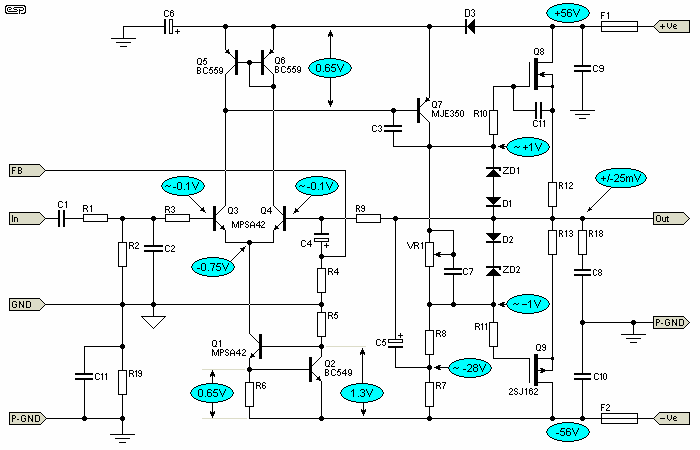

In reference to the ESP P101 amp build. Output osc. discussed by Rod E.
"Finally, the output section uses a conventional Zobel network. If desired, this can be followed (right at the speaker terminals) by a small inductor with a paralleled resistor, and finally a second Zobel network at the output. This is intended to decouple the amplifier from highly capacitive loads and ensure stability under all normal operational conditions. The use of ultra-low inductance (very high capacitance) speaker leads is not recommended, although the additional output network described will prevent oscillation in most cases. The inductor can be quite small (around 5-10µH is about right), and must be shunted by a parallel resistance of between 2.2 and 10 ohms (10µH gives a -3dB frequency of 71kHz with an 8 ohm load)."
Since I'm using double dye T03 Exicon outputs mounted on the heatsinks and hardwired (about 5 inches) to the boards, I thought I would use his suggestion and wire the parallel inductor and resistor (5uH / 5 Ohm) at the speaker terminal. What would be any downside to NOT using the second
Zobel. Duplicating R18, C8, and C10. I'm assuming that is what he meant by a second Zobel at the output.
Is there an online calculator for determining the -3dB cutoff freq. as Rod did?
