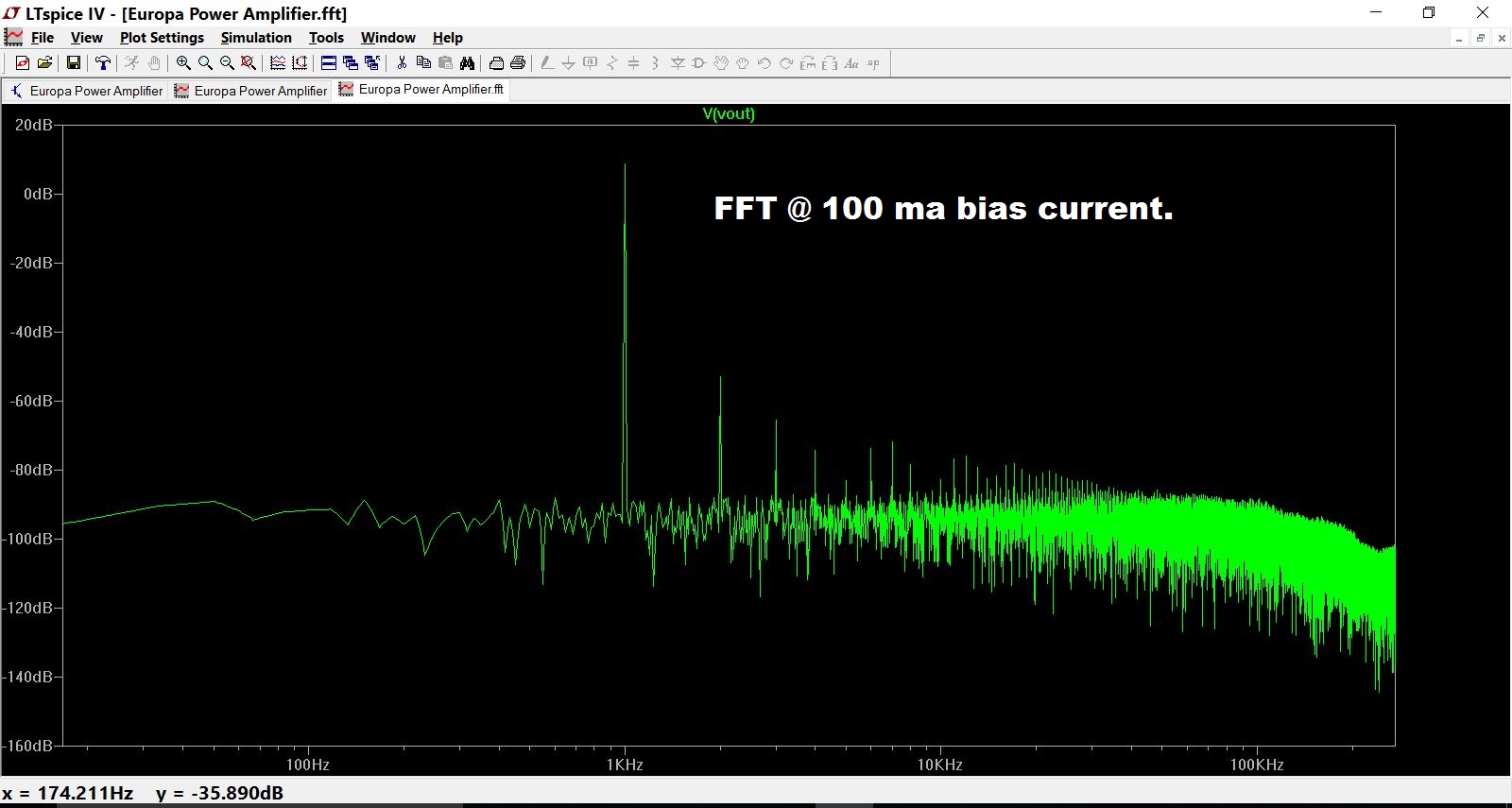

So I thought it might be fun to simulate this old timer and present the results here. The original used BC109C for the input stage and BFY56/BC461 for the drivers. The details in the magazine gave no insight whatever into the design other than how to adjust the bias and midpoint voltage. The distortion at 1 watt/8 ohms is around 0.08% but the FFT at this level shows a 'nice' structure.
So was it an inspired design ? or just another also ran from an era that gave us the like of the Texan and numerous other offerings.

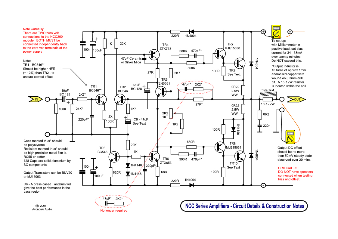

Interesting to see a long tailed pair input on a single supply capacitor output amp. However weird this one is with the darlington. Apex AX6, Armstrong 621, Leak Delta70, DynacoST120, Basic50 , maona 5555, TGM8, all use emitter resistor feedback on the input. Only m2rac repaired 2n3773 amp (a commercial design origin not named) and Panasonic SU380 use LTP. I'm a bit interested in the darlington, I need >100k input resistance for compatibility with a PAS2 preamp and only ST120 has it, due to special input transistors BC108C no longer stocked for sale.

Thanks, that is interesting. I've a vague recollection that the Europa specified a tant for the feedback cap, and I see your diagram also mentions a tant is best. You wonder... you really do wonder where and how these designs originate and how ideas filter down.

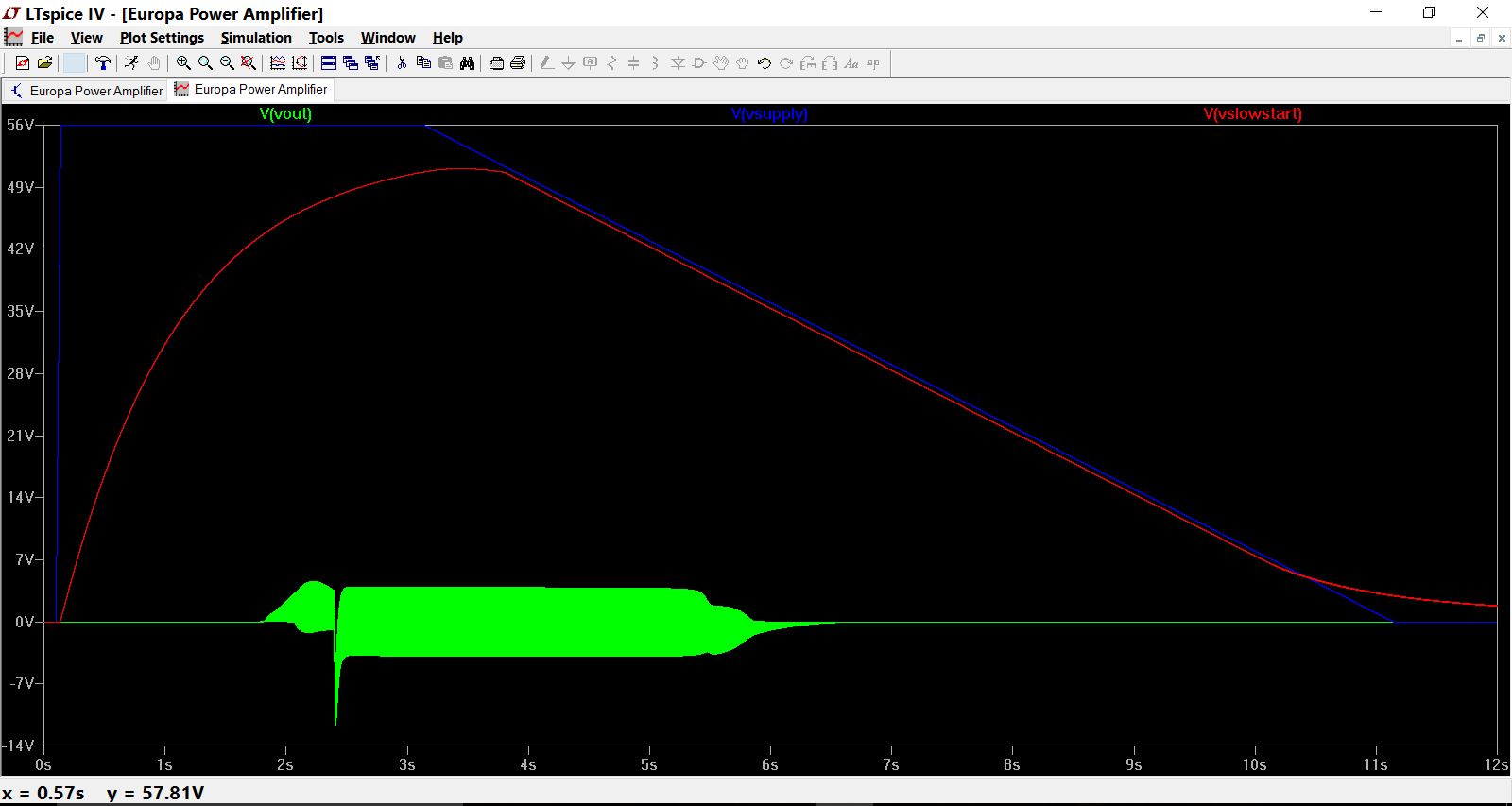

It may be a difficult question now but do you recall if your Europa amplifier was near enough to silent at power-up/down?
OK, so here is the output voltage as the supply rises and falls at power on/off. 'Vslow start' is also shown which is the emitter volts of Q5. The input signal was that needed to produce 2.83vrms at the output. Switch off is very well behaved. A little glitch at power on.
Thanks Mooly, those time constants could be worked on if need be. I haven't found the PW issue in which the Europa article appears but I did see 'Mr' Toms had some influence at PW and is credited as a consultant from F.K. Electronics, whoever they were. He also contributed to another variation on that design with slow start, and odd Darlington LTP at page 674 here: http://americanradiohistory.com/Archive-Practical/Wireless/70s/PW-1975-12.pdf.
