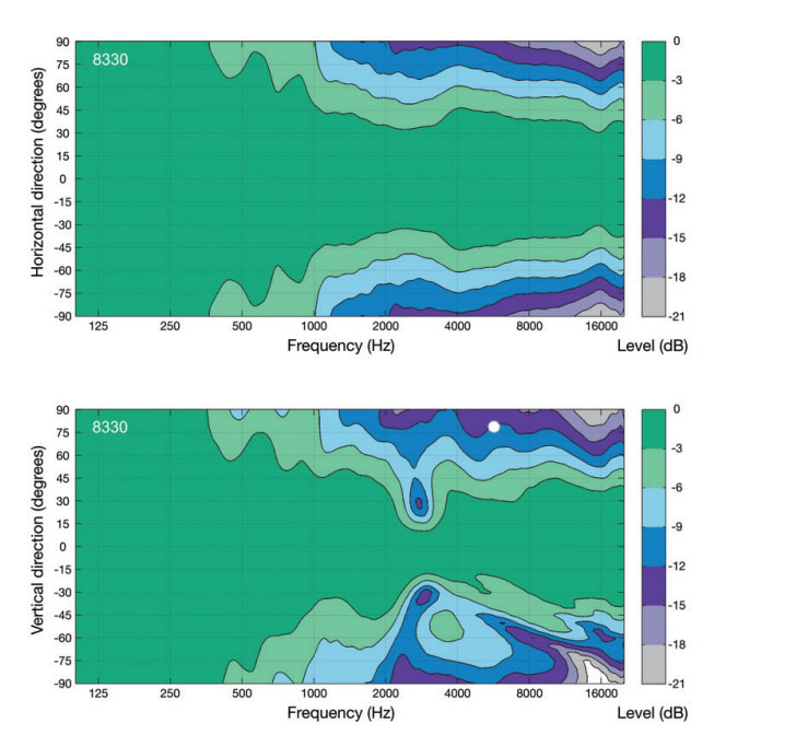

Revisiting TMM vs MTM vs TMW in Vituix...now that I am understanding better what I see in the polar...all 3 of those configurations seem to have comparable polar width on the vertical plane...
🙄 :whazzat:
I know a document i sent you a year ago where their is evidence this is not this simple ( hint: Dave pointed you the track). 😀
all else the same...yeah it is...keep spacing the same, same XO....go from TM to MTM just add another mirror polar at XO....TMM the vertical sweet spot is about the same beamwidth as TM and MTM....
Polar width is likely too crude of a word to use...to be more exact...the vertical sweet spots are comparable between the 3.
I know I am leaving out a lot of other details...but if its not in the sweet spot....its not that important is it? Yes, I know, even off axis response, is desirable...but on the vertical plane...this aspect gets neglected a lot from what I've seen....only MTM would offer a symmetrical polar on the vertical axis yet its still no where ideal.... non of them are idea until you move the XO down to where the centre-to-centre is less than a quarter wavelength of the XO.
A document you say....teaser lol
If its not under a quarter wavelength then its wrong. lol I'm just being overly critical about it...of course we set standards and try to stick to them....10-15+/- degress at XO is fine for genelec its fine for us right!?
