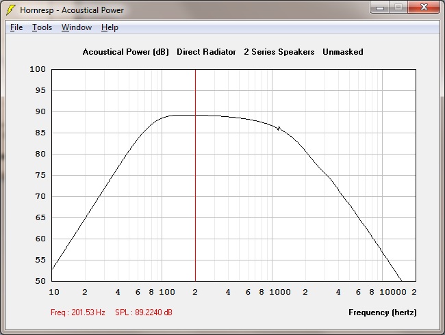

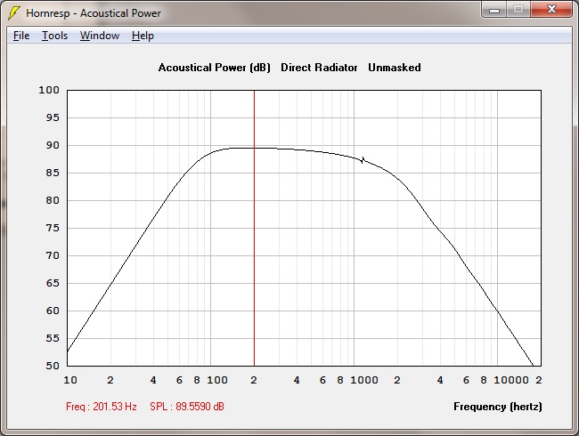

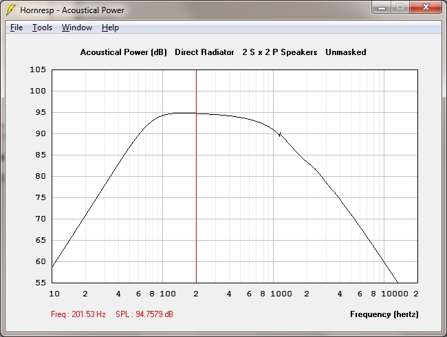

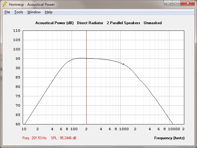

These are a few HornResp sims for different driver configurations in a closed box in 2Pi space. The SPL is indicated by the red line and number at the bottom of the graph. There are also a few pics of models built and tested. This holds true for ABEC3 / AKABAK3 BEM simulations as well.
As you get closer to the floor, or wall, or corner you will reduce the radiation space from 2Pi to something less so you can get some more LF gain.
That's interesting. I'd like to see actual measurements of those systems.

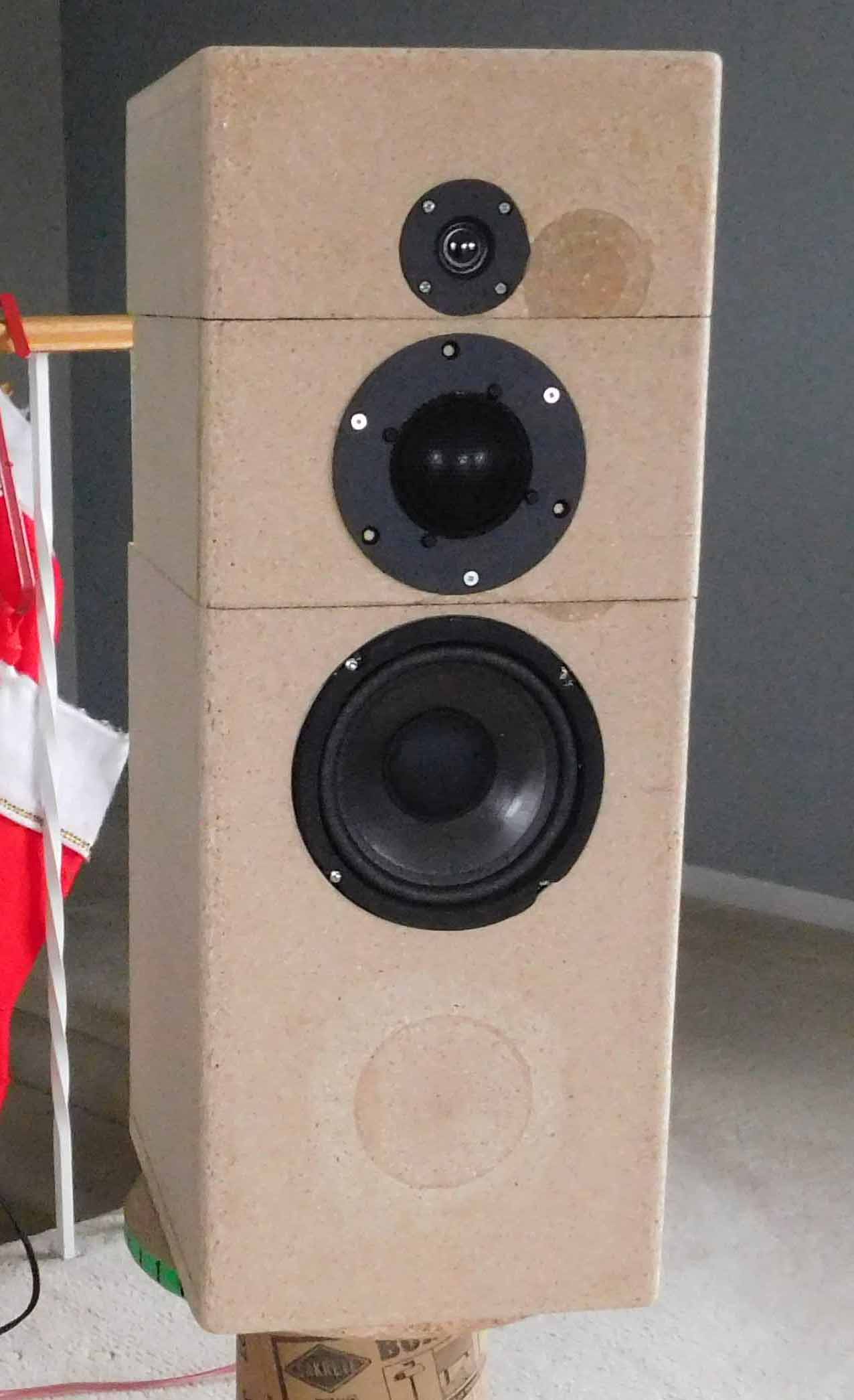

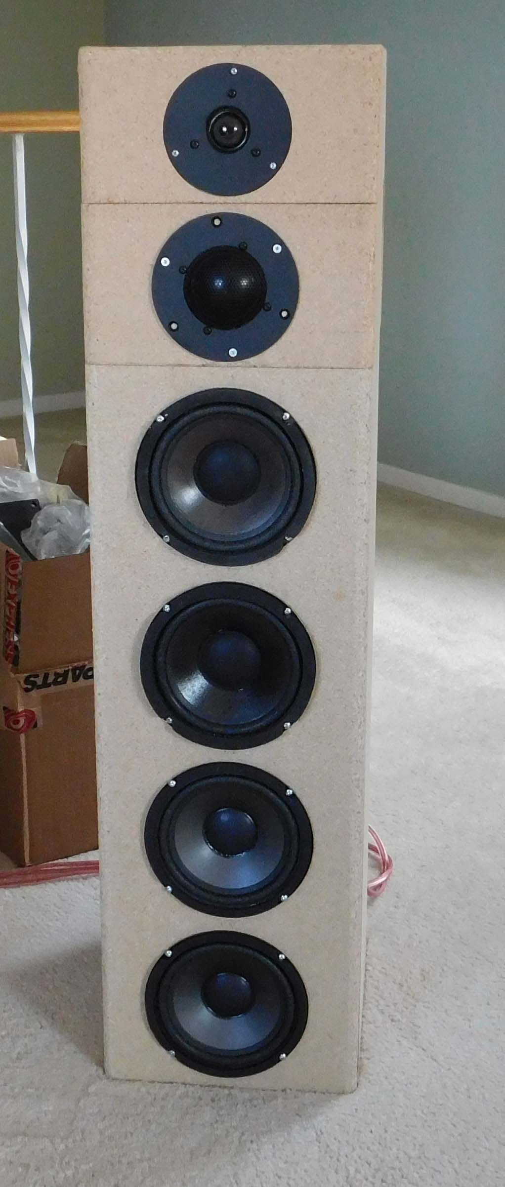

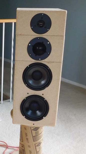

Measurements for my active 3way evolution are at Modular active 3 way - work in progress There is an index on pg1 because the design is still evolving as I try to improve it. Different woofers configurations were sim'd and tried attempting to improve midbass and reduce floor bounce.

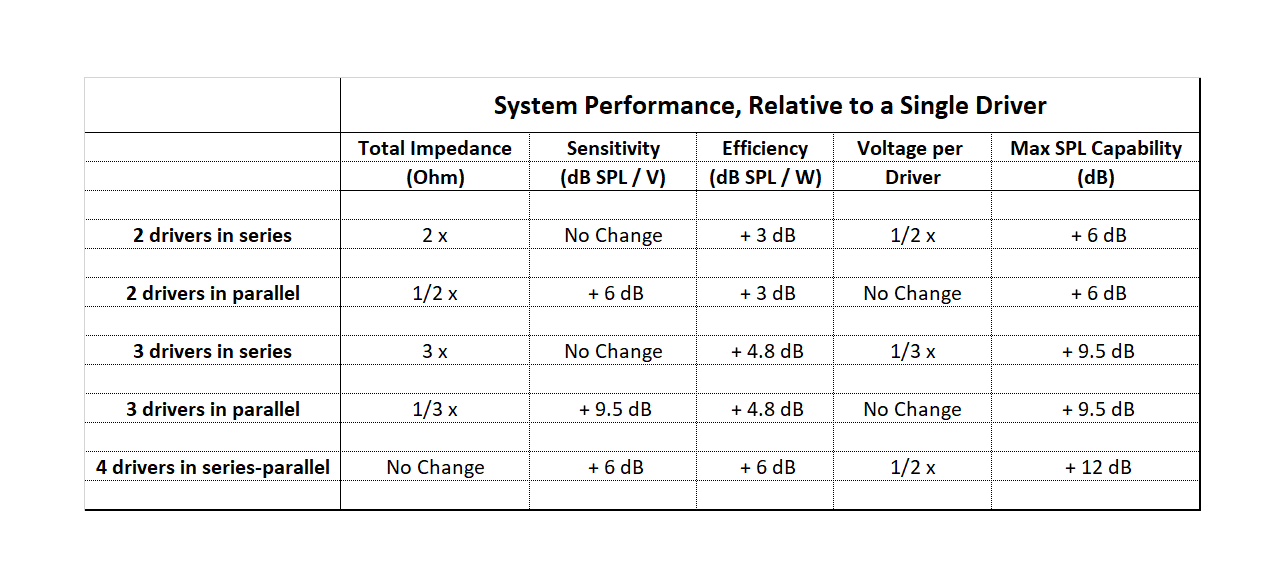

dB(V) = C*20*log(V), I’m too lazy to look up the value for C. But each driver drops 6dB in SPL. Not 3.Wire in series and get 2x resistance (1/2 current) so -3dB electrical drop
Scott and i have been doing some work on possible 3 driver connections, isn’t parallel connection +9.77 dB? (can’t check, looks like i lost [the contents of] a file)
dave
Nope. They are coherent at long wavelengths, so +0dB. ‘Nuff said...remember, there are 2 drivers so (-6dB + -6dB) =-3dB
1 driver, Power = 1 W, 20Log(1) = 0.0 dB
2 drivers, Power = 2 W, 20Log(2) = 6.021 dB
3 drivers, Power = 3 W, 20Log(3) = 9.542 dB

What if you connect 16 8 ohm drivers in 4 parallel chains of 4 drivers series each 32 ohm making system back to 8 ohm. I cannot for the love of god understand that there will be any higher system sensitivity only 1/16 movement pr driver pr watt and of course 16x power handling and max SPL. Energy cannot magically appear.
Each driver will have 1/4 current and 1/4 voltage giving 1/16 power.
10 x log(1/16) = -12dB per driver.
16 drivers = 10 x log (2^4) = +12dB.
Sum 0dB sensitivity gain.
Only way to increase system sensitivity is to reduce system resistance.
