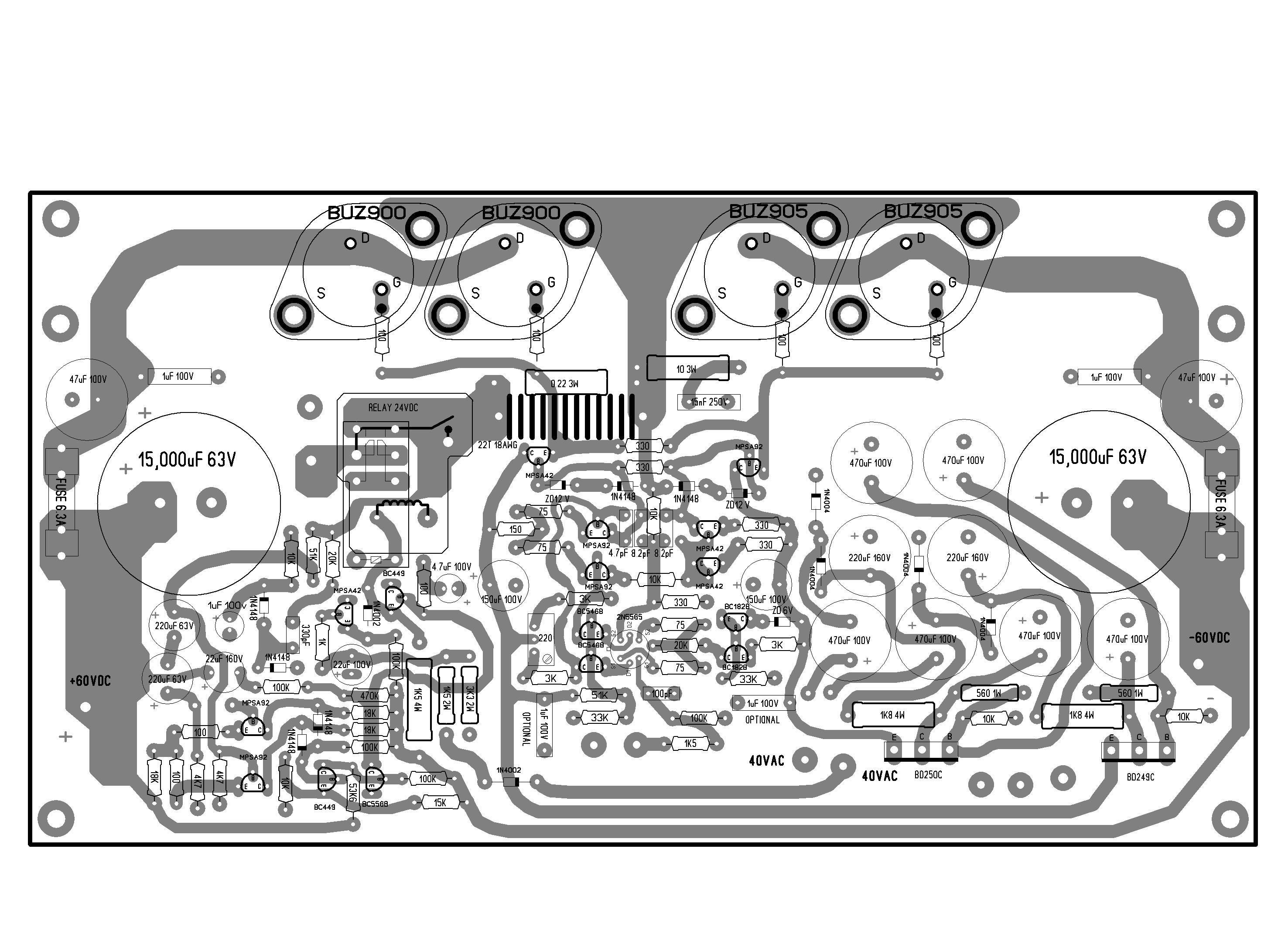

Dear friends:
Here is a new thread.
Purpose: revision of the existing thread
http://www.diyaudio.com/forums/solid-state/174468-very-best-amplifier-i-have-ever-heard.html
I will ask this with total kindness:
The mentioned thread was very confusing for many members like me. Of course it is full of good knowledge and wise people. But many members are fond of selfishness and some others have been mocking arround.
Please be so kind to contribute with an open mind, avoiding mysteries and sharing knowledge, with a real hobbyst point of view. That's is what a forum stands for: help each other and share good information.
Lastly, please upload schematic diagrams and try to clearly explain what you think and/or suggest.
I bought 2 original boards that work with just 4 MOSFET transistors as power output (not 3). I suggest to start with this first schematic and try to stick to this.
I suggest to order this first part and then we could jump to many other ideas and circuit revisions. But I kindly ask not to fall in the other's forum disorder .
I am uploading the original schematics and board drawings as NagysAudio provided.
Any suggestion is very welcome 🙂

Some useful information (kindly sent to me by NagysAudio by email):
Here's a complete list of all the MOSFETS and equivalents that can work in this amplifier:

Attached is a copy of the schematic I made trying to put the circuit all together. Needs revision and I hope that somebody could help and tell if the protection circuit is correctly drawn.

This is the complete transistor reference list for the Goldmund Mimesis 3 amplifier. I won't include another one, so please print this one out. The hardest part to find is the 2N5564/2N5565/2N5566 dual j-fet, as they have no equivalents. But if you do some searching online, you should be able to come up with a few more sources than the ones I've listed above.
The MOSFETS you'll have to match. I cannot help you there as I do not sell any parts, nor have any of these MOSFETS in stock myself. You might have to order a few extra ones in case they don't match up too well. If you need the correct procedure on matching MOSFETS, please do a search online, there are hundreds of references.
Everything else you should be able to easily find on Newark, Mouser, DigiKey, Farnell, eBay, etc.

It's good. Like it. 🙂
Subscribed!
Thank you Karl vd Berg, you are very welcome ! BTW my eldest son is now living in Amsterdam since a couple of weeks, he was hired there by a big company. Such a beautiful country.
There are some errors or omissions on the PCB tracks, for example, only one side of the relay coil is connected.
I don't think so......🙄 I'm the PCB designer and layout it's OK , it's working as it is .......There are some errors or omissions on the PCB tracks, for example, only one side of the relay coil is connected.

@obiwankenobi
Sorry but your schematic not so good ...... some errors, need to be corrected .
Why you don't use original schematic?
Alex, I assume you must have a set of different PCB designs dating right back to 2010 to the latest one you posted on 2nd December? It would be extremely useful if you could post each design in turn with accompanying schematic and brief change log of what has been altered and why (and if it's tested and working). If you cannot remember why all changes were made it would still be valuable to have the change list with accompanying schematic.
Once we have identified all the changes we can verify these are correct through to your most recent design. You could maybe make seperate posts for each revision and edit and add accordingly as we work through the changes. This would give some structure to the project and everyone can refer to this as a base reference for each version they have.
Nikosokey, it would be very helpful for all of us if you would do a brief write up with your schematic attached (so we can reference this to one of Alex's uploads). If you could explain any changes or problems you faced and how you solved these (briefly) this would be an excellent resource.
Likewise if would be useful if anyone who has built a working revision could do the same and we'll start to have a working structure for all persons 🙂
KatieandDad please are you talking about the PCB layout of post #1 ?
Alex mm , did you designed this PCB of post #1 ?
I would like to kindly ask everybody to stick to the original model of 2 power output MOSFET's , because this is the reason why this thread was started. Please be so kind to read the #1 post. The idea is to put order for those who have this PCB model, despite we can later get into details for changing it to a better version.

Hello matteos, we are trying to put order on the 2 pair output transistor model first although I think that somebody has designed a 3 pair version and could possibly sell you the board.
Hello matt09 , yes I agree with you about posting both design + schematic. I think that this is what it went wrong in the other thread and ended in a complete mess.
Anyway, could you please help me finish the 2 pair version for those who have the boards ?

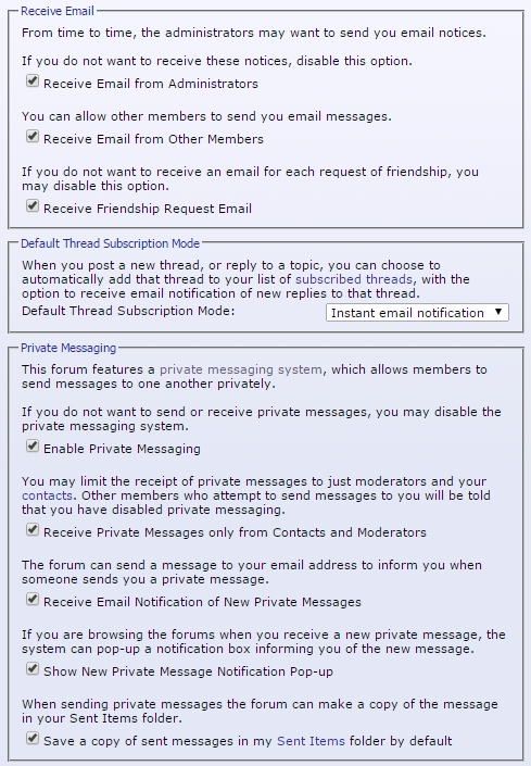

Roberto, is your PM box blocked?
Let me check Karl ... I'll be back to you.
Thank you
Karl it seems to be operating.
No incoming messages.
Status attached.
You can use my email microlatina@gmail.com anytime.
Thank you
