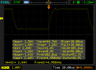

Right now I have installed Manley EL84M tubes and 6N1P-EV in the input. The front tubes look nices, but the sound is not much different.
I also changed all wires to silver and installed a fuse in the transformer primaries (1A slow). You should really be doing that. I knowthe fuse and its holder will add costs, but is a must to have.
The coupling caps are bypassed with silvered mica and the supply caps are bypassed with WIMA MKS and WIMA FKP.
The last mod is not tried yet on my main system. I will also swap the EL84M for NOS Philips EL84, see what that does. The sound is very rich and has a huge soundstage (really 3D), but is not as delicate and detailed as Peter Daniels INT-1.
Maybe it is the lesser control of bass that the tubes have in comparison to the INT-1.
As a bonus here is a square wave of 5kHz into 8Ohms 🙂
