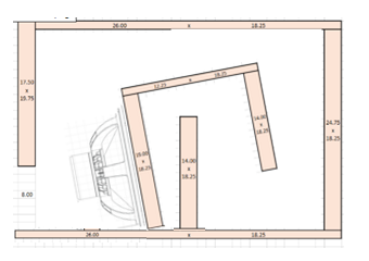

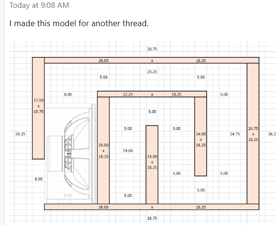

I made this model for another thread.
is this a TL or a TH, asking cause on most of the TH designs you see expanding areas, hence the Horn name,
BP1 drawing do not have any expanding CSA
all bends are 90 degree angles.
i roughy modified with MS paint his sketch to add the expansion CSA
this is a "nornal' TH
any sim differences between one and the other ?
better efficiency ?
or just easier to build as there are no angles
View attachment 1418421 this is a "normal' TH
better efficiency ?
Stepped TH.
Technically, it's a positive flare TH since the CSA goes from 18.25" x 5" throat to 18.25" x 8" mouth.
TL = constant expansion = sims in HR as a round pipe whereas a TH is expanding even if just a two step pipe and if the expanded pipe is at the closed end = inverse TH or often (mis) labeled as a TQWT.
Negative flare TH = Tapered-Tapped Quarter Wave Tube or Pipe (T-TQWT or T-TQWP).
Straight flare TH = Tapped Quarter Wave Tube or Pipe (TQWT or TQWP).
Reactions: GM
Hofmann's Iron Law...efficient, low, small...pick 2.
Positive flare TH = efficient & big.
Negative flare TH = low & small.
Straight flare TH = ease of build, no angles.
A stepped TH eliminates the angles, but Hofmann's Iron Law still applies.
Step up = efficient & big.
Step down = low & small.
