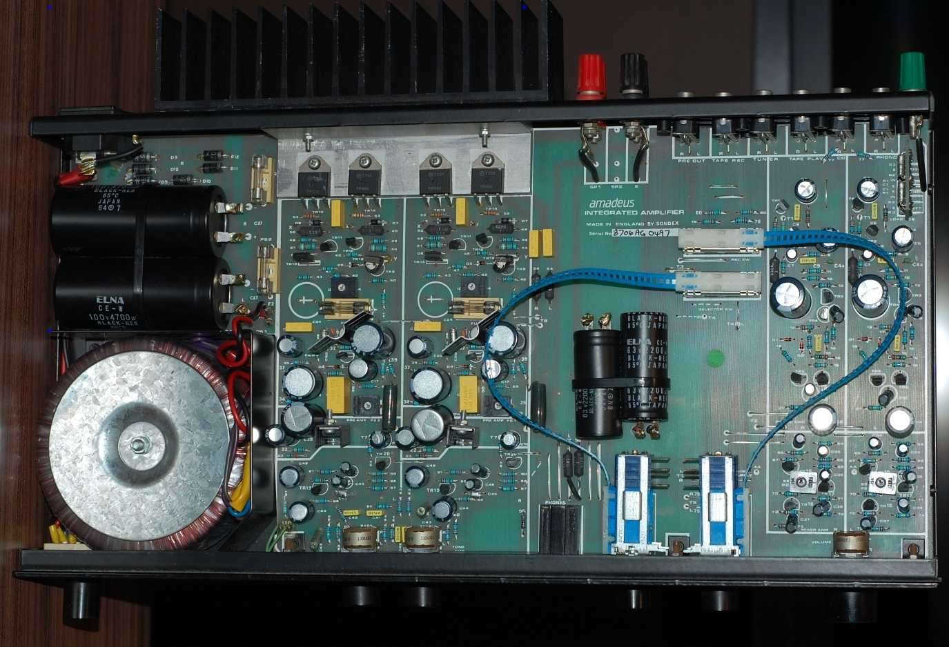

some years ago I purchased an Amadeus Gold designed and manufactured by sondex ltd in the uk. It was blown up at one of the childrens parties and got boxed in the workshop years ago for later repair. My grandaughter just had her 16th so I thought it fun to resurrect the amp her mum had blown up.
I am not an audiophile by any stretch but I think I can recognise quality. I do have very good practical skills and passable theoretical knowledge, although linear circuits have not previously been my main interest, I thought this would be fun to repair and I would benefit from learning. Maybe somebody would like to see the design, and maybe advise me as to how I might be able to set it up as the designer intended.
In the first Instance I will try to post a raw pic of the amp itself.

One thing that stands out in the picture of the amp is the (apparent) lack of thermal sensing of the output stage which in 99% of amps is a transistor in thermal contact with the heatsink, what is called the Vbe multiplier. Thermal stability and possibility of thermal runaway is a real danger.

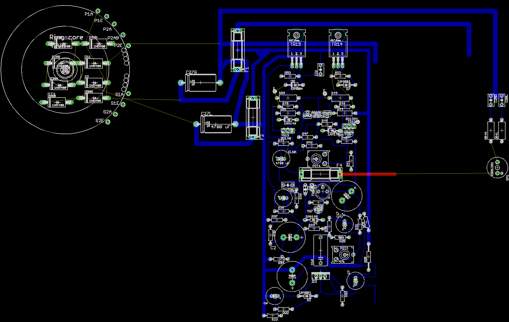

I have two silhouetted photo images taken of the front and back (mirrored) of the pcb which I used to copy the layout.
Thanks for explanation of the Vbe multiplier module, I replaced both BD140 with as best matching hfe as possible the BD139Y had a BC182 mated back to back, again I remounted balanced replacements taking care to mate the surfaces correctly, added a bit of thermal compound and rubber booted. I am assuming this might be the thermal protection module to which you referred.
cheers
I think I see what you refer to re the BD's and the BC182 in contact. Very unusual.

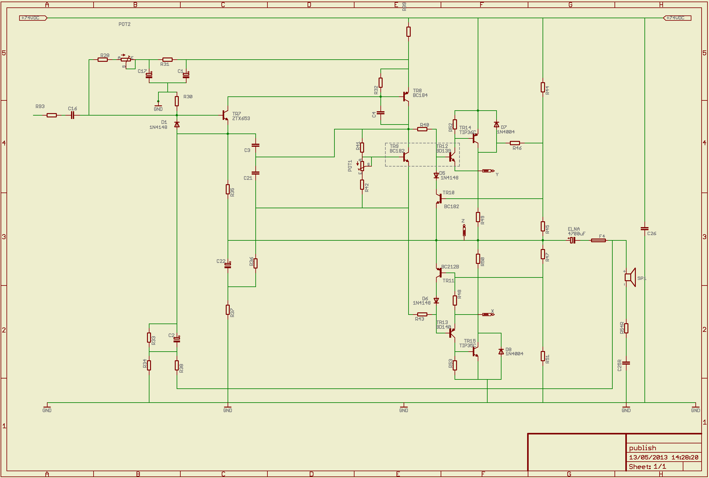

Hopefully this is partially readable, I am concerned that I do not seem to be able to get the file small enough to maintain readability, The reason all the components are well spaced is that I keep rearranging to try to make sense of the design..
anyway here is a possible interpretation of the power amp section.
also included specification from the original manual
cheers

problem solved.. the origin had accidentally been relocated. I also realised the schematic and layout are inconsistent so there is still quite a lot to do.
also I have just realised there are limited values in the schematic, hopefully for the moment they are obvious to experienced. Components in odd locations means I have not quite yet grasped their purpose.

The thermal sensing point is correct as the output stage is a CFP. The Vbe changes of the power devices is not important. I think you have the wrong part in the thermal sense, it should be the Vbe multiplier TR9. TR10 is output protection
The CFP stage will run at low bias current that's dependent on the value of R49/50, probably in the range of 8 to 12 milliamps. The other preset adjusts the output voltage to approx half the rail voltage to allow equal swing either way.

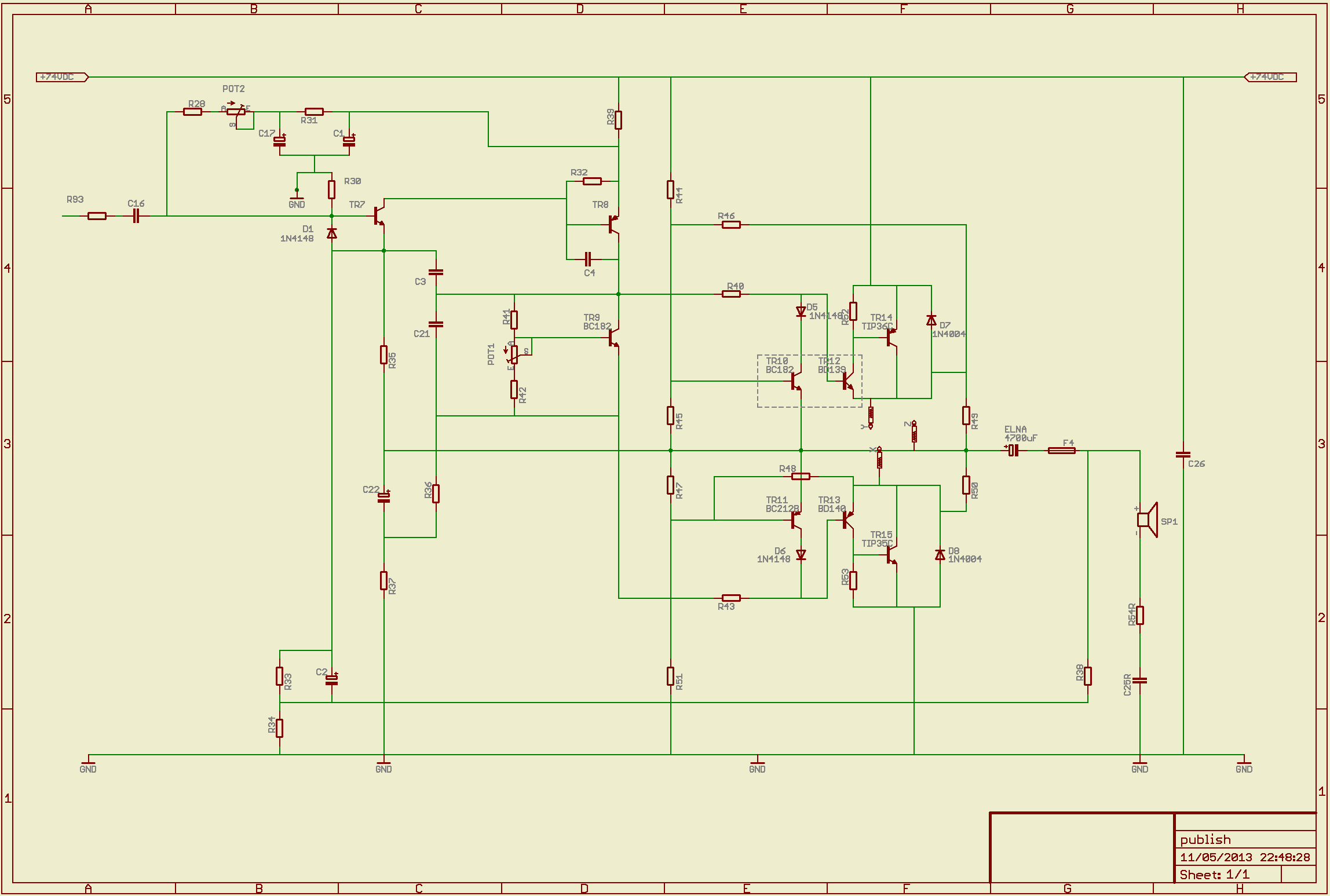

I would like to try and lay out the schematic in a form that shows groups as individual modules, output stage, bias, vbe, output protection, signal conditioning,
I have done some rearranging, but I now need to do some reading up. I know the schematic is a valid design, I know it is also made up from probably standard tried and tested modules, It is just a question of identifying which exact modules have been used in this design and arranging the components in the schema.

TR8 is known as the VAS or voltage amplifier stage.
R35 and R37 are the main "feedback" network and the ratio of these sets the voltage gain... in principle... without seeing the exact circuit and values there's some input from R36 and the smaller value caps (compensation).
Its a single ended input stage (good for sound quality because the distortion is predominantly even harmonic)
TR10 and 11 are the protection circuit and work by sensing volt drop across the low value output resistors. I don't think the circuitry is drawn quite correctly around there 🙂
The emitter of TR9 seems to be missing a resistive return to ground.
