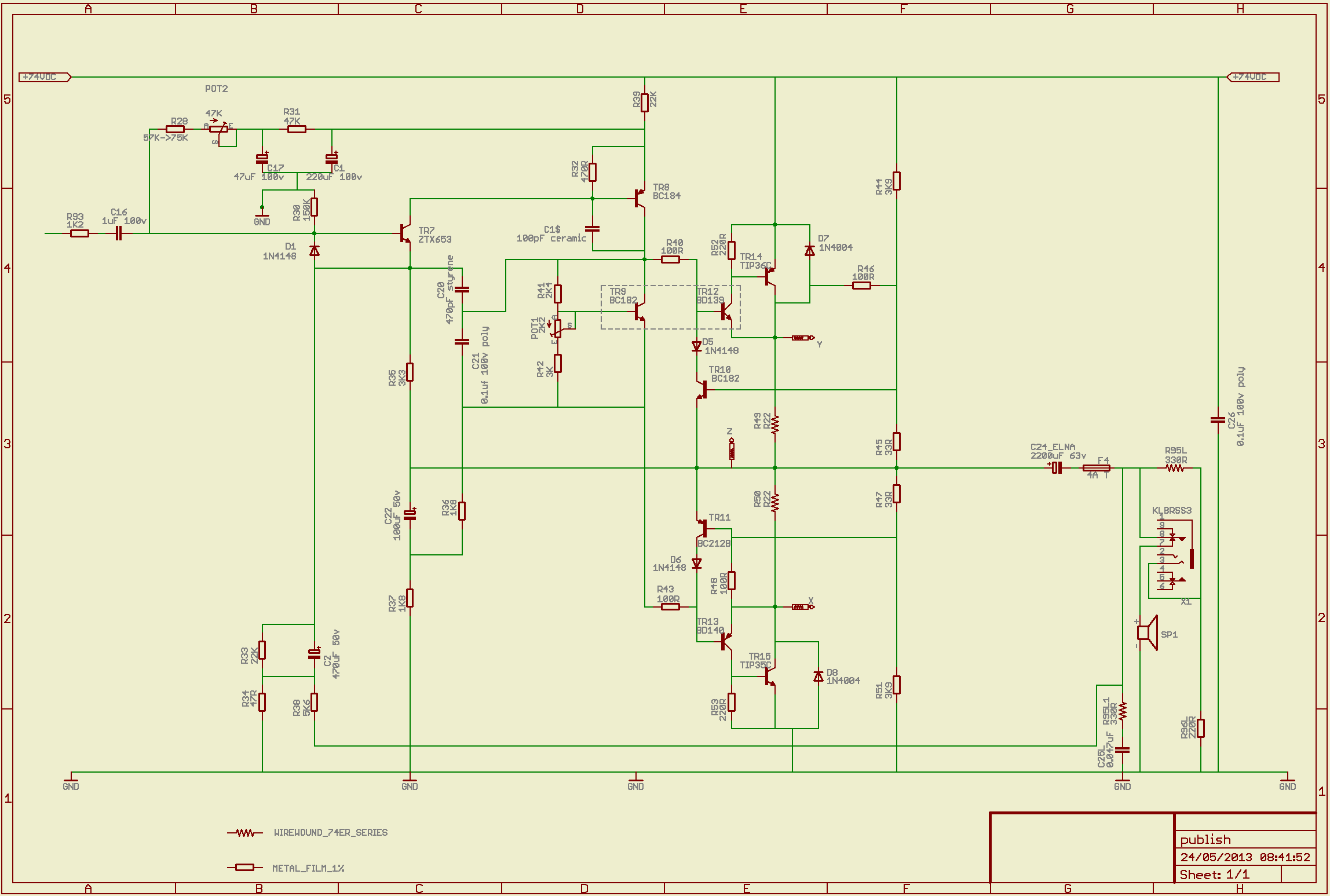

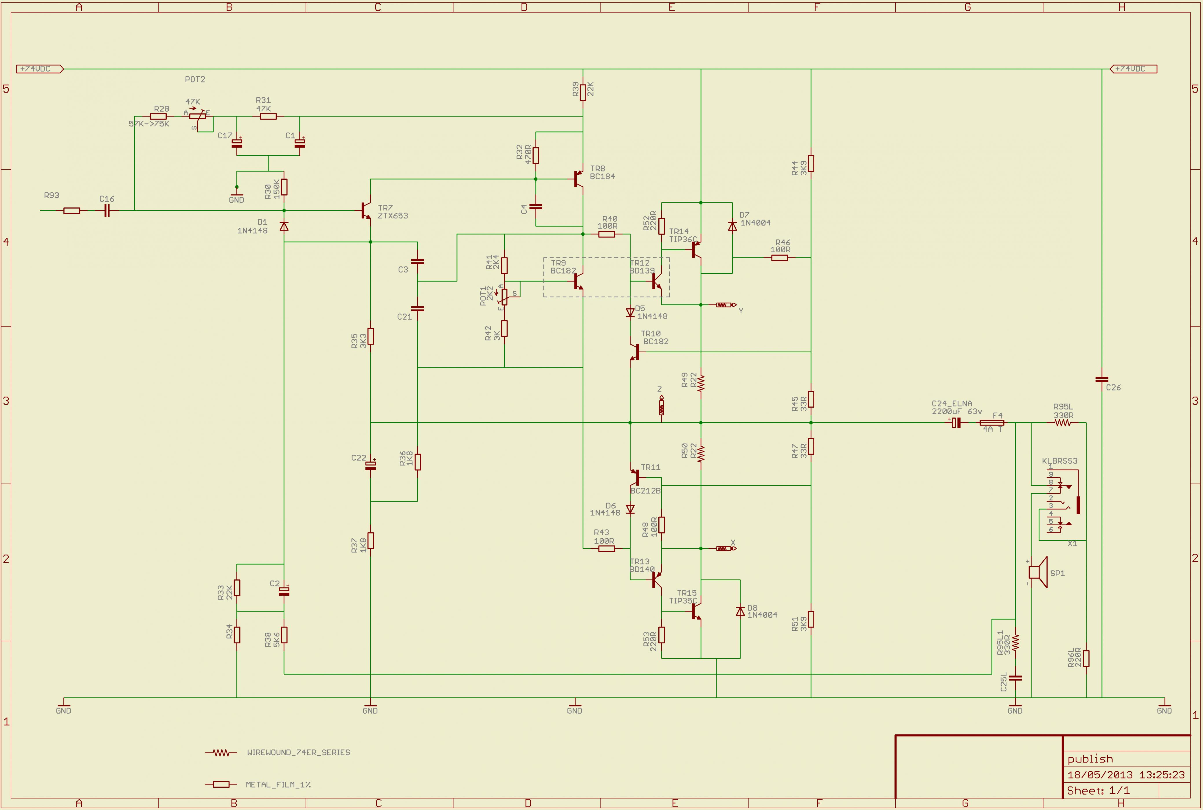

Reverse engineering a John Widgery Sondex/Radford SS amplifier.
hi,
I have decided the next task is for me to apply values to the discretes, I had already replaced a couple of resistors and undertaken a visual check and "tapped" the electrolytic tops (digital interference 🙂).
The lack if values is probably causing unnecessary hassle.
cheers for interest and help
I think there are some errors to pick up first. For example C25/R54, whatever the values, are not going to permit much output.
Perhaps this is a zobel network that attaches to the output node before the speaker or the 4,700uF cap.
Many thanks for taking a look. I regret that there maybe quite a few errors yet to come on my part.😱
I was lazy on the output interface section, but have now traced it correctly. There were a quite a few wirelinks on the pcb and some crossing over to achieve the correct channel orientation (L/R) on the headphone output. Also thought had gone into trying to reduce crosstalk etc by trying to keep signal paths at R_angles....
I have put some values in, this should also help me in marrying up the modules better. Am about to map the caps and add the tone control section.

Not sure what the ultimate goal is though 🙂
To be honest I think it has blurred a little, after repairing it I was hoping to set and restore this amp up as best I can, there is no schema so I have had to create one and also for me to learn something on the way.
I am sure there is some component fatigue, values drifting etc. I have some clipping on the negative sine at ~ 3/4 volume, I understood this to possible be uneven bias, but I was not altogether sure which components formed the bias.
I am also not sure where to set the settings of the preamp, is this on the knee? I also tried to establish the voltage that should be on the output terminals under different conditions.
I am half toying with the idea of taking an old design and updating with modern PCB technology maybe 4 or more layers and surface mounts etc etc. Every book seems to offer similar designs and not much seems to change over the years, Spice seems to be a path that is popular but is maybe only for minor tweaking and theoretical discussion. There are some transistors with increased bandwidth that are available now that were not when the amp was built, I am not sure that their performance in the audio sense are that much improved.
The pcb is single layer through hole laid out with letraset and I can "see" it is as noisy as notting hill carnival.
Maybe I can use modern pcb technology to offer a greater improvement to what could be a valid and currently acceptable amplifier design.
The clipping (assuming its not in the preamp... very unlikely) could be due to the output not being biased to the "mid point" or it could be the amp running out of current delivery on the negative half cycle. Or, the protection circuitry cutting in. All are easy to check. I would try it with a much higher load resistor or even non at all. If the bias is wrong the amp will still clip just the same. Are both channels the same ?
Thanks for advice, I will perform each stage in turn.

The 2200uF O/P capacitor is a clue that this is an 8 Ohm speaker design. Most modern speakers are 4 Ohm, so this amplifier must be used with the right load
the dummy load I use is a pair of 50w 8r2 mounted on a big heatsink and a pair of infinity rs2000 measured impedance of 6ohm at the workbench.
