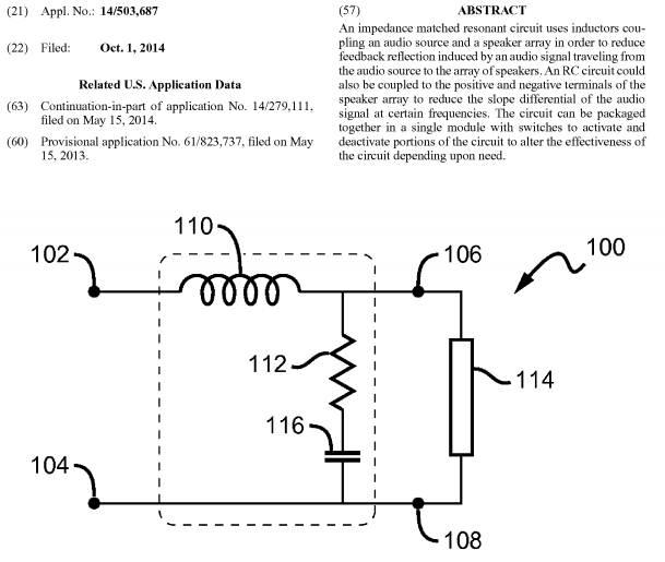

If the device is just the "very complicated" ( 🙂 ) filter shown in the patent, it shouldn't be too hard to just figure out the values for those few components, then a simple model would do all.
It's unclear what "patent" is involved- Steve says that they deny that it's the issued one and that this is based on a newer application which has somehow had claims allowed but hasn't been published.
Damn, that is frustrating. Why's it always got to be like this with these products? Just tell us the damn output impedance already. It's not like they'd even be directly revealing any "secrets" about the product itself...
It's not the REV33's output impedance that he wants. He wants to know what source impedance the REV33 was designed to work with.

And in my telephone discussion with Dennis Rauschmayer, he told me that patent was "for something else" and didn't cover the "core technology" of the REV33. Take that for what it's worth.

After a bit of back and forth, the answer given to me was 2.2 ohms. Just to set the record straight.😀

Still sounds like the picture, with the usual audio weasel words to make a simple filter seem profound.
Still don't see how the "distortions" they claim to address results in in their claim that "REV33 relieves the painful and disruptive effects of ear fatigue — ear-ringing, buzzing, hearing loss, headaches."

Except that they claim "The REV33 does not process or analyze the audio signal..."

Another way of saying that it is passive.
Nonsense. A passive circuit can most definitely process the audio signal.
Read this:
REV33 | A look inside the REV33
They claim they don't process the signal, but rather make your earbuds/headphones operate more linearly.
It's funny though. Among the headphones in their list are the Audeze LCD-2s, which are planars and present a purely resistive load. So it doesn't even qualify for 1 and 2.
