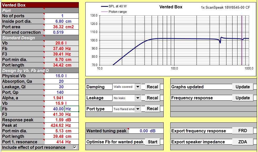

For some reason I can't actually find this design on Troel's site. There also seems to be a bit of a disparity between the official spec sheet and what others are measuring in terms of TS parameters for the woofer. Using AudioExcite's data for the ScanSpeak 18W/8545-00 (is this actually the correct driver?), Unibox comes up with 20L vented tuned to 37Hz and with an F3 of 37Hz too. Port diameter chosen is 6.8cm so the length ends up at 34cm. See Pic 1.

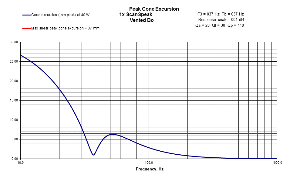

Pic 2 - What I do next is go back and forth between adding more Nominal Power to the driver (Speaker Design tab, up in the top left table) and looking at the driver's excursion (Vented Box tab) until it's as close to xmax as possible without exceeding it for the lowest frequencies the driver will likely see, maybe 30-40Hz for most musical content.

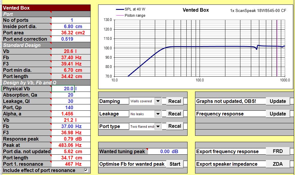

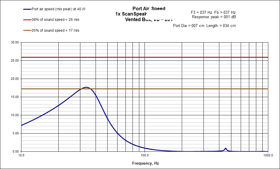

Pic 3 - Once that point is reached, in this case with 40W, you have the reasonable max SPL that the driver is going to produce at 1m, in this case about 102dB. And now this is where you are going to check to see that your port has a large enough diameter to avoid chuffing and other unwanted noises at this SPL. Staying under 8% is good. Staying closer to 5% is better. But if you think that you will never actually play the drivers this loud, you can drop the wattage and reduce the port speed and therefore get away with a smaller diameter port. Notice that when the port diameter is smaller, the port length needed is also reduced.

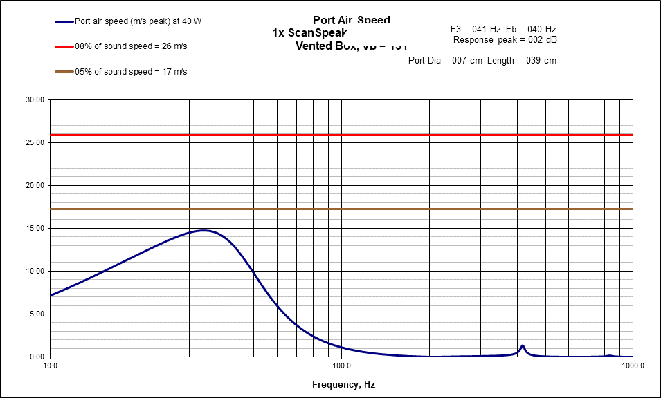

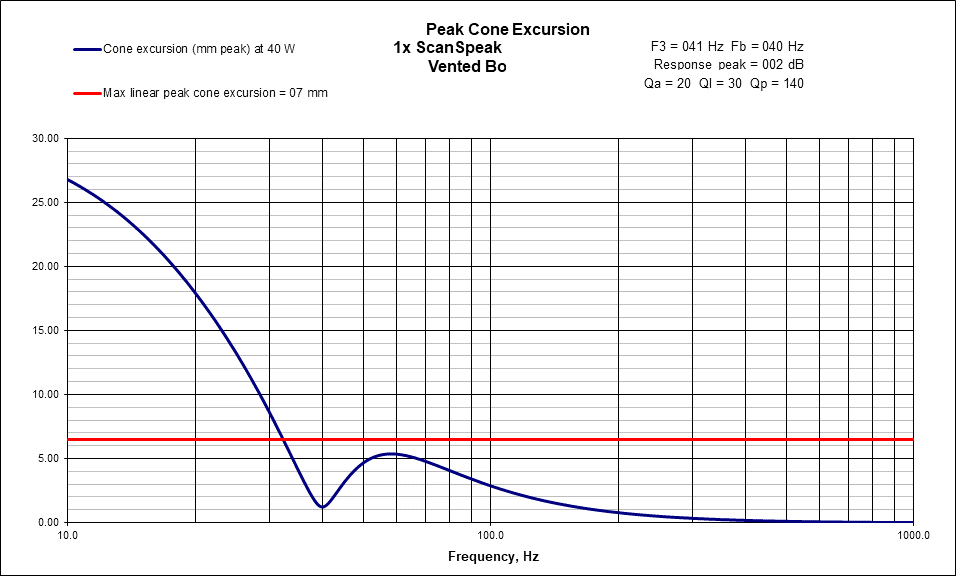

Just for educational purposes, the next 3 pics show what happens if you only have 15L to work with. A flat response is now achieved when Fb is at 40Hz, F3 is 41Hz and the port is now 6.8cm x 39.5cm. Notice that port speed has been reduced at the same SPL because the tuning is a little higher so it isn't being asked to do quite as much work. Conceivably, you could drop the port diameter a little bit here if you wanted to. And again, even a smaller diameter if you think your max SPL is going to be lower than 102dB at 1m.
