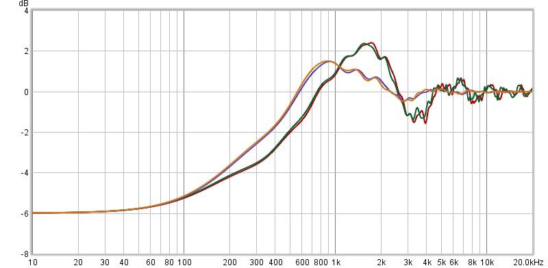

Thanks man!!! I think I can make use of the programs now by looking at your thorough screenshots. I honestly don't understand everything yet, but I start getting some of it, and get some results for the port 🙂
The most important thing for now, was to figure out that it is actually possible to get it working with the current port diam, so I dont have to order a new "port assembly" with the other parts.
You mentioned that I could consider lowering the tweeter resistance by 2 ohms to compensate for the listening angle. Is that something you would do? And what resistor would I lower then?
Troel has 2 resistors dropping the tweeter level - R1011 before the xo and R1071 after the xo. You could omit 1 or the other, listen and see which sounds best to you. Or if you assemble the resistors with .5ohm values (resistors in series add their values together), you have options to try just about any combination of alternatives.
I'll note that the resistors before and after the xo affect the FR in just very slightly different ways so removing 1 vs the other should actually sound a little different. But I think the differences are going to be very subtle with such small values so it would be interesting to see if you have a personal preference.
