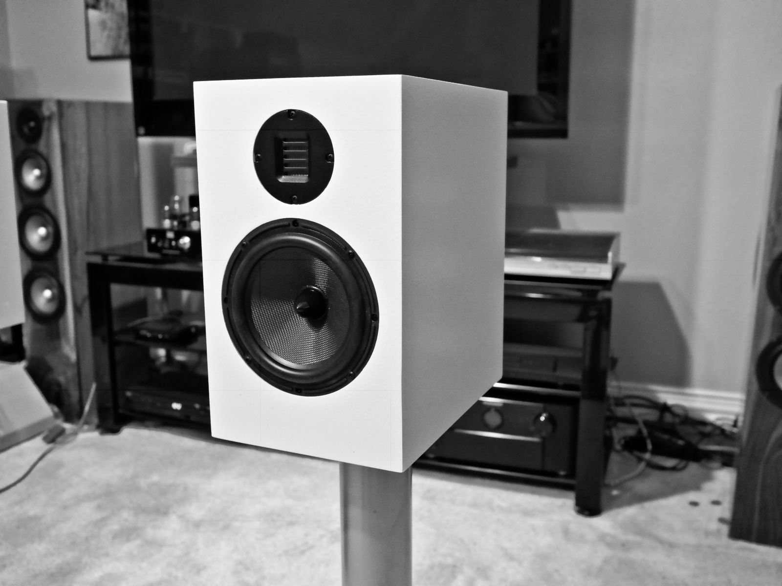

You could make Carmody's Spitfire but as a small tower with these flat pack cabinets:
Denovo Audio Knock-Down MDF 1.16 cu. ft. Tower Speaker Cabinet
Spitfire, Full Kit (Pair) SB Acoustics | Audax | Audyn | Accuton | Airborne | Aurum Cantus | Beston | Bohlenbder Graebener | CSS } Clarity | Cebo | Dayton | Eton | Eclipse | Fountek | Hi-Vi | Hiquphon |LPG | Lynk | Scan Speak | SEAS | Solen | Satori | Silver Flute | Tang Band | Transducer Labes | Tymphany | Vifa | Wavcor Meniscus Audio
Interesting solution. Though I have no space/tools for woodworking so cannot cut the holes to mount drivers. I would need to either find somewhere to have them cut locally or find a ready built or flat pack cabinet somehow.
I do really like the HiVi kevlar woofers. I haven't heard them but all reviews i've seen on builds with these have been positive.
I am leaning toward the The Swan/HiVi 3.1 (for ease of assembly and high quality drivers) or the TriTrix MTM Transmission Line Kit (as the tranmission line design is intriguing on top of a MTM configuration). I know, I know, both kits use MDF. Not an ideal cabinet material but both designs have excellent bracing, which should cancel out the negatives to a large degree.
Of course i'm open to reviewing other kit solutions that might be here or elsewhere!
The Swan/HiVi 3.1...I know, I know, both kits use MDF. Not an ideal cabinet material but both designs have excellent bracing, which should cancel out the negatives to a large degree.
Where are the box plans? The tower is not well-braced, as they run in the wrong direction. And the tower will be an ML-TL not a BR so the horizontal braces constrict the line.
Bracing Guideline 1: Braces should create subpanels with higher aspect ratio than the panel they are bracing
Guideline 2: Subpanels should have differeing aspect ratios.
Contact Bob Berner, i am pretty sure he would be interested in looking at doing a proper plywood flat-pak.
