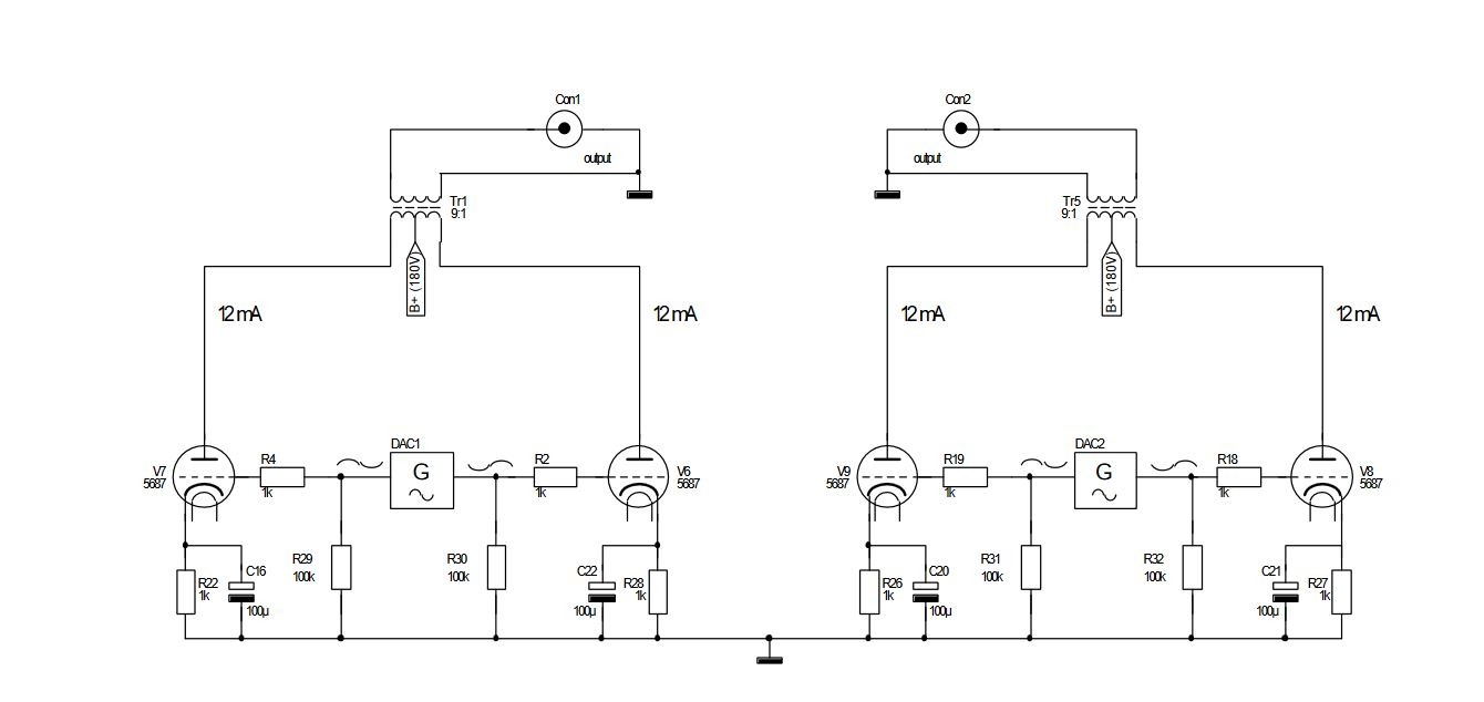

Marcel, a slight change of plan; because I have more of the parts available I propose implementing the version of the 'CD Enhancer' circuit shown below (except I will use 6SN7 tubes instead of 5687s) - it's a little different to the 3A5 version with respect to the cathode to ground arrangement - thoughts?

Compared to the earlier circuit, the 1800 pF filter capacitors are missing. I think you will need them, possibly with a grid stopper after them if needed for stability.Marcel, a slight change of plan; because I have more of the parts available I propose implementing the version of the 'CD Enhancer' circuit shown below (except I will use 6SN7 tubes instead of 5687s) - it's a little different to the 3A5 version with respect to the cathode to ground arrangement - thoughts?
The voltage drop across the 1 kohm cathode resistors at the indicated current of 12 mA would be 12 V, but according to http://www.r-type.org/pdfs/5687.pdf , a triode from a 5687 needs about -8 V grid voltage for 12 mA anode current at 168 V anode-cathode voltage. That is, either the circuit expects a 4 V common-mode voltage or the current will be a bit less than indicated. I expect it will be about 10 mA with the 1.25 V output common-mode voltage of my DAC. That shouldn't make much of a difference.
Edit: sorry, about 6 mA, as you use 6SN7, http://www.r-type.org/pdfs/6sn7gt-2.pdf
