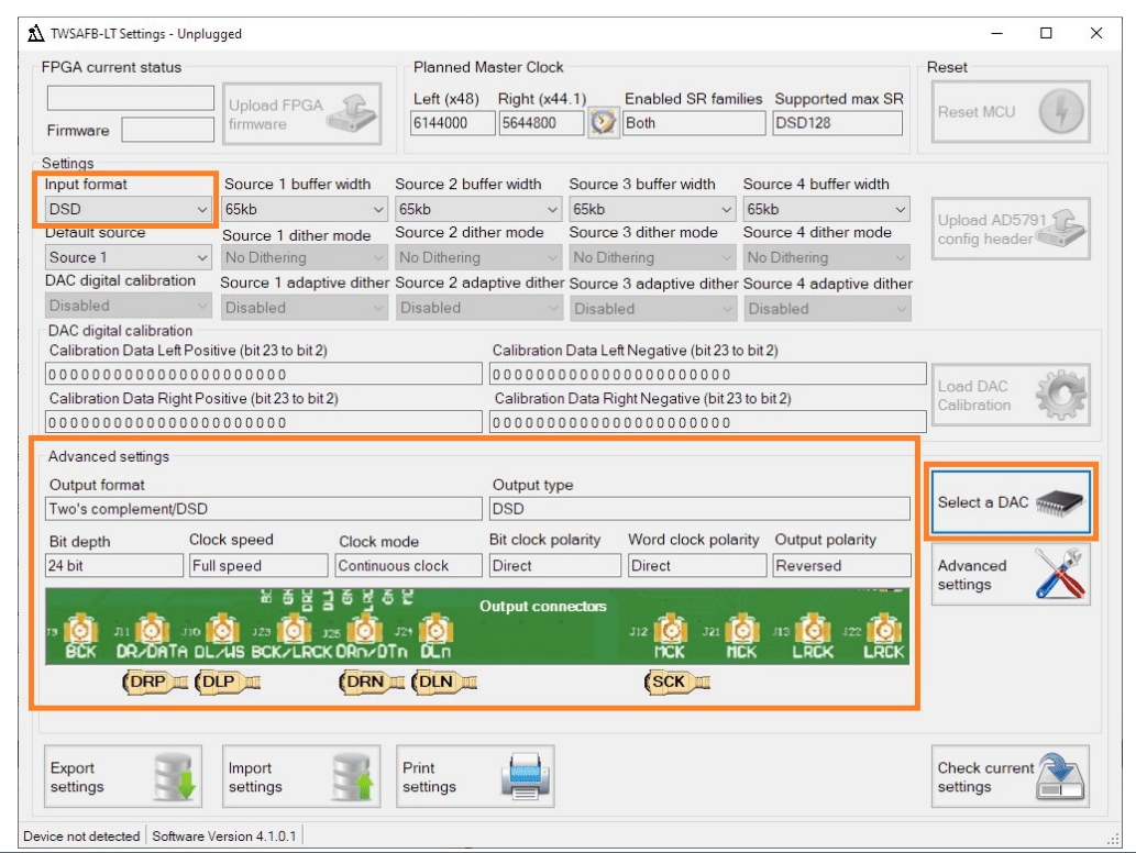

When the FIFO board firmware is configured for RTZ mode, then the BLCK output of the FIFO board is automatically doubled.
The firmware config app kind of looks like this, depending on the mode (without the orange boxes, that is):
It seems Andrea's day job is as a software consultant. He has produced a versatile set of capabilities for the FIFO board and its ability to support a variety of dac types and operational modes.

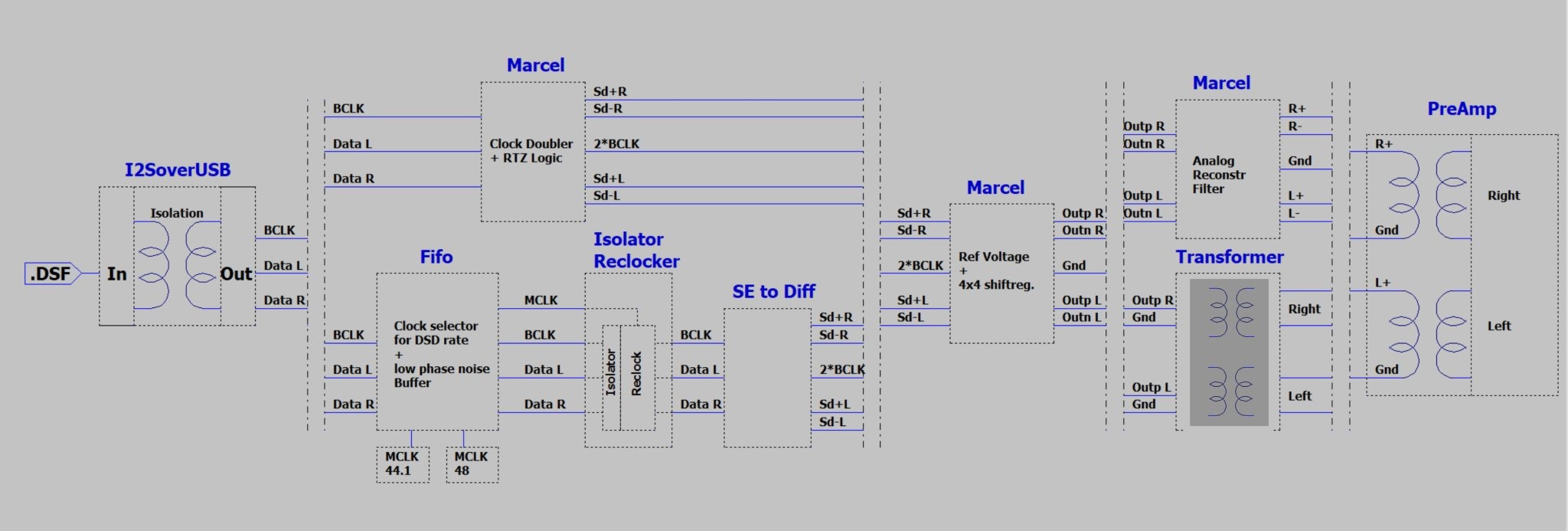

I can still go into more detail when you prefer, like adding power supplies, shielding and details about your transformer circuitry at the Firdac’s output.
To me, by making this diagram, many pieces of the puzzle fell into its place.
A picture tells sometimes more than a thousand words.
I’m still interested in more detail from the Fifo, maybe the picture can help.
The two other Andrea’s boards are no longer a secret, and all of Marcel’s circuits are perfectly documented.
And the suggestion that Andreas Firdac works on a fixed frequency is also worth checking for better understanding when comparing things.
Hans
