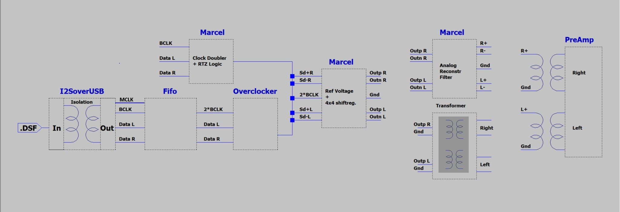

I2SoverUSB -> Simple DSD Converter -> Andrea FIFO Buffer -> Andrea I2S Reclocker board -> Andrea I2S SE to Differential board -> Marcel dac shift register digital inputs -> Marcel dac board SE analog outputs -> Passive filtering -> line amp w/volume control -> power amps -> Speakers
Also, Marcel dac pre-shift register digital circuitry has been disconnected from shift register digital inputs.
Mark,
Of course Marcel’s clock doubler and RTZ logic is not in parallel with Andea’s overclocker board it’s one or the other, I could have placed a switch but thought this was obvious.
But I will add the switches.
The Overclocker also has the differential outputs as can be seen in the diagram, this is one and the same board, true ?
So I think it’s pretty complete, agree ?
Hans
Hans

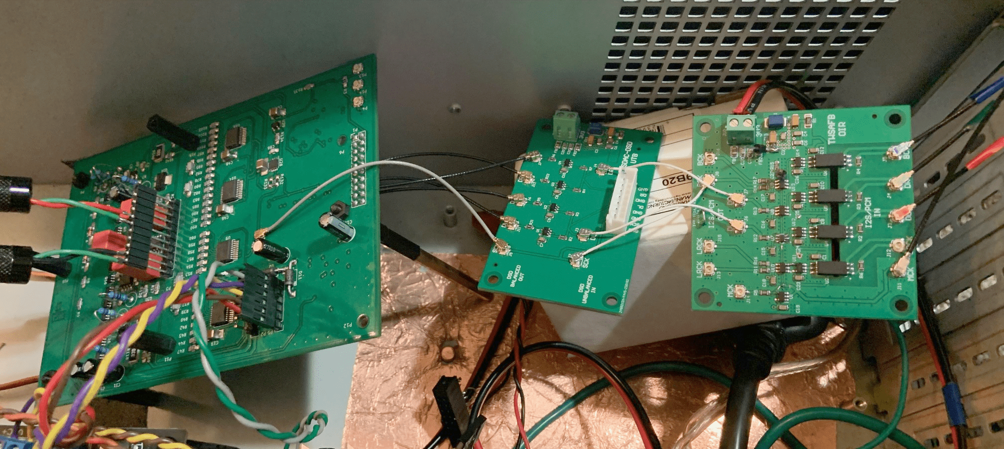

It looks like this with an isolator/reclocker board and then a SE to differential board:
EDIT: the only difference from the pic above is that the shift register bypass caps were changed as an experiment to see how much it might affect the sound. Turns out it affected the sound quite a bit for the better, but its still not perfect.
Also, the film caps sound went through some changes during the first few/several hours of use. At first they were kind of interesting as I previously described. Then they got kind of muffled and dynamically flat for awhile. Now they are probably pretty much settled in. The sound right now is brighter, less full and warm in the midrange, still pretty good imaging, and dynamics are better than they were. Remaining problem is there is still a little bit of unpleasant HF grunge to the sound. Could be better filtering would help that. Could also be an issue with the Vref power supply, and or with particular choice of shift register devices and output resistor types. Could be its all of those things. IMHO and IME its very hard to perfect everything to the point where you can compete with the best commercial dacs. They have been working on perfecting their stuff for a long time, some of them have anyway.

O.k. So instead of one board there are two boards.Hans,
That’s one of the reasons I made this diagram to better understand what you are doing.
It means that the Fifo board is not in the picture.
I will change the diagram accordingly.
Hans

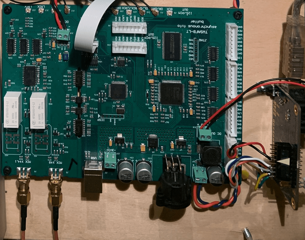

FIFO board and USB board are behind separate shielding. They look like:
Big board with all the connectors and chips is the FIFO board.
USB board (sans Simple DSD Converter in this pic) is shown partially on the lower right.
Clock inputs to FIFO board come in through connectors on the lower left.
Clocks at the moment are Acko Labs AKX-22.
