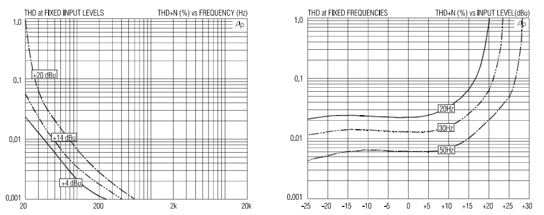

A quick note on their (Jensen / Cinemag) transformers, the line OP traffos have up to 10 x lower LF distortion when driven appropriately from a very low Z source.Unless it is an insanely big permalloy core monster like the WE111C repeater coil or bigger (we are talking transformers that push a kilogram or more (WE111C is 4.5 lbs) you have an issue with that.
Level vs frequency and distortion for an extremely respectable line input transformer (10k:10k)
from:
Jensen JT-11P-1 Transformer Data
As we see, as little as +4dBu / 1.23V input voltage exceeds 0.001% THD or -100dB below 250Hz, which is the music's foundation. Due to the underlying mechanics this HD will be H3 and odd order.
HD goes up pretty linear level for any given frequency.
So for +10dBu (2.46V) distortion will double for a given frequency.
A lot more details on all this can be found here:
https://www.onallbands.com/wp-content/uploads/2019/08/Non-LinearXformerBehavior.pdf

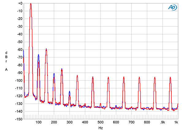

I don't particularly like to comment on others products, but here an illustration what a not so well implemented transformer in voltage mode output on a DAC does:
https://www.stereophile.com/content/ps-audio-perfectwave-directstream-da-processor-measurements

Thor's suggested inductors and biasing does not seem to work well in practice:
https://www.stereophile.com/images/119iDSDfig15.jpg
https://www.stereophile.com/content/ifi-audio-pro-idsd-da-processorheadphone-amplifier-measurements
It works very well. The Unit measured in SP had a firmware that escape (I did not test it or greenlight it) and as all the settings (tube or J-Fet input, amounts of NFB are under software control.
For example, the system was always operating in "inner loop feedback" that is the input stage is excluded from the NFB Loop.
That said, the analogue stage is not designed with huge amounts.of NFB and the DAC Chip in use has its own relatively high HD, which inductors however exceeded.
