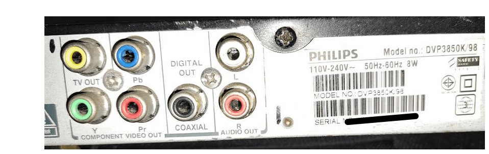

I have DVD player I used to listen to CDs on, I can check on that, however, a DVD drive can produced good sound from audio CDs as far as I know.
The model is Philips DVP3850
https://alatest.com/reviews/dvd-player-reviews/philips-dvp3850/po3-143774543,32/

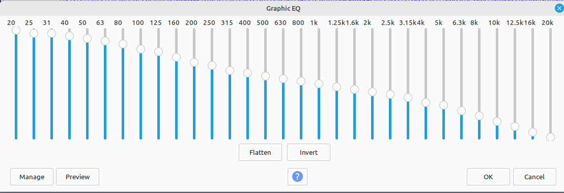

The RIAA curve is given is one of the EQ setting templates in Audacity.
This raises the question: is software RIAA equalization possible? What would happen if a direct phono out is recorded digitally, to FLAC, and then the RIAA is applied through software? My guess is that the noise floor would be high, is that correct? Maybe not. There is this 'Pure Vinyl' software I came across:
This is not the correct way to apply RIAA in software.
It's not just possbile, it is done that way by some audio archivists.
They use flat phono preamps, this out goes to an ADC and then the RIAA correction is done in software.
