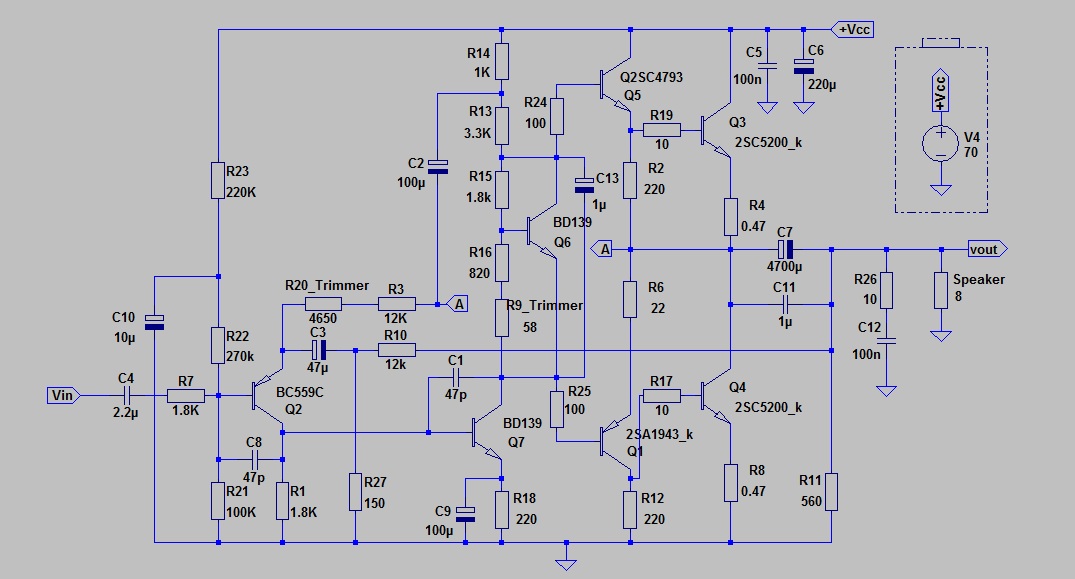

yes .i have a new pcb made with the provision of adding base stopper resistors on drivers and output transistors or just jumpers if not used,but i dont know what values to choose.
are 68 ohm for drivers (2sc4793-2sa1837) and 4.7ohm for output(2sc5200) enough? how are the values choosen?

soon i am going to finish this amp and i would like your comments. are C1 , C3 values enough?

Interesting maouna. Is C1 miller effect compensation? When dynaco put something like that on their ST120 in the "TIP mod" (see greg dunn's site) I thought it was for preventing oscillation. I've put a 50 pf on per dynaco, seems to work fine. At least they may have been 50 pf. they were R**** S**** grab bag caps, red black brown, looked to be two curls of wire glued to the end of a 1 cm cardboard tube.
C3 I guess is the feedback cap.
R9 could be fine but if the wiper lifts could cause an output stage bias runaway. Better to put a trimpot parallel to R16, with wiper shorted to one end, then if the wiper loses contact the bias goes high but not infinite.

This amp looks nice, can we have the PCB mirror image, and dimensions?
And capacitor below 2SD1837 is not connected, I suppose it must be connected to base pin of transistor below?
Can this amp work with TIP3055 as output?

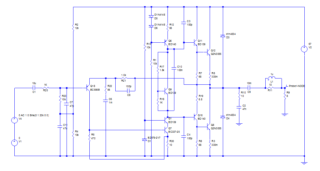

You might also consider PSRR. These old amps with a single supply have everything refered to the 0V rail. The + rail is protected by the bootstrap. As a result, coupled with the current amp config, I am not sure they don't work better than 'modern' direct coupled designs. The Armstrong 621 circuit is my favourite. A bit more complex but with better performance.
That Miller capacitor again!
If you use a current source in the VAS, and inclusive Miller feedback the crossover distortion can be reduced significantly. The input bias circuit tends in my experience to cause low frequency noise (depending on the source impedance) and a better solution is to use a divider circuit across the supply, tapped at the mid point, decoupled with a medium capacitor and a 10k resistor taken from there to the base.
A Baxandall diode may not be needed with a current source and the emitter resistor of the pnp driver could be 6.8 ohms without a diode bias.
I wouldn't recommend 2N3773's. Modern versions MAY be epi-base but the spec. hasn't changed - fT could be 200kHz. Yuk! Epi 3055's have fT's around 3 MHz- OK for basic amps.
The best bet for single ended input transistors is to use inclusive feedback (see Bailey's 1968 complementary amp in Wireless World) where the feedback capacitor of about 220pF is taken from the collector of the VAS to the emitter of the pnp input. This may be unstable with a high frequency BC556 in the input (Bailey used a 40361 but that has a lower fT) which can be fixed with a small capacitor (~100pF) between base and ground to keep the impedance low at high frequencies.
