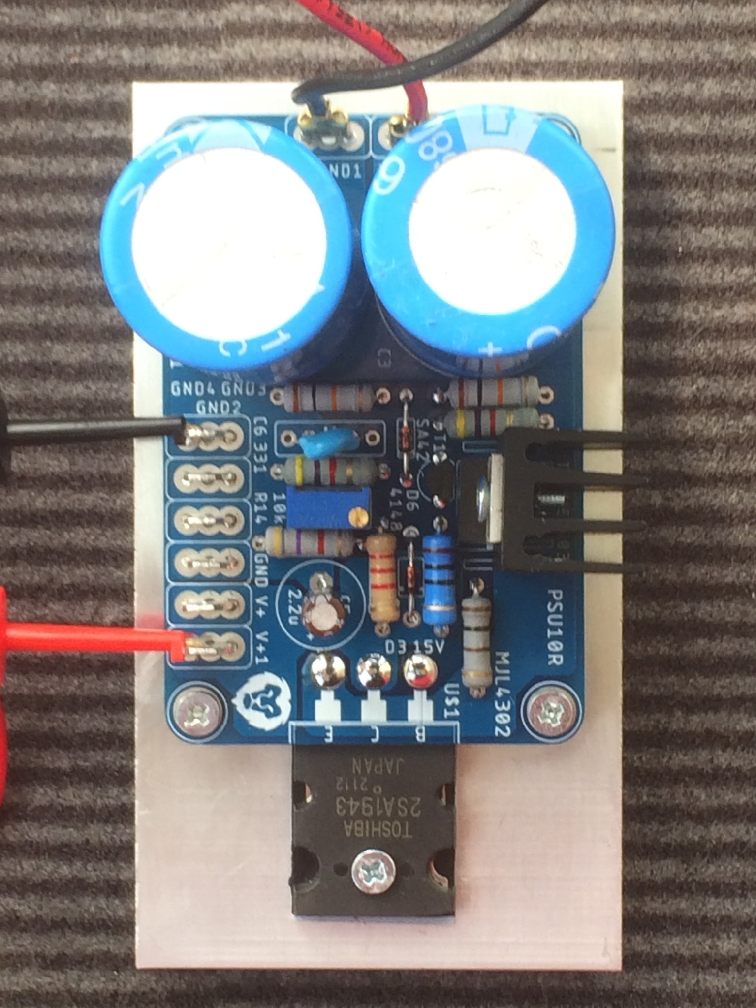

Hi Prasi,For the compact crc, if you plan on using it on high power, best to use chassis mount rectifiers and connect it to pcb via wires.
PSU 10R , I will ditch them and use on-semi to-264.
PS: I seem to have the exact layout. 🙂

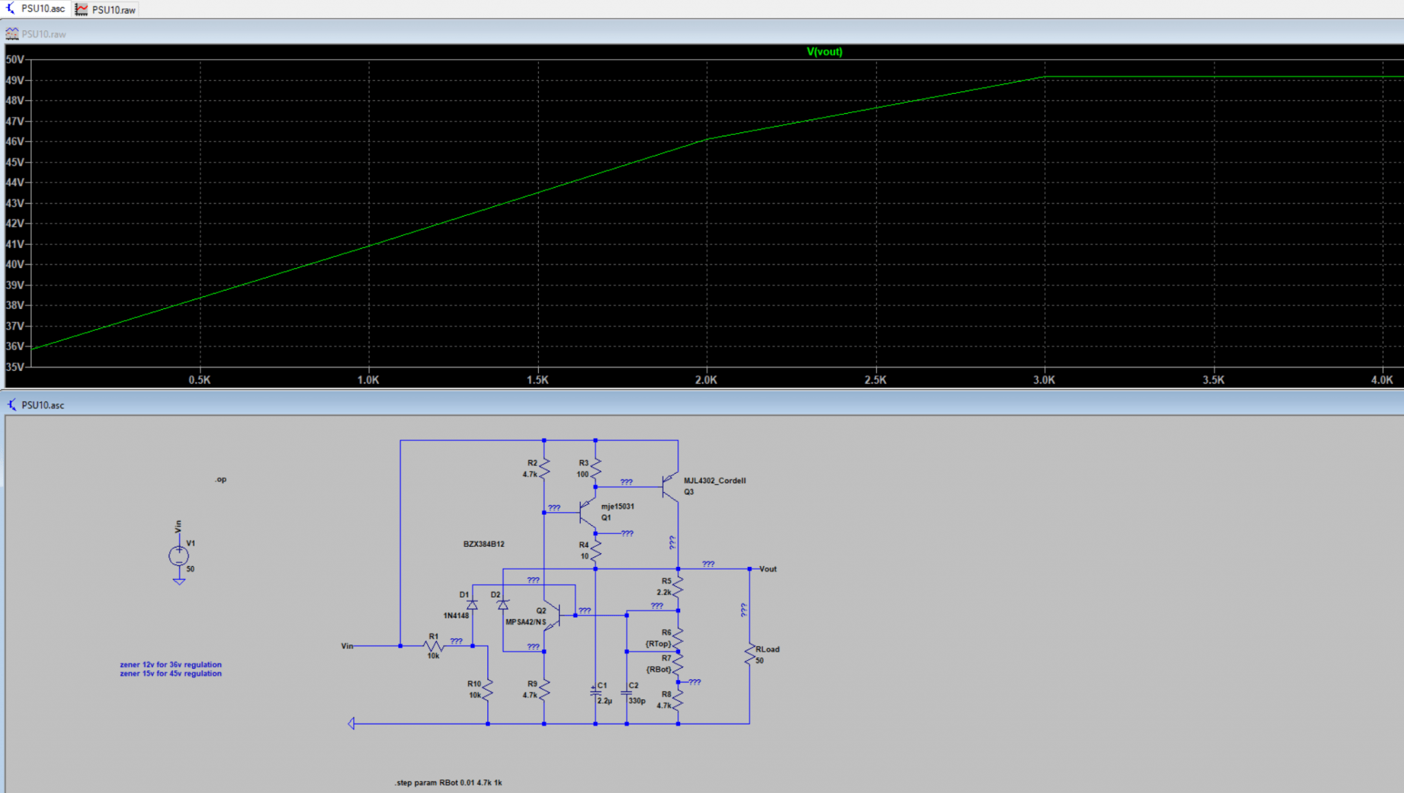

I assembled a PSU10R for a project. However, it doesn't work. The input voltage is output as it is. Where am I doing wrong? The multi-turn pot does not respond.
What is your input voltage?
Regulation will start around 45v input. If you need lower, change zener from 15v to 12v and regulation starts around 36v input.

You need to use a smaller trimmer for those values. The regulation for 50v and 12v zener occurs during R= 0 to 3k:
Hi AvtechYou need to use a smaller trimmer for those values. The regulation for 50v and 12v zener occurs during R= 0 to 3k:
I have a 5k trimpot. I tried it and it worked. I can adjust between +35v dc and 50v dc. What changes should I make to go below 35v dc.
A 9.1v zener with 5k gives 29v-46v regulation.
R9, R8 and R4 (on my sim) need to be 1/2w components. R9 in particular goes to ~320mW when the pot is at max and 12v zener is used, ~290mW with 9.1v zener. 1/4w just won't cut it for that position.
Power dissipation of the semis seems to be well within their tolerance, but as always experiment with component changes at your own risk.
